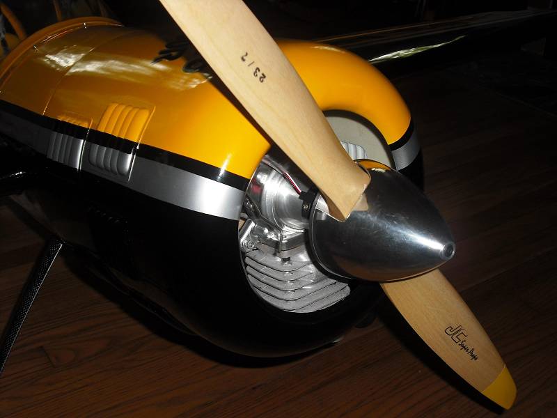

Sounds like it puts out more power than my ccrc50. I get 6900 rpm on zinger 22x8 in 17.5# bird it will pull vertical 180 to invert on take off. The first ignition module failed after 10 min of running. I think it was one of the problem ones. I now run the 2nd module on 2400 nimh 4.8 packs and after about 30 min of running the bat's still show 1700 ma remaining. So a full hr of flying on one charge is possible. The nimh do not pose any issues with high current draw on this motor.
I have about 2 hrs run time on mine now. The 20x10 prop turned about 7800 rpm and given Jody's input I put the larger prop to bring the rpm down.

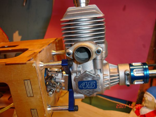

Hi!
The MVVS 45cc (Evolution in the US) turns a 24x8 Mentz wooden prop at around 6600 rpm using the small MVVS cannister silencer (No 3206) and 95 okt fuel and 2,5% syntetic oil . 22x8 props on this engine is just too small. Rews too much.
Have you tried a 24x8 Mentz on the CRRC Pro???

I think with some run time and a pipe this engine would turn a 24 X 8 very well.
As far as giving an actual rpm number, I wouldn't know unless I tried one.

MVVS 45 is an incredible machine but the Menz prop is a little less load than JXF / Xoar props, and generate a little less thrust compared to JXF / Xoar. Still its a 45cc and can easily cope with 50cc engines on the market!
I wish the new CRRC50 had standart prop guide (4 screws) and an option of straight muffler for those who want it that way. DL50 is going for 315-319 USD, CRRC should go no more than 350 with a nice pitts muffler IMO.

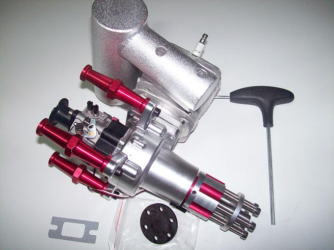

I got today one unit of first production batch.
Prop hub comes anodized in red, not blue as first prototypes.
Velocity stack is made of plastic (as others CRRCpro engines).
I'm impressed with quality and well machined engine.

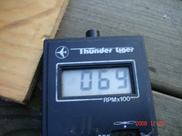

Did some more rpm test today.
Again, absolutely no needle change from first prop test session and no changes in between props.
I started of with the JFX 23 X 8 that I ran in the first session to see if everything was the same and matched the first sessions rpm's.
The JFX 23 X 8 turned 6880 rpm. ( same range as first test ).
Hawk 22 X 8 ( absolutely screamed ).... 7560 rpm.
Hawk 22 X 10.................................... 6630 rpm.
Hawk 23 X 8 ..................................... 6680 rpm.
Xoar 24-3DA ..................................... 6630 rpm.
Xoar 24 X 10 ..................................... 5680 rpm. ( too much load, but I had it to test so I did ).
I have a Goldberg Extra 330 that is going to be the test bed for this engine in the air.
I am all most finished with it.
I really would like to try a Mejzlik 23 X 8 and a Xoar 23-3DA on this engine.
To me it seems like the 23" will be the ticket, even thought that Xoar 24-3DA's numbers impressed me.
I will do some actual pull test with a scale with each prop as soon as the airframe is ready.

The plane is in need of some repair, so While it is being done I figured I would break the engine down and see what CRRC has under the hood.
Here are some pictures.

Great machining and clean. looks like a very well made engine.The chinese are catching up fast.Only thing is they're all clones of the DL50 which is very similar to the venerable DA50- the progenitor of all clones!!

OK, guys.
Sorry it has been a while.
There was a production issue, and that is what all of this prototype testing is all about.
The first batch of GP50R's had an engine case that was made of too soft of an aluminum.
CRRC was notified about the issue and promptly worked on fixing the problem.
They CNCed new engine cases out of hardened aluminum and sent it out.
I also went for a new plane for the engine.
I went with a RC league Yak.
Everything is complete and now ready for a maiden.
Engine is all back together, re timed and is running great.
It is down some rpm from my 1st testing ( old engine case ), but the lower end is all new ( bearings and seal ) and the outside temp went from 40 degrees and no humidity to 82 degrees and 81% humidity.
My 1st run of the reworked engine is 250 rpm lower then befor with the same prop, but like I said i believe newness and weather are the factors.
JC 23 X 7 super props @ 7200 with a stock DL muffler.
Here is a few shots of the new plane and tomorrow night when I maiden I will post some video.
