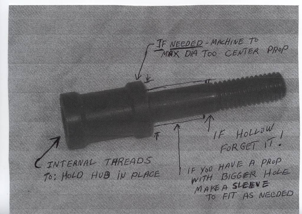

After studying this photo this is my thought. The part seen that screws on end of crank is only meant to center the prop (not hold it in any way) and to provide a way to attach a spinner. The real strength holding the prop is the hub that fits direct on end of crank combined with the 4 smaller bolts holding prop against prop hub. I think any not well planed use of a threaded stud to hold prop on may be dangerous. But I do not know that for sure![X(][] Capt,n

Your getting the idea, except that the pilot shaft also holds the hub onto the crankshaft. Yes an ill planned center stud to retain the prop would be dangerous, as would be your idea to turn down the large end of the CRRC propshaft to 10mm to center the prop. There is already an 8mm hole inside that section of the propshaft, turning it down to 10mm OD would only leave a thickness of 1mm left, not enough for me. It would be much better to shorten the large end of the CRRC prop shaft and face it off 90 degrees to its length then use a bushing on each side of the prop to center it.
Frankly, the 4 bolts are better for centering the prop than a center stud woud be and are not that big of a deal. I made my own drill guide on my drill press by drilling the DLE30 prop bolt patern in between the holes of the DLE55 pattern on my PSP Mfg. drill guide.

I have read oak dowles make good stand-off for some aplications. If you can ...post some photos of the stand-offs you are using. Thanks Capt,n[X(]
ORIGINAL: jedijody
Most any diameter will work. On the DLE30 though, the mounting lug at the bottom of the crankcase, next to the carb will only take a smaller diameter one like the ones that are included with the engine, slight clearance issue with the rear crankcase cover. If you get stand offs meant to use a 5mm or a #10 bolt and it interferes with the rear cover one could easily be modified for proper clearance.

Sure, the picture is of a CRRC 26cc prop shaft that may be able to be adapted or you could turn one out on a lathe that may be better suited. The CRRC propshaft is only 8mm and has a 4mm spinner bolt hole in the end, most props of the size that fit the DLE30 have a 10mm hole already drilled in the center and the more common spinner bolt size is 5mm but I think it could work, it'll screw right on the DLE crankshaft but the big end is a little to long.
ORIGINAL: captinjohn
Do you see a way of replacing the pilot shaft with one that is not hollow? Capt,n
ORIGINAL: jedijody
Capt'n,
The crankshaft threads are 8mm x 1.0. I might be tempted to cut threads into the pilot shaft itself but it's hollow and I wouldn't trust it.
Capt'n,
