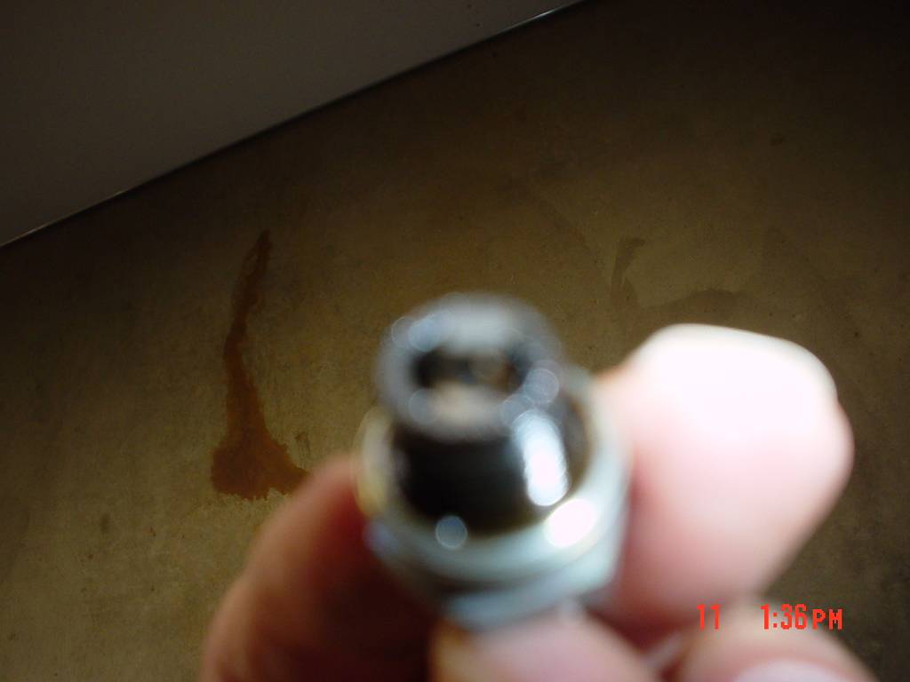

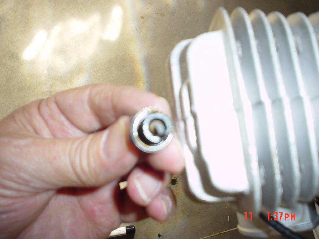

Default RE: DL100
I pulled the plugs today and the left plug is wet and black and the right plug is brown and dry. I have attached pic but not sure they show the difference. I assume the wet plug is running cooler and hope someone can tell me why. The pic with the cyclinder is the left plug.

Default RE: DL100
Rotational influences from the crankshaft always cause more fuel to get pumped into one cylinder than the other on twins with shared crankcases, as with the DL, it's the front cylinder. The pictures of the plugs are not very clear but the front cylinder will always look a littlle richer than the rear one. Because of the richer running and slightly cooler temps, that cylinder takes a little longer to seat rings as well.

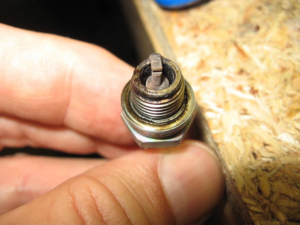

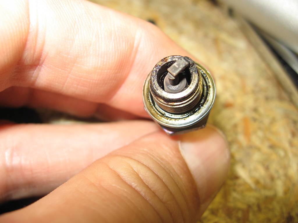

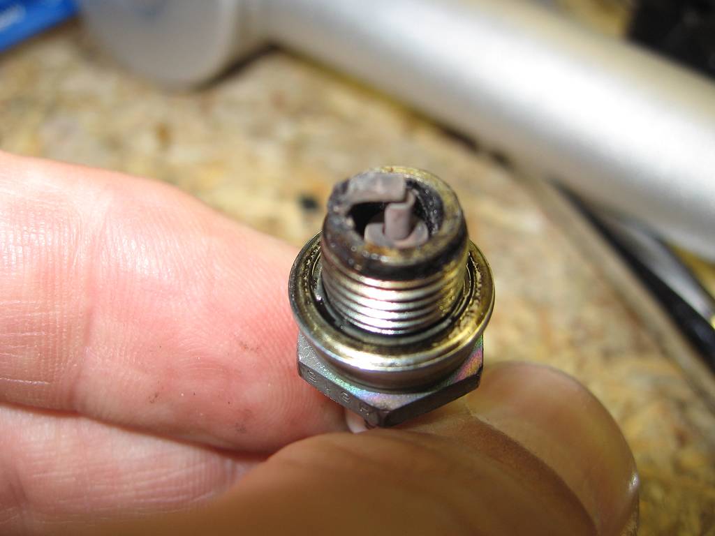

You have to hold the plug really still when you take those pic's or they turn out blurry like that. You could use a mini tripod and let the timer take the pic. I just set the plug down somewhere...put my camera on manual focus...and dial the focus as close as possible. You can get some good close-up pic's but they take a little effort.
Here's three different pic's of the same plug. I think it was my DLE-55. The first one was the clearest. The lighting and shot angle can effect the color that the plug looks. That middle one's a little blury. To the human eye this plug had a beautiful light chocolate color to it. The engine was running t!ts.
