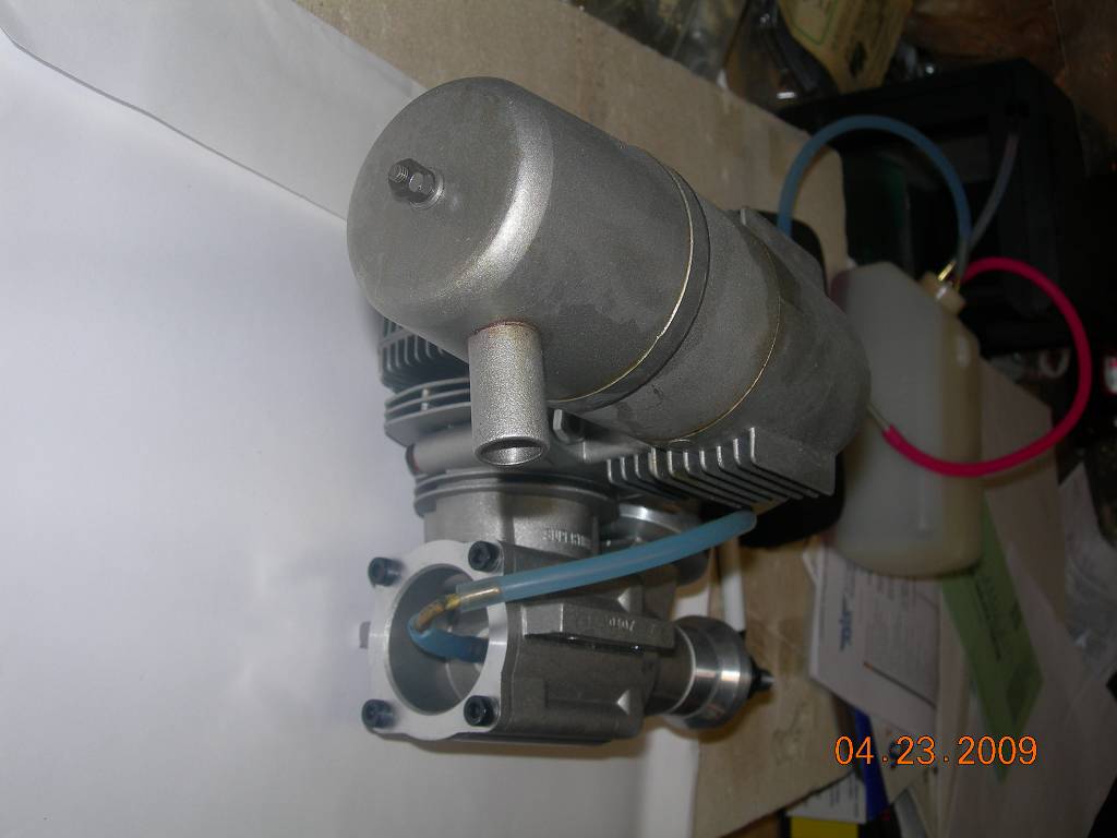

G23 glow engines run very well using a Walbro WT499 gas carb...The fuel passages are large enough to pass the extra methanol required...
A stock G26 with spark ignition using a stock WT499 Walbro runs and adjusts EXACTLY like the gas version, but 600 rpm faster..Been doing it for years...

ORIGINAL: Antique
Think maybe if the OS gasser needed exhaust pressure for the Walbro to work they might have included a muffler to get the pressure FROM ?
also I have run Walbro on methonal - on competition engine
Frankly don't care for it
Walbros were jetted for gas /air use -
drilling passages etc, not my idea for good setup
PS the OSruns best for this application using a purpose built methonal carb.

If you want to run a walbro on a 2300 with glow fuel try the wt499. My 2300 runs great with this carb - easy to tune using 10% Omega fuel, with no changes needed in the wt499 carb to run this fuel. For that matter the 2300 may run ok with gas in this carb too- although I wonder if the bearings will hold up ok with gas.
I have run the wt499 on my 2300. i will post a pic or two.
By the way - I have been changing the diaphragm in the carb once a year because of the alcohol. Can someone here help me find a teflon diaphragn for this carb that would still run ok but not need changed out as often?
