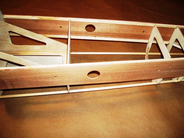

Pictures of completed motor mount - 2 degree RT added to firewall. Imentioned Loctite E20-HP Hysol for structural joints - it's the best, available from McMaster Carr.
Replaced all of the butt joints with tongue and groove. Made the construction much easier, and stronger. The 1/8"hole patterns on the 4 sides are for aluminum angle reinforecment on the inside of the box.

Top, bottom and side plates are original. Ireplaced the 1/4" thick firewall with new material. Irelieved the ends of the 1/8"material and notched the 1/4" firewall so the pieces would overlap. This moved the firewall 1/4"aft - I'll adjust the lengthby adding spacers to the stand-offs supplied with theengine. F-1 and 2 are the new formers, printed fromscale acad sketches, transfered to the plywood and cut on bandsaw. Note the lower holes in F-2 and thegearplate support slots in F-1 below the epoxy joint - these were done on my mill. Turned out to be a nice rigid structure. SInce Iused original plywood for the basic box, the aluminum angle reinforcement is just a little structuralinsurance- I'll show that later.

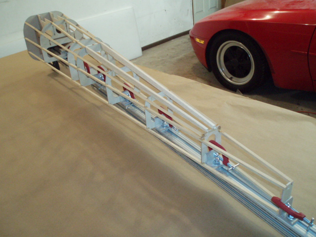

Some pics of the airframe and fixturing.
Iused an 8' length of 80/20 extruded rail, 1 1/2"aluminum angles with 5/16"carriage bolts and nuts to position the formers. This set-up made it very easy to align the formers perpendicular to the centerline, and 90 degrees (plumb)to the rail, and allowed simultaneous dry fit-up of the stringers on both sides. I only made some minor adjustments to the 1/4 x 1/4 notches in the formers in order to keep the sides perfectly flat (checked with straight edge). Decided to use medium CA on all of the joints - no kicker required. After the accessible sides of the joints were tacked Iun-clamped the framework from the rail and did the undersides. Construction was complete in just under an hour. Mahogany side plates get through holes machined tomorrow for the wing tube, then epoxied to the frame. Turtledeck (from previous post) now matches the airframe - Ithrew in the tail just to get some perspective.

I've got a problem - it's been a month since I've worked on the airframe (due to bad weather)- been storing it in the furnace room to keep it at a more or less even temperature and humidity and found that it's developed a 1/4"twist over it's 54"length. In addition to that, it's developed about 3/16"sag from F-1 to F-3 (~20"). Ithink Icould have avoided most of this if the sides plates were epoxied to the spars immediately after Ihad all of the formers and spars set. Ihad it sitting on the firewall with the frame vertical - not like it was laying over anything causing it to warp.
Now, short of soaking the airframe in the hot tube and re-fixturing it to the rail and letting it dry out, does anyone have a solution or recommendation? The airframe can be very easily persuaded back to square and plumb with minimal effort since this problem involves only the 1/4"longitudinal spars at this point. I'm sure that attaching the side plates will eliminate the sag, but not so sure about the twist.
Please let me know what my options are.....or if this is more or less normal.

Those following this thread, Iwas able to eliminate the twist in the airframe using Sensei's diagonal bracing recommendation.Iinstalled the wing tube through the fuse and supported it with a pair of parallels (one on each side), and supported the tail on another parallel just ahead of the last former. Iused a 5 lb weight at F-2 and another 5 lb'er on the tail wheel plate - adjusted perpendicularity at F-8 and epoxied the basswood diagonals. Icouldn't put the airframe assembly back in the rail/fixture due to the additional stringers along the bottom, so the above was accomplished on a large glass table with the airframe inverted.
The 3 sets of diagonals shown along with the tail wheel plate were sufficient to remove the twist after the weight was removed. Obviously the stab will be epoxied to the opposite side. The airframe is now extremely rigid, and perfectly flat again across the top. I strongly recommend to all who are building this airframe design, to use diagonals. The frame as shown is 1.92 lbs (875 grams).
Sensei, the name fits.Thanks for the advice.
