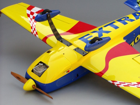

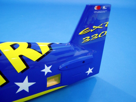

This is the new Jamara 330L its being offered in :
1400mm span for 61
1900mm span for 45 gas
2600mm span for 100 gas
It has a fibregalss fus and built up wings, the elevator servos are under moulded covers at the rear so are the aileron servos, the wing and stab are plug in and looking at the manual it would be easy to install a canister silencer box under the engine box, I am quite excited about this new offering, will be going to Al's models in the near furture as there web site says they have them. The finish is airbrushed and under lacquer.
EDIT: Oh yes on Al's web site its under £250.00 for the 1900mm version.

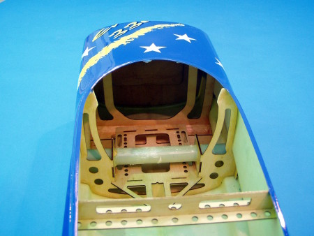

I have ordered one of these, supposed to arrive on Thursday 9th November 2006 once it has arrived will post pics on delivary and packaging.
It seems this ARTF is made by Minicraft and packaged and distributed by Jamara and CML.
Mike
EDIT: added manufactures pics from the J Perkins site CMPro ARTF section.
Mike

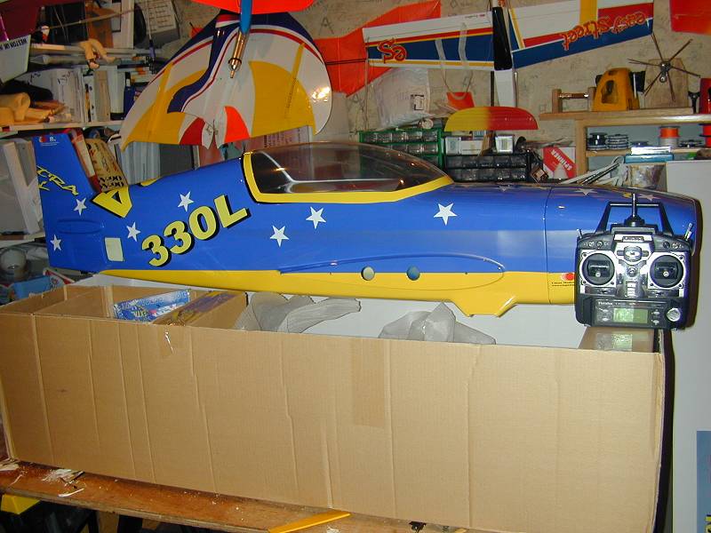

Less than 12 hrs after ordering its arrived good old Parcleforce (GPO), the finnish is supurb, OK there are a few dust pimples under the lacquer coat but only noticable under a harsh light would not be noticable under daylight conditions.
The pin hinges are of very good quality but I have never seen the likes of the horn incorperated with them as the pic shows. Packaging was very good no transport marks at all everything was double wrapped the ailerons and elevators are in with the wings and tail but again seperately wraped in soft material so no chaffing between them.
The only questionable thing in the kit at the moment is the 2mm pushrods for the elevators and ailerons, they will be changed to 3 or maybe 4mm carbon rods, nylon clevisis's supplied will be discarded for ball joints, the cowl and fus has more than enough room for a cannister can not understand why it was not constructed with one in mind.
More later Mike
EDIT: forgott to mention all the hinge points are ready drilled in both surfaces will certainly speed up construction, one of the holes in the aileron had a roll of paper in it, presumably to cover the hole whilst being sprayed or lacquered.
More later Mike

It's the same CMP ARF that is sold through several different distributors. AK models is another one that stocks it. Seems like a very well built ARF. In my experience, CMP ARFs are of good quality. There were a few earlier ARFs that could've been designed a bit better, but later ones like this 80" Extra and the new green Giles 202 seem much better.
The fiberglass fuselage is rare at this scale. I've had the Yak 54 73" wingspan, which is even smaller and had a beautiful fiberglass fuse. It was at bit heavy at about 14lbs with an MVVS 1.60 glow engine. I'll be curious to know what is the weight of this 80" Extra. Do you have a good scale you can weight the empty airframe?

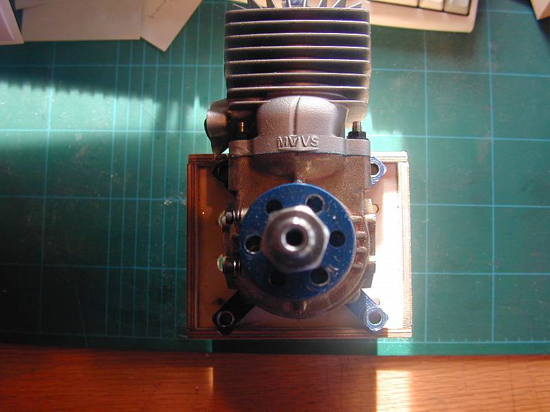

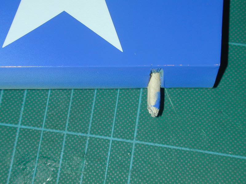

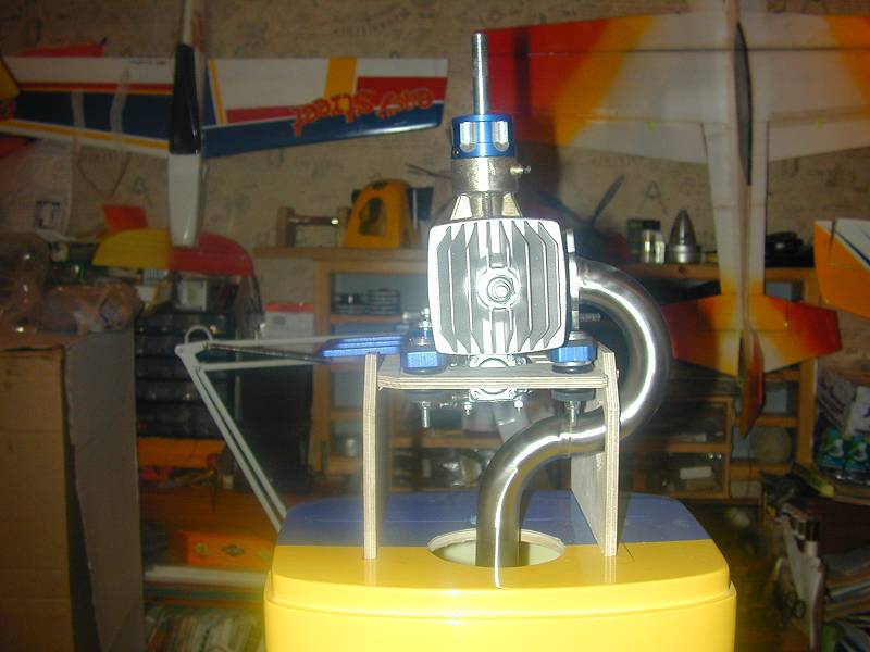

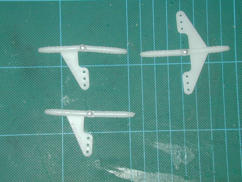

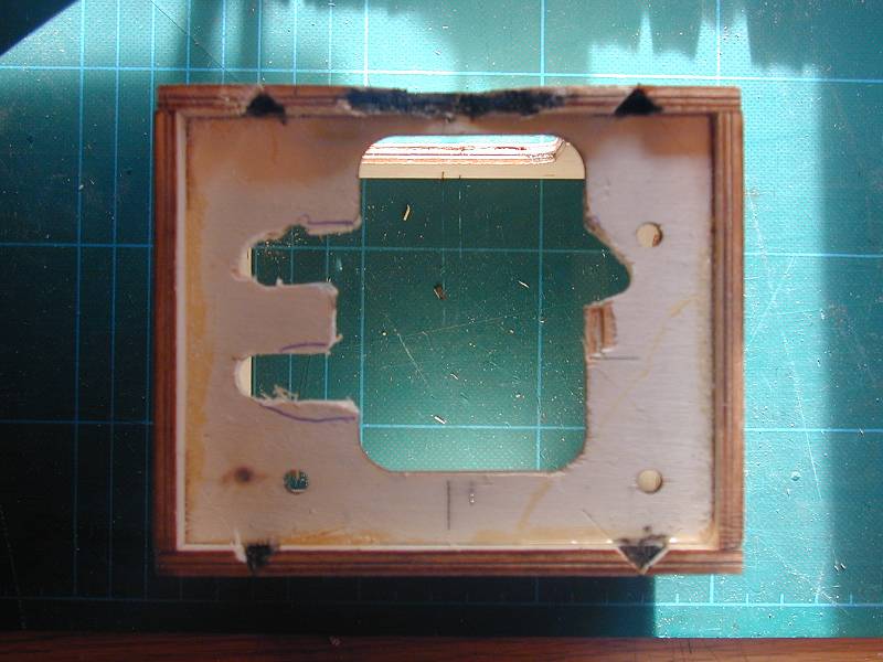

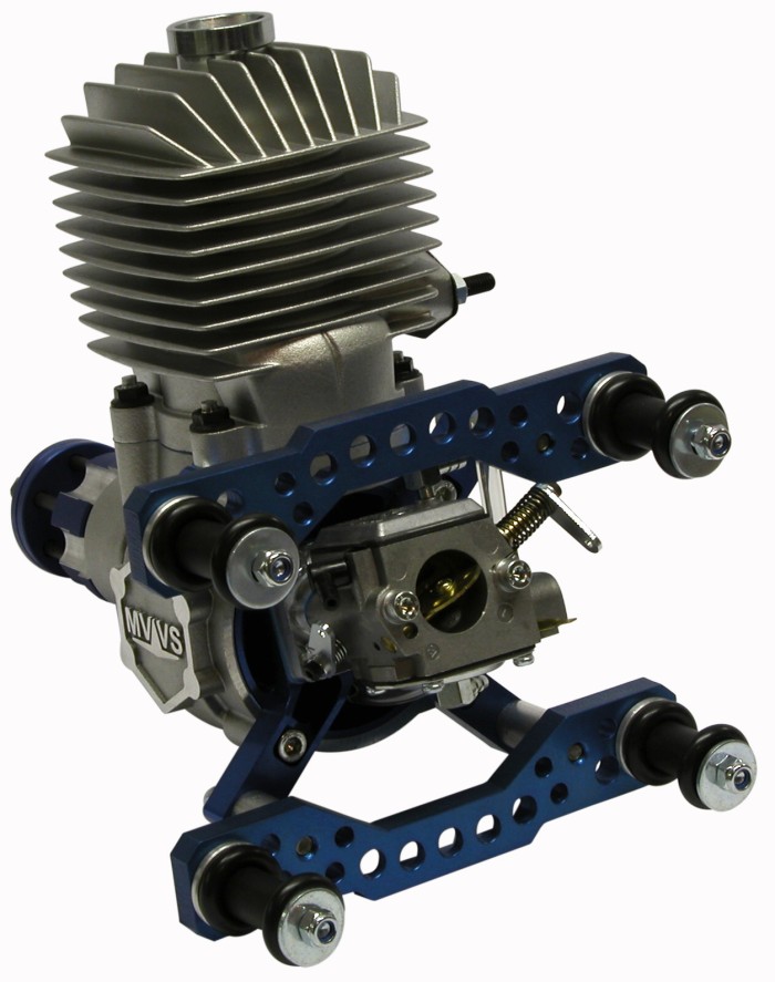

Pics below show the intended motor box with the back support too the right, this is supposed to be bolted through the bulkhead into blind nusts and the box on the left is too be screwed and glued to that.
Second pic shows the MVVS 45 mag with the isolation spreaders installed showing more than adequate space required for instalation, I will have to make a new larger motor box to accomadate the isolation mount.
Pic three shows the miss aligniment of the elevator hinges, so contrary to my previous thoughts having the holes pre drilled will not speed up the process, the elevators are the same colour on both sides but even swapping sides made no difference, I will check the wings next.
Mike

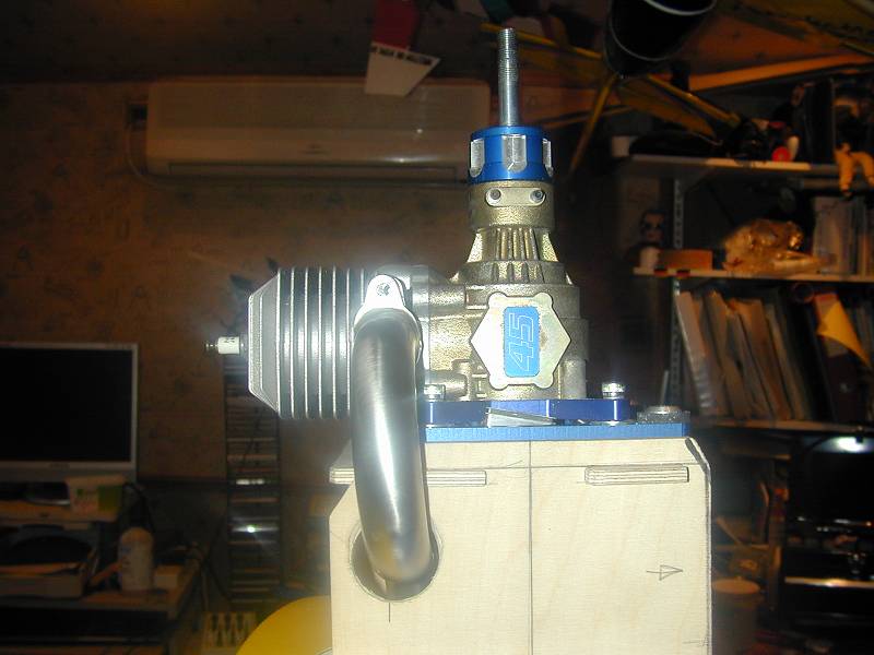

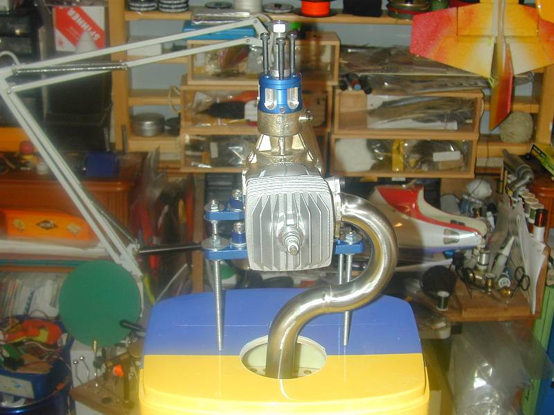

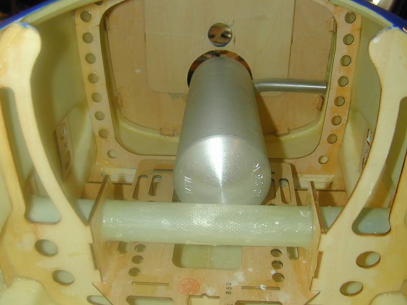

A few pics to show:
Temp stand offs showing distance to front of cowl, leaves room for the manifold.
Second pic shows approx postion of cannister inside fus.
Have to start building the motor box to accomadate the Iso mount.
Mike

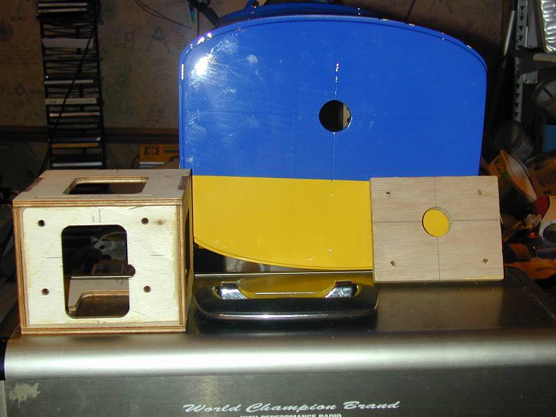

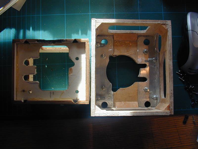

Photo one shews the original engine box with the MVVS 45 in place, photo two shews the mods needed to fit the engine in black and the extended holes for the mixture screws, I would suggest that an aluminium angle is bolted in place behind the bulkhead to increase the rigidity of the front and to give some material for the bolts to bear up against, also a few carbon tows around the outside of the box at the engine mounting plate would not go amiss.
Third photo shews the new motor box beside the original for a size comparison note ali angles and tiangular reinforcements.
Mike
EDIT: one other thing when you mount the MVVS the thrust lines on the motor box will not apply anymore as they are set for a DA50 or similar, do it this way up end the fus and stand it on the tail before you attach the rudder prefably, attach engine to mounting box and place on the front bulkhead, put front cowl on too the plane and adjust motor position to suit the front opening, without moving the engine remove the cowl and mark position of the engine box, then proceed as the manual, the hole for the cannister muffler needs to be drilled prior to fitting the engine box, if you are using the MTW 75K the hole needs to be 75 too 80mm in dia in line with the engine exhast outlet for a zero drop manifold, this will allow the cannister to fit over the top of the UC formers and in front of the wing spar tube.
Hope this helps, please ask if you require more information.
Mike
