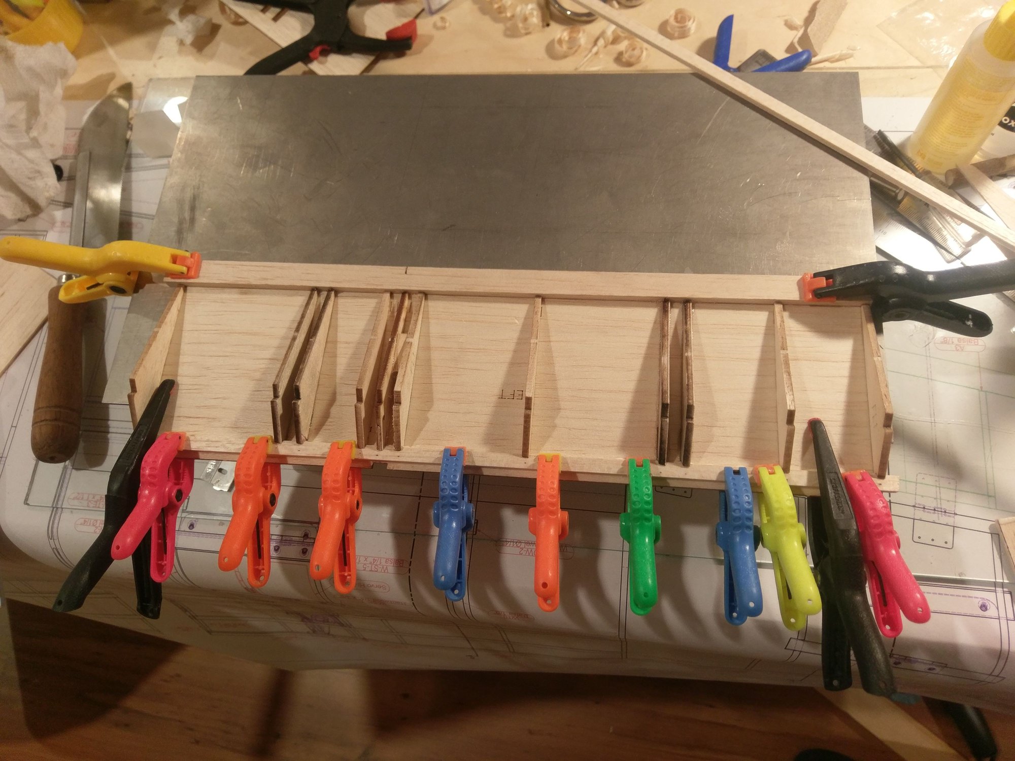

Day 12...
Fin (vertical stab.), and Ailerons
Fin:
This is made in the same way as the tailplane was. Using 1/4" x 1" stock trailing edge as a guide, and the tabs on the ribs facing down. Attach all the ribs to the traing edge.
Cut some 3/32 x 1/2" play spars from scrap (they are not provided) and glue the top spar in place making sure all the tabs are flat on the board.
Add the 3/32" balsa leading edge and sand down to the rib edges.
Add the top sheeting then sand it flush with the the leading
Remove form plan and turn upside down. Now you can remove the tabs and sand the trailing and leading edge down to the rib level.
Add the sheer webbing and hinge blocks as needed.
Add the sheeting and leading edge 1/4" stock than sand the whole thing to shape...
Hold the finished structure up to the fin and make sure the tops are even. Add the Rudder tip block to the rudder and sand to match the contours of the fin tip.

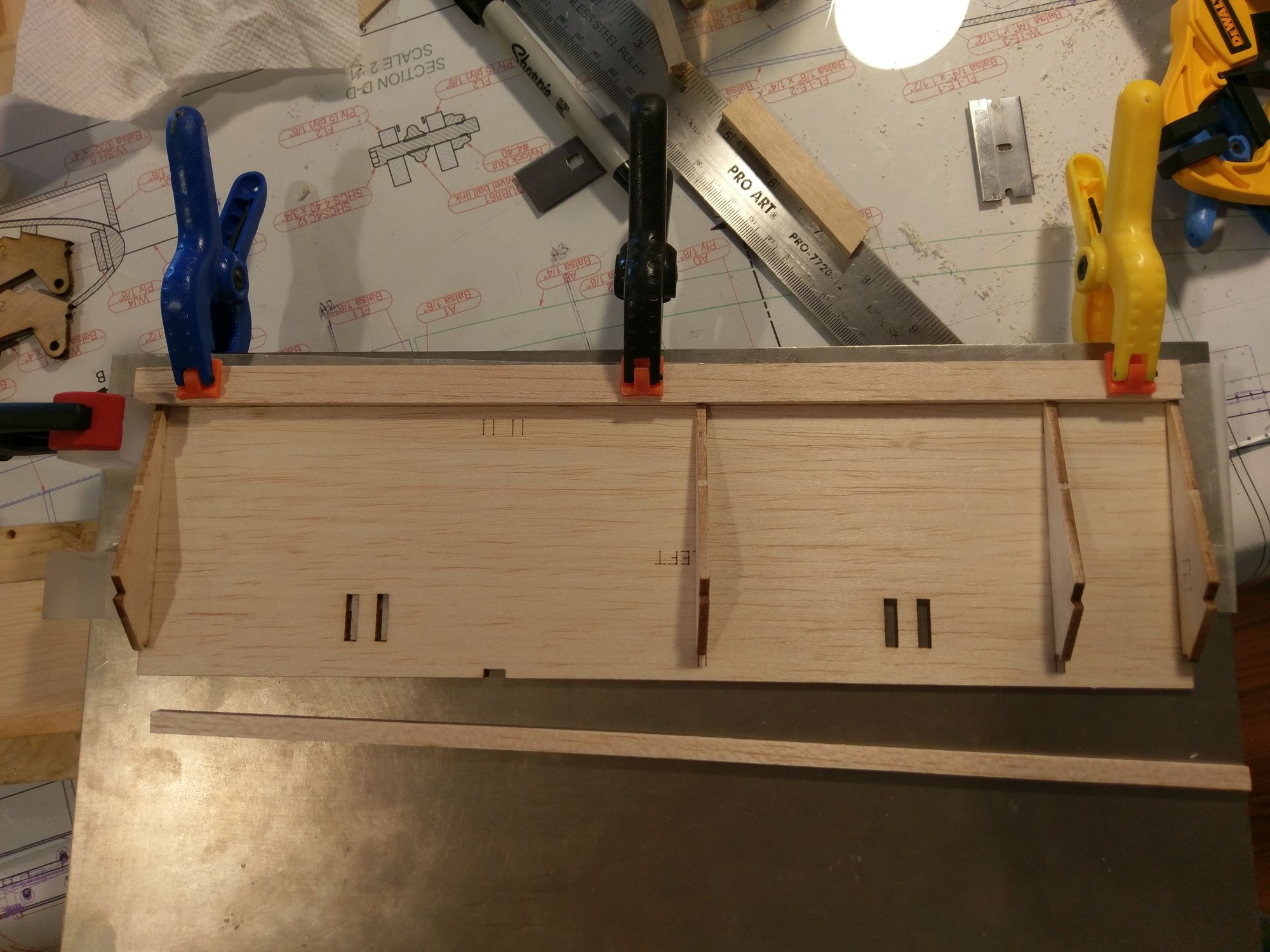

Ailerons:
These are very simple. although you have to be careful to cut the top and bottom sheeting trailing edge shape to match the pre-cut ABF trailing edge parts. If you do not do this they are very difficult to cut to fit later.
Build both at once to make sure you get a left and right aileron!!!
Pin you bottom sheeting on the plan attach TE part ABF and glue all the ribs using the plan and a guide. I checked with MR and they should be built flat to the board.
Again I have added balsa block for hinge points. make sure you put in the ply reinforcements for the control horns. these must be cut from scrap 3/32 ply.
Add the Top sheet and sand the whole thing smooth.
Mark a center line in the leading edge and carefully bevel the edge.

Flaps:
These need of bit of creative engineering. I had previously laminated the hangers and decided to put a graphite bearing in them. i uses an 1/8" carbon rod for the hinge pivot.
I had a old piece of pre-grooved landing gear block that I cut to form the pivot supports.
Build the flaps flat on the plan and use a length of pivot rod to line up all the ribs correctly.
Install the ply horn plate.
I will use two pieces of pivot rod, one will slid in form each side so that they can be removed if needed.
Sand trailing edge to shape, then remove form plan and sheet the bottom.
Sand the leading edge flush with the ribs and test fit the hangers.
Install the 1/4" leading edge and sand to a nice rounded shape.
Cut out the leading edge at the hanger points and you done.

The inclement weather in the mid-west this past weekend encouraged spending time on the CAP10. The ailerons were completed and work started on the flaps, which have offset hinges. Very scale like.

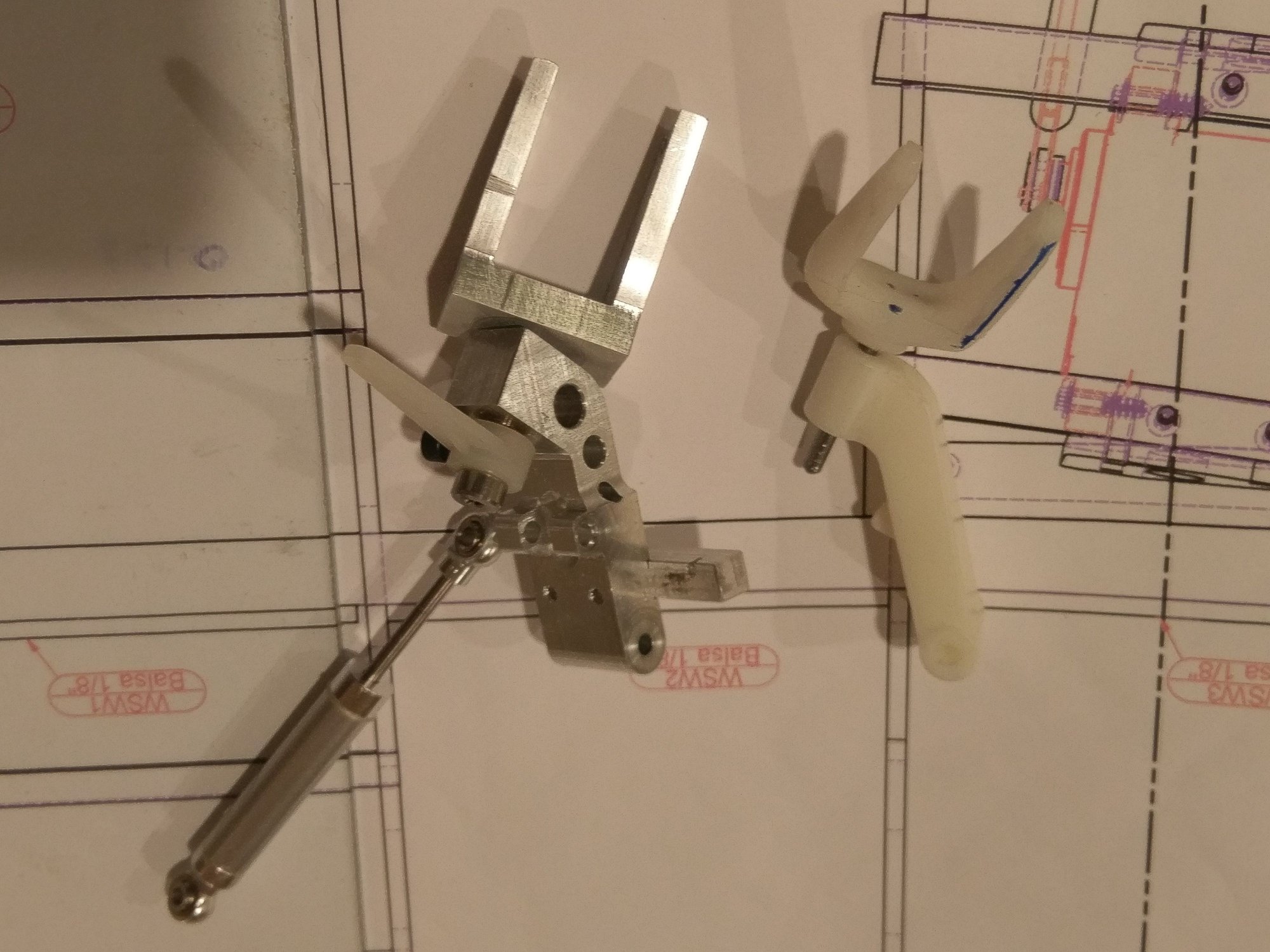

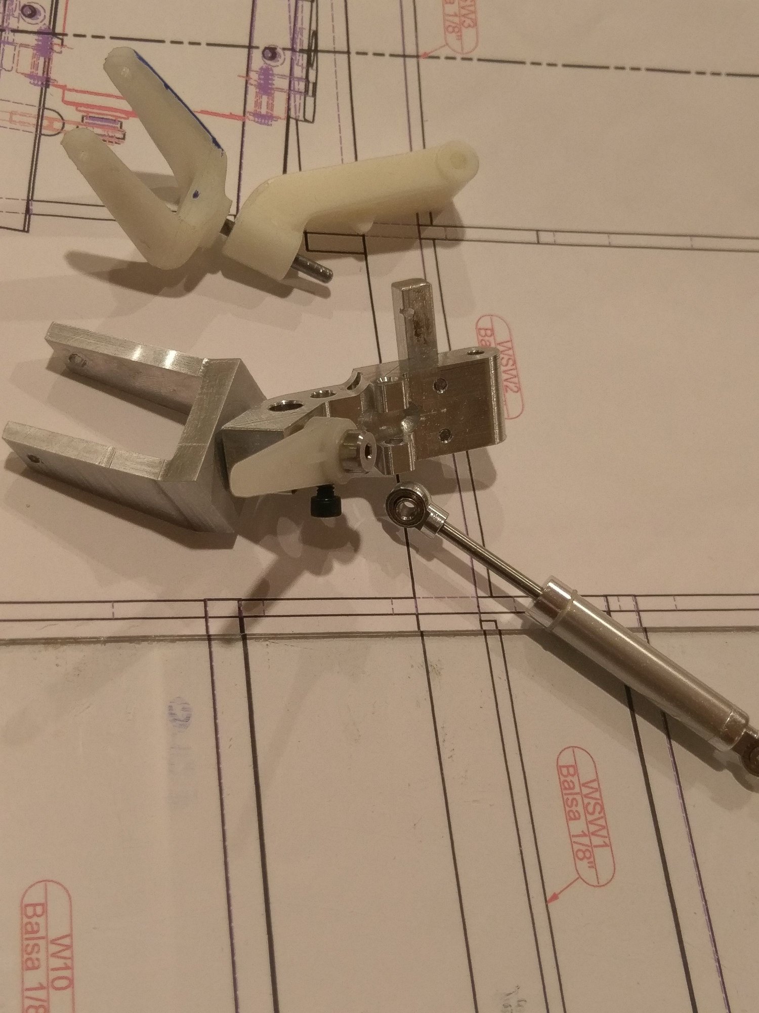

The tail wheel supplied with the kit is a sturdy nylon two part assembly. However, as I changed the design to having a separate servo for the tail wheel, I needed an arm to secure the housing. This gave rise to a new design which I proceeded to make out of aluminum. The original design used a spring encapsulated in brass tube with a piston as a shock absorber. I replaced this with an equal sized shock from a rock crawler. Replaced the inner spring with the one from the kit to keep the spring constant the same.
