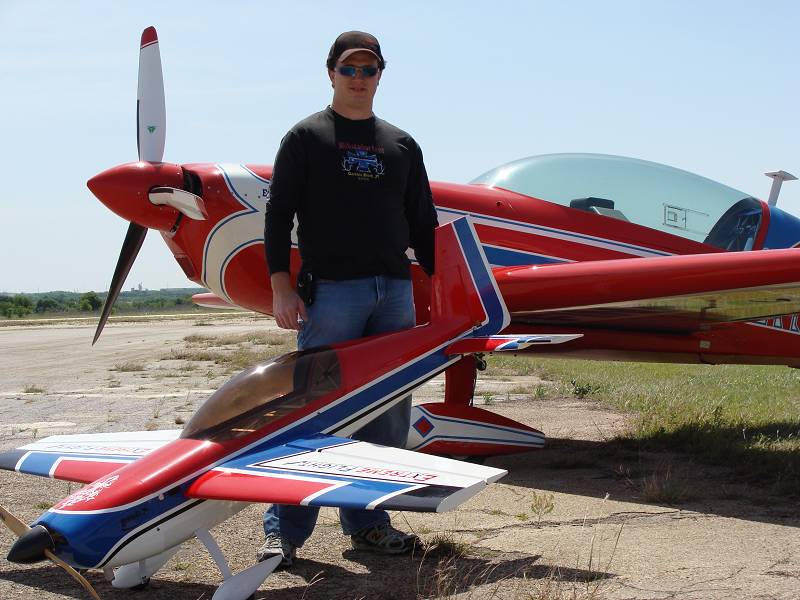

Airplanes-
I would recommend to look at some Extreme Flight RC planes. http://www.extremeflightrc.com/ The Yak and Extra are sweet airplanes. I've got hundreds of flights on my Extra now and it's holding up great. There is also an Extreme Flight Edge coming out soon. I checked it out at the Joe Nall and it is sweet. Chris Hinson(owner) is a great guy and a very good pilot himself.
A few good videos with my Extra flying:
http://vimeo.com/4465171
http://www.youtube.com/watch?v=-a03NKjY_qA
http://www.youtube.com/watch?v=798mjxyRkf8
Another cool airplane to look at the 3D HobbyShop AJ Slick.
