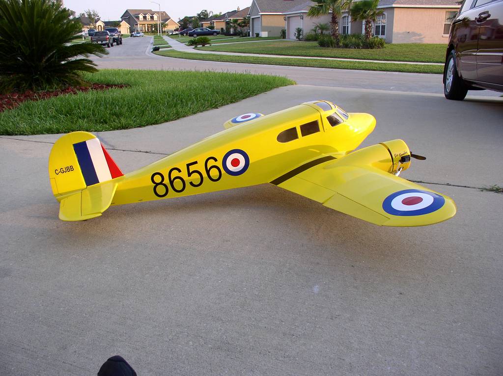

    Great thread guys! The detail on some of these aircraft is outstanding. I understand the starts and stops of the builders here. I plead guilty also. I finished this RCM plans-built T-50 about 7 years ago and have yet to fly it. O.S. .30 fourstrokes for the push.

    .....Very nice work Bob.........I think I have the 1964 issue of RCM that featured these plans...........I purchased a set in 1995 and made plansto build her and then I discovered Don Smith had a 1/5 scale version...........I originally planned to scale the RCM plans up to 1/4 scale............then decided to just gowith the Don Smith plan.........If I can rememberright, the RCM plan made no reference to the cowl construction and I notice that yours looks to be of fiberglass or thin alum........they look great and theattention to detail is very nice.........also, what did you use to build the canopy frame?......that also was not clear on the RCM plans...........and, what does she weigh?...........when I saw your photos it occured to me that I had one on file but dont remember where I found it.....I have been collecting info on this plane for years, which reminds me that I have a copy of this same plane .....also in the Canadian Crane color scheme.........in fact, I thought it was yours, but it turns out that it is not...........I will include a pic so you can see how close they are.
    .....Bob, tell us about your project........like, what inspired you to build the Bobcat.....the color scheme........how long did you spend on building her...........what kind of problens did you incounter along the way?
    .......and.....welome to this littlegroup.

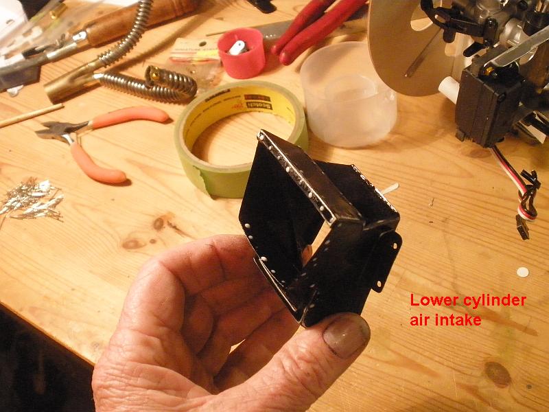

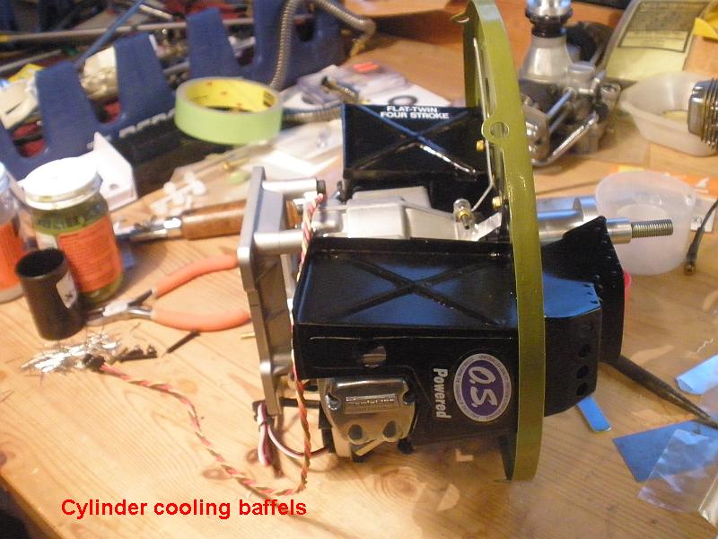

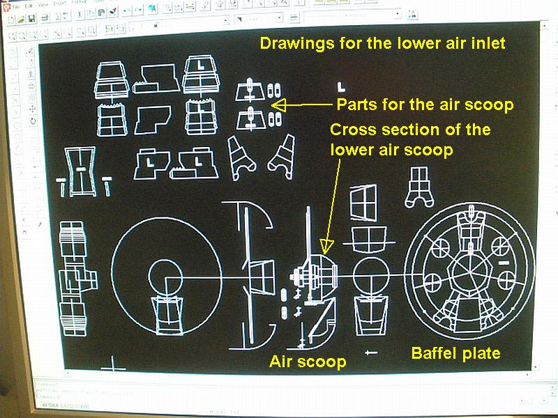

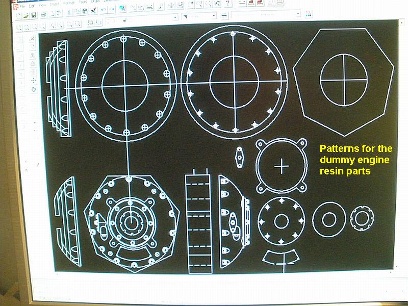

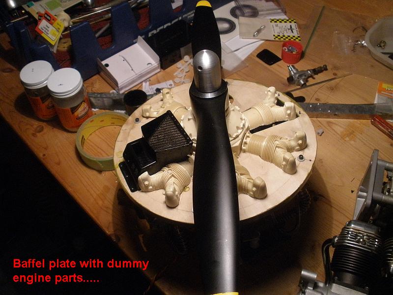

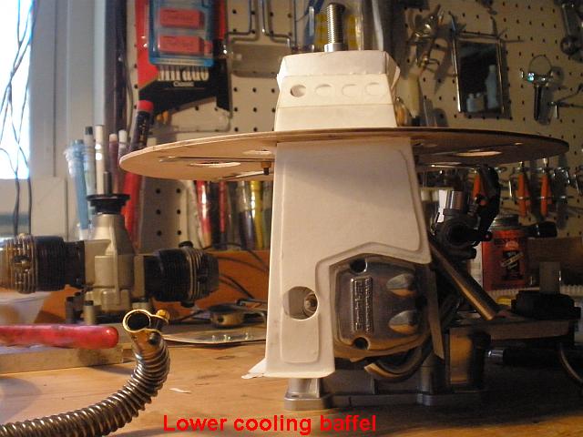

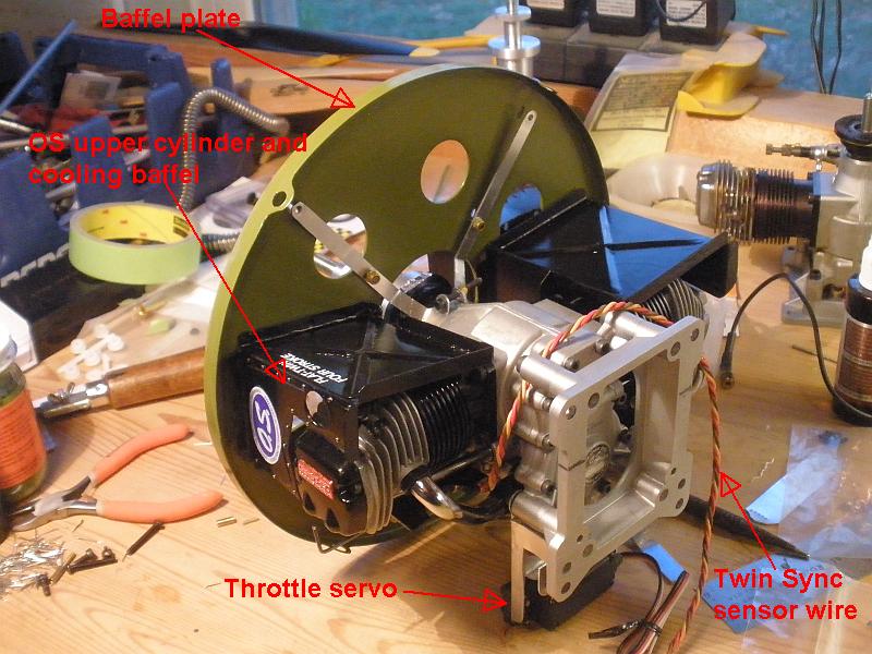

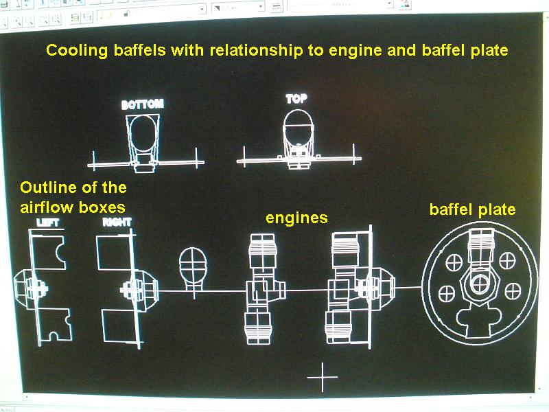

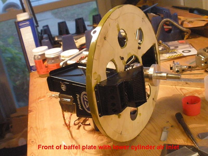

    ......These engines will be mounted vertically opposed rather than horizontal to take advantage of of the dummy engine cylinder arrangement to allow for proper cooling..........a few more pic's for your viewing.

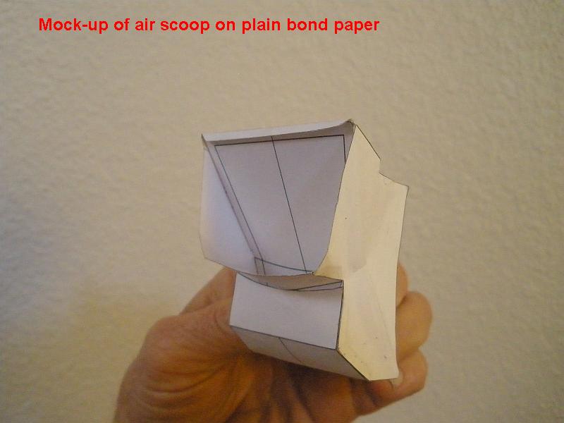

    Rich: What are the cooling baffles made of?

    ......I was wondering when you would ask?............the cooling baffels and the air scoop are all made of Crystalblank paper.....some people call it poster board......it is about .016 in thickness and is great to work with...........the secret isthe stiffining of it after the part has been made. you know that CA will harden wood.....it will also harden paper....in fact so hard that you will not be able to cutitwith anexact-o-knife......the CA soaks all the way thru thepaper and seems to displace it's every fiberwith a plastic like consistancy and feel......I have found that if the part is to have a paint finish it's better to coat the paper on the opposite side as it tends to produce an uneven surface that requires sanding to smoothing it for paint, and that works,but like I said, it is very hard....Once the part is made andhardened alight sanding will help prepare it for priming and paint....I am using Nitro fuel, so my choice of paint is Aerogloss......but they only produce the clear, sanding sealer, balsa filler coat andthinner........I primed the surface inside and out with the sanding sealer, my favorite.........I used three coats of sealer and finished it off with SatinBlackLusterKote spray paint. Try experimenting with this method on test peices ofdifferent paper to seehow well it works.........but besure to lay it on a non stick surface such as a sheet of teflon, that backing paper on most peal and stick decals........also an old teflon skillet will work.............so, now for a few pic's to better illustrate this procedure.
