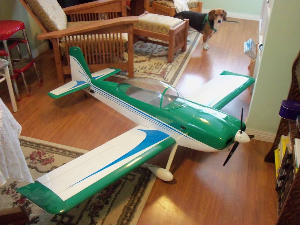

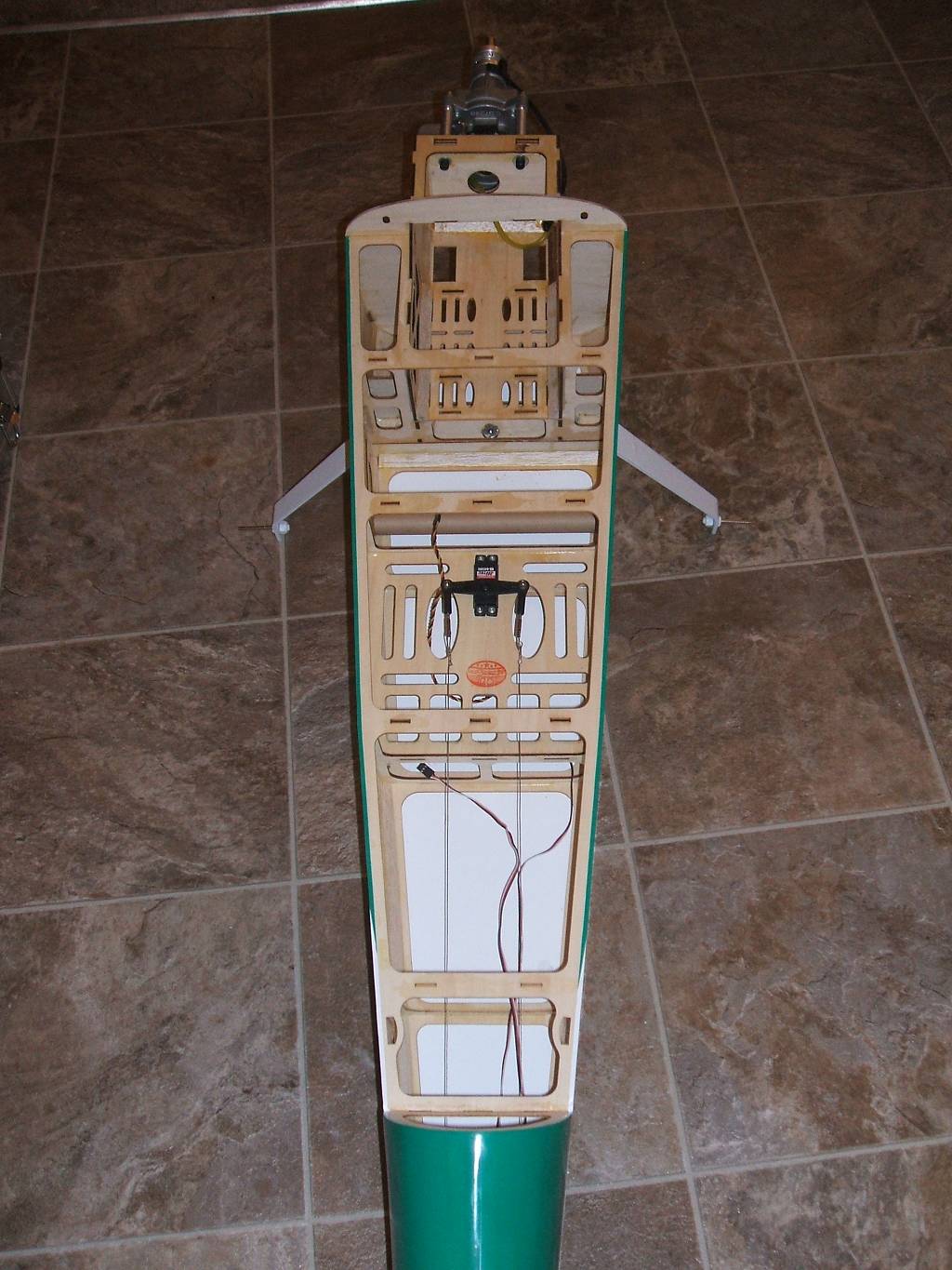

    Aztech / Slipstream RV-8 30cc assembly
    Last night a flying buddy brought this airplane to my attention. We have both been looking for a larger RV-4 or 8. We both have the GP 1/4 scale RV-4 arfs and we LOVE them. I contacted Aztech Aeromodels and discovered that they are only an hour's drive from where I live. Azhar (the owner of Aztech) offered to hand-deliver the plane to me the next day.(today) How could I say no? The airplane is a great deal at $290.00, delivered in CONUS. Unpacked, I found it to be 100% damage-free. It also turned out to be 100% manual-free, but I couldn't find anything in the box that I didn't recognize, so I'm not worried about it.
    The covering is classic "Chinakote", nicely applied. No wrinkles anywhere. Near as I can tell, everything is here that should be except the manual. Aztech is in the process of writing a new manual, so perhaps that explains it. The hardware was a pleasant surprise. With the possible exception of the tailwheel assy., everything seems usable. The tank stopper appears to be for glow rather than gas. I have a 16 oz. DuBro ready to go, so I'll be using it instead of the supplied tank. Would have been nice if the L/G had been white instead of black as it's exposed on the bottom of the fuselage. Here are some pics.

    One reason I jumped at the chance to buy this model is that I have everything on hand to complete it. I'll be using a DLE30 for power. A DLE55 is tempting, but after looking at the airplane, I think it's too small and lightly built for a 55cc without major work. With the needed mods I think it would be hopelessly nose-heavy. HS645MG's will be used on the primary flight controls, with HS5485HB's on the flaps. This is almost certainly over-kill, but what the hell, they're on-hand. A 14 ch. receiver will be used so that everything can have it's own channel. Computer-radios have made me so lazy! I haven't decided yet whether or not to install a servo for the choke.
    I am approaching this airplane as a sport airplane rather than a scale airplane even though it looks pretty scale. Included scale detail is pretty much non-existant. Of course at this price one couldn't reasonably expect much beyond a 2-D instrument panel decal.(which there isn't) This thing is so light that a 30cc gasser should motivate it nicely. The flaps are so small and of limited travel as to be practically useless. In exchange for this you get HUGE ailerons which should make for a great roll-rate. A good trade-off IMO.
    All of the flight control pushrods are nice and short with supplied ball-links at each end. Pull-pull hardware is included for the rudder.

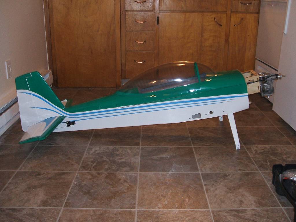

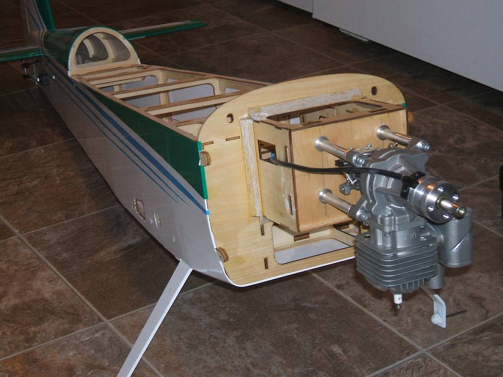

    Got the firewall drilled and the engine hung so I can mark the firewall for the throttle linkage. The elevator servos and rudder servo are installed, along with the horizontal surfaces and rudder. The canopy on this thing is HUGE. The fuselage is cavernous as well. The holes for the wing bolts are between the wing tube and a former making it a bit tight for larger fingers. The supplied wing bolts are metric (as is the rest of the hardware) and of the thumb-screw type. I went ahead and painted the aluminum gear to match the bottom of the fuselage. The supplied axles are just the right length and don't need to be shortened in order for the wheel pants to fit. There appears to be no fuel-proofing on the motor box/firewall area, so I'll give it a coat of thinned epoxy once the linkage holes are drilled. Here's some more pics.
