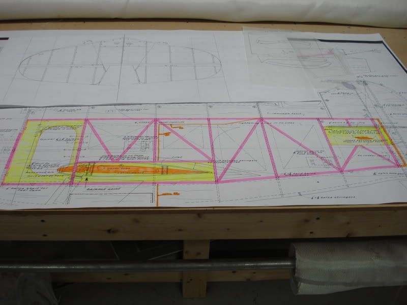

    Fuselage Construction:
    As drawn, the fuselage is built with a pair of light-ply sides that are "curved" to follow the outline of the side of the fuselage. I REALLY hate building "curved" fuselage parts b/c they are nearly impossible to get perfect on both sides causing big flight problems due to an inaccurate shape.
    So to fix this issue, i'm going to build up a 1/4" sq Balsa/spruce structure similar to the welded tube fuselage of the full-scale. This will allow me to incorporate hardwood dowels in the cockpit areas so when looking inside the door (which will be functional) and the canopy, it will actually appear to be welded tube.

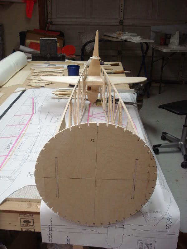

    First up was changing the inner fuselage "structure". Hostetler has you build a pair of full-length fuselage sides from 1/8" balsa laminated with 1/64" ply on both sides. These are then "curved" and placed down the center of the fuselage and balsa spacers used to hold the curve.
    I personally don't like that curve (you can see the "orange" on the top view of the fuse, this is the original outline), as it will make things a bit difficult to keep straight..
    So the inner fuse plate (for lack of a better term) will be built up from 1/4" sq. spruce, balsa and balsa sheet. I believe this will be just as strong and lighter than the as drawn setup. The pink outline on the top and side view.
    Looking at the top view of the plan, the inner structure is parallel to the center-line from the firewall aft to the instrument panel. the sides then taper back to the last bulkhead.
    The outer bulkhead templates were then modified so they fit the new fuselage plate. Their will be 1/4" sheet balsa in the area where the wing carry through spars pass through the fuselage. This can't be figured out until I have the new wing ribs drawn up.

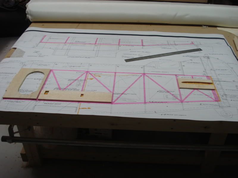

    I took today to finish the modifications to the plans, 4 hours of work later, the Horizontal stab is done (except for the ribs, these i'll knock off in profilli real quick):
    And to show the difference between the "accurate" horizontal and the plans horizontal, here ya go:
    The wing plans were modified for new spar locations (so they coincide with the flying wire attachment points), and the aileron outlines were adjusted. The plan drawn ones were slightly to narrow, short in span, and shifted towards the tip slightly to much.
    Due to the extremely thin nature of this wing (about 1 1/4" at the thickest point), my control system will have to be sized a little different. Instead of the 1/2" rod, i'll have to use 1/4" and instead of the ball-bearing supports originally planned, they will have to be G-10 laminated to both sides of the wing ribs.
    The Fuselage plan was also finished.. As you've noticed, when I modify plans like this I like hi-light the new structure area's as they are drawn so the lines don't get lost in the madness. I also make notes on the plans and hi-light them different colors so they are more noticeable.
    And a whole stack of templates ready to be attached to their respective wood pieces and cut to shape.

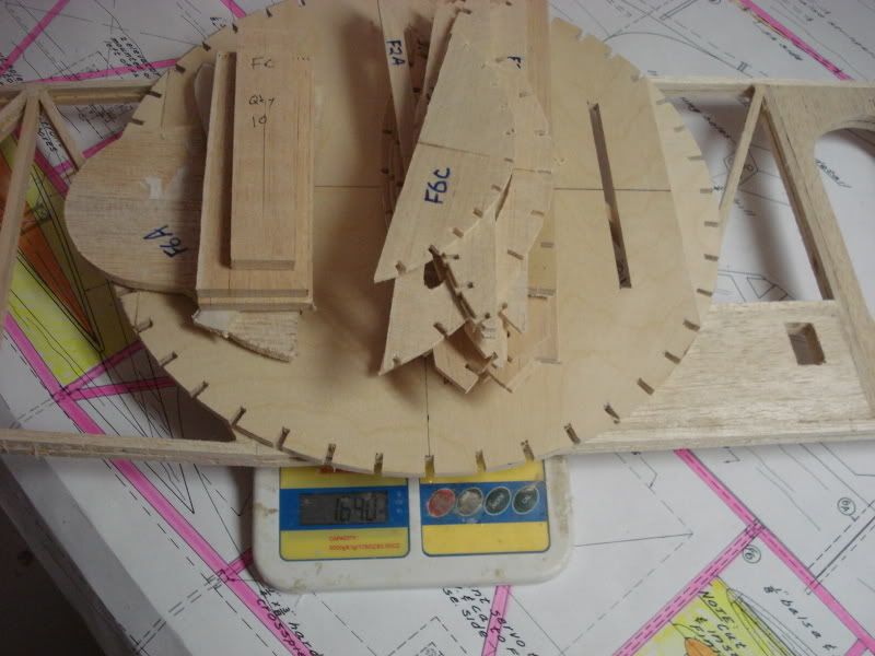

    Did some weight calculations so far today. With all the "guts" for the model, i'm at 15lbs worth of stuff. I am going to shoot for a 19-20lb flying weight (3 to 6 lbs less than advertised on the plans), so that leaves me 4 to 5lbs for the airframe, covering and paint. I think that should be easily obtained.

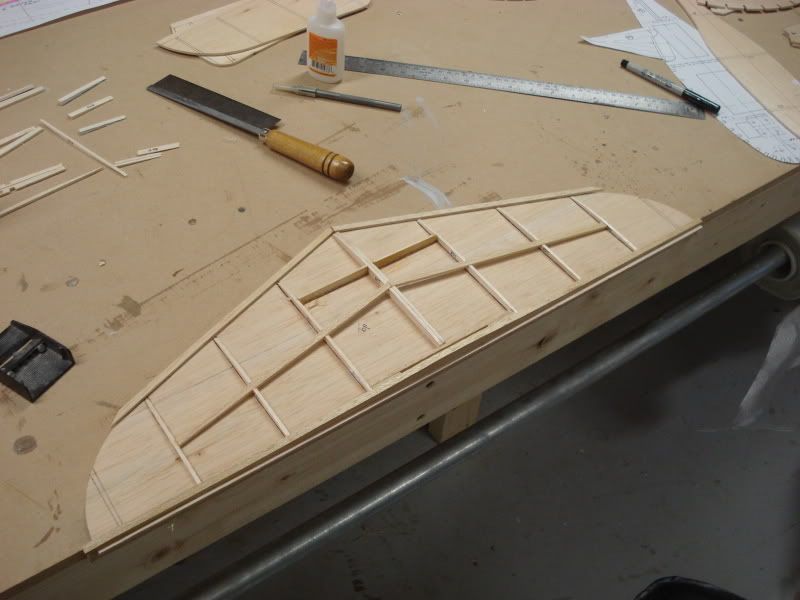

    I decided to add some structure to the horizontal stab and modify a few bits...
    The stab will be built with a 1/8" balsa "core". The ribs will then be cut in half along their chord line so as to remove a 1/8" section. The ribs will then be glued to the core and a 1/8"x1/4" spar will be installed, along with a 3/8"x3/8" LE and TE, then sheeted with 3/32" balsa. A slot was also added just infront of the TE so that the last fuselage bulkhead can slot into the horizontal stab locking the entire thing together.
    A few hours of work later in the day and I've got the majority of short kit cut.. I'm waiting on my order of wood from National Balsa to show up so I can cut the last of the short kit parts (firewall, last fuse bulkhead, rudder false LE and a few wing ribs).

    Then I started to do some real work.. The stab cores are cut from 1/8" balsa sheet, and the wing ribs are cut from 1/8" balsa. Their is then a 1/8" thick section of balsa removed along the chord line of the ribs. the rear spar is 1/4" balsa glued on-top of the stab core, then the ribs and 1/8"x1/4" leading edge are glued to the core. I've got to put a portion of 1/8 balsa around the curve of the tips, put in the hinge blocks and then cover the ribs with some tape, then sand it all to shape. It will then be sheeted with 3/32" balsa, then flipped over and the process repeated.
    The elevators are built using the same method, but using a 3/8" wide leading edge..

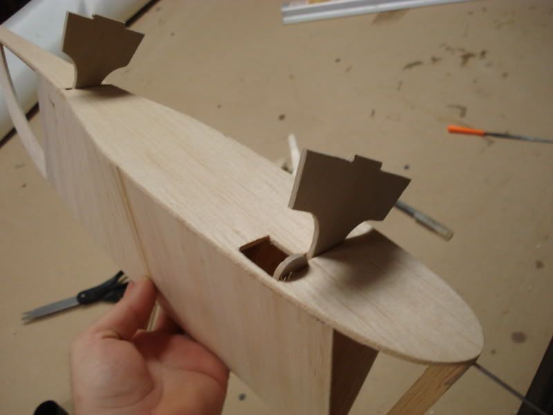

    Finished work on both elevators and have them sheeted. All that is left for the horizontal stab assembly, hinging, gap seals and elevator control arm/connecting rod.
    Then I started work on the rudder. Plans call for a 1/8" OD brass tube as a guide for the rudder hinge and a piece of music wire routed from the top of the fin through the tube as a hinge pin. I'm not fond of steel in brass, so I decided to use a piece of yellow nyrod pushrod material. Then a piece of music wire will be slid through it.
    I then took the rudder ribs, glued them to the rudder false LE and then the trailing edge parts to the ribs, then slid the nyrod hinge bushing into place and glued it in.
    I also cut the rudder hinges from 1/8" birch ply. I had intentions on cutting these from 1/8" G-10, but i ran out and didn't feel like waiting for an order. I also glued the nyrod hinge bushings into the ply pieces as well.
    I would of sheeted the Rudder tonight, but of course I ran out of 1/8" sheet balsa, so I still have to wait on that stupid wood order, which "supposedly" shipped today.. They gave me a tracking number, but it hasn't be picked up, so i'm thinking they just sent me a tracking number to shut me up..

    I got a bit impatient today, so I went to the LHS and bought a little bit of wood, and then off to get a new set of band-saw blades to cut my own fuse stringers, oh and some robart hinge points.
    Drilled the hinge holes in the elevators and stabs and test fit the hinge setup on those and rounded the leading edges.
    Then took some 1/64" ply and made up the gap seals. The horizontal stab and elevators are now ready for final sanding and glassing:
    Then i decided to sheet that rudder. After trying to sheet with the extremely soft 1/8" balsa I got from the LHS, I came to the realization there was no way it was going to get sheeted with 1/8" balsa. So I used 3/32" I also added some 1/8" sq hard balsa false ribs between the rudder ribs to support the sheeting as well (no pictures of them though).
    Then I finished the rudder hinges and cut the hinge wire. Then test fit it all together:
    Then I finished sheeting the top of the rudder and slapped it up against the plans to have a look-see. The bottom of the rudder will get a pair of carved balsa blocks that will be hollowed out. I "think" on Delmar Benjamins replica, their is the white tail nav light in this bottom portion.. if so, I think i'm going to put lights on mine
    Then for that last fuselage bulkhead, i cut a pair of 1/64" ply bulkhead doublers, then using Gorilla Glue, I laminated these to the 1/8" balsa core, and put a piece of scrap melamine shelf board and some weight on it to cure over-night:
    Then I laid out the fuselage plans on a ceiling tile in prep for starting to build the fuselage frame halves:

    I decided to build up the 2 fuselage frame sides tonight. I'm in a building mood and not a Molding mood, so the F-14 didn't get waxed of anything tonight. I'm not looking forward to 14 hours of non-stop work to mold the front half of that fuselage top... I'll do it later
    So, back to GeeBee stuff. fuselage Frames.. here ya go.. My new bandsaw blade has a messed up tooth, so the cuts aren't the greatest on the ripped down 1/4"sq. stringers... oh Well, Weight reduction
    I cut all but 2 of the fuselage cross pieces, yea i know "whats 2 more to cut"... so sue me
    Probably not the greatest picture.. But all of the fuselage stuff weights 1.7lbs.
    Add in the horizontal stab, elevators and Rudder and your at 2.3lbs. The target goal of 5lbs for the airframe looks pretty promising to make!
    And since I had a good bit of stuff built, I had to do a mock-up! **** that is one big firewall

    Time to start assembling the fuselage.
    First up was drawing a center-line perpendicular to the short edge of the ceiling tile. The fuselage side frames were then tack glued to the firewall using a pair of carpenter squares to make sure they were 90* to the firewall. Then the 1/4"x1/2" balsa cross pieces were installed making sure the center-line of the cross pieces were installed on the center-line on the ceiling tile.
    Then 1/4" sq. Balsa cross-pieces are added to put some extra rigidity into the fuselage frame. The Fuselage frame is now finished and can be removed from the building board.
    For those wondering if all of the extra effort was worth saving a bit of weight, here's some numbers for you:
    The Fuselage frame as seen in the previous photo is - 1.4lbs
    The Firewall alone is - .8lbs
    The lite-ply for ONE of the plans drawn fuselage side frames is - 1.9lbs. So 3.8lbs total for the fuselage side frames plus another .8lbs for the firewall. The "as plans built" fuselage frame would be around 4.6lbs.
    So, I have saved in total so far 3.2 lbs over the stock airframe, NOT to bad at all.
    And another mock-up with the Last fuselage bulkhead (yep, finally got it cut!) and horizontal stab/elevator:

    The top side of the stab/elevators isn't completely cured yet, so the stab will have to wait till tomorrow to get attached.
    So I made up the elevator joiner wire. I basically used the same setup that I used on my FW-190 build. 5/32" music wire some 1/8" thick brass and a 4/40 heavy duty ball-link sandwiched between 2 brass plates. A 3rd plate and 3/16"OD brass tube act as a center "bearing" and support (I originally built two of these, but forgot to install the second one before bending the 2'nd portion of the rod).
    I then finished sheeting the rudder. I thought i was going to have to use a balsa block for this, but I found some balsa sheet that was extremely flexible so was able to use sheet balsa.
    After sheeting 1 side and before doing the other, I figured out i needed to strengthen the rudder "stinger" or else it would get broken. So I took a piece of .010" G-10 and glued it in the center of where the stinger would be, then sheeted the other side:
    Then in order to hide the hinge pin once the rudder is installed, I cut a groove along the bottom Center-line of the rudder for the rod to ride in. I'm not sure how i'm going to keep it installed, but I may drill a hole and put a carbon tube in place, then a screw and washer to hold it into place, not sure.. anyone have any suggestions?
