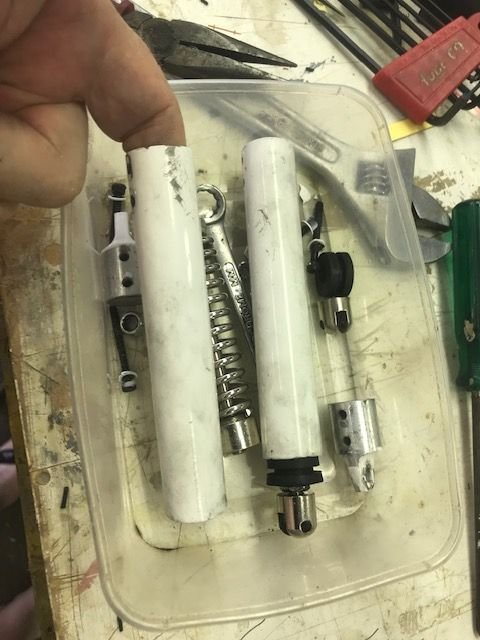

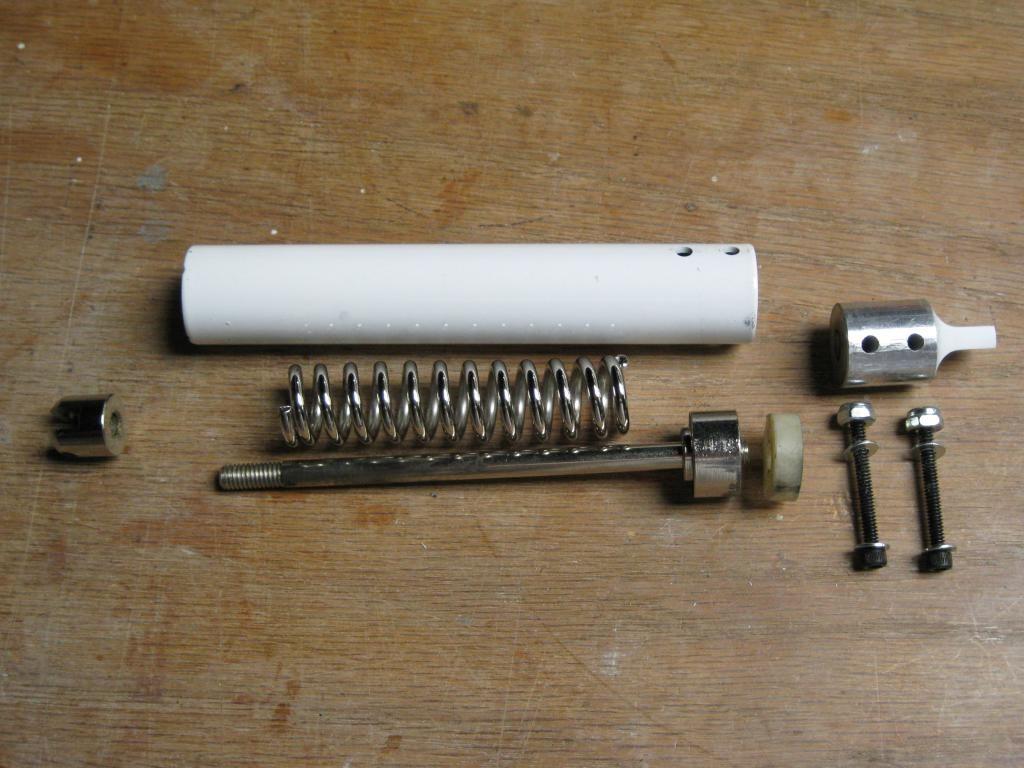

Hi, I found what it was to break the end off. The bracket that the strut end fits in had not been counter sunk so the small cap screw would not stop the strut from moving up. That is why the end broke off and it is dir-cast aluminium. So now I have to try and make up some thing to fit inside the strut and re bolt it back on.

this is what I did with the drill my self counter-sunk the hole in the bracket.Tomorrow I will see if I will be sent a strut set or have to buy a set. If I have to buy I will smash it all up and put it in the rubbish bin because I am sick of this crap plane. Why have these planes not checked or something done to fix the problems and issues??

All good now rampage-1.
They came to the party and gave me a set of struts for free. So they should. Anyway i made sure there was no problem this time checking the bracket and filing it down so it had room to move forward and back. All done now and added some nav lights not that I will fly it at night. Just looks more real.
I will as soon as the weather is good enough to fly her I will let you know how it went.

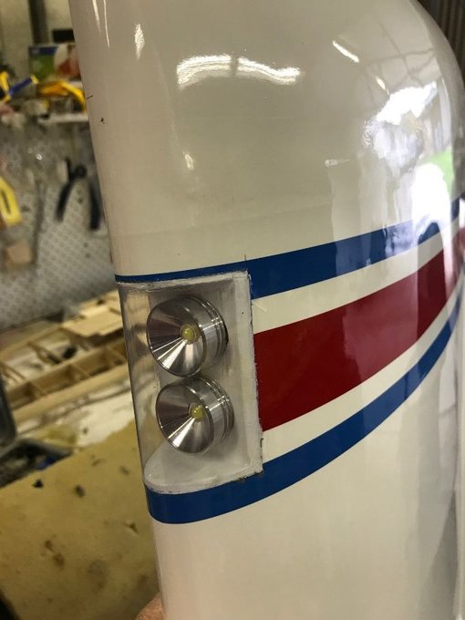

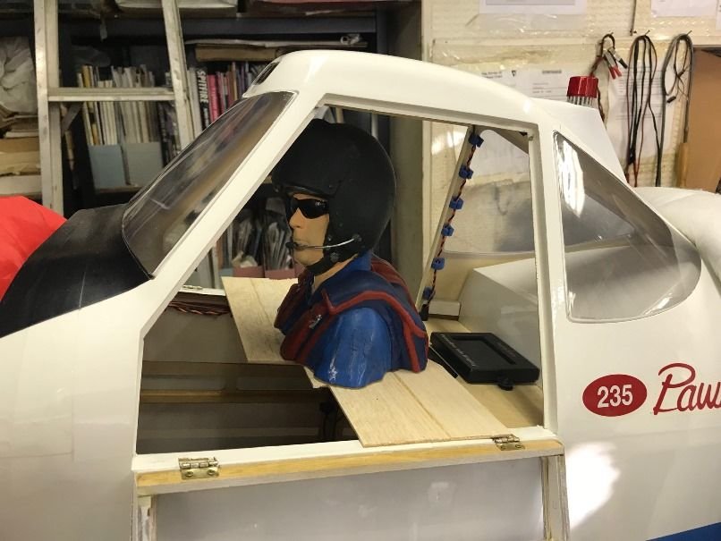

just about have mine ready for flight. got it off a bloke down south as a going concern.
Nav lights, strobes and landing lights fitted. Aces of Iron pilot. DLE-111 in the nose. Powerbox RRS and dual LiFe packs. blah blah

What is the trick to get the shocks apart? I can see the shaft unscrewed from the plunger but was not able to get it to undo, the whole plunger keeps turning in the cylinder.
No trick. This is one I was going to mod by lining the side walls with Teflon lining. This helps to keep the metal to metal from Gaulding and reduces the noise of the spring on the piston walls
No trick here is one that I just took apart.

I was wanting to pull them apart to check spring and was also considering beefing up the springs to the McMaster Carr ones but the bit the shaft threads into keeps spinning and I can not un do the shaft.

ok progress.
- worked out how to pull the shocks apart, end bit that attached to the trunion unscews! Mine had a rubber grommet which hid that feature. All good.
- all structural repiars and reinforcing is completed.
- Did not need to go overboard, along the sides where the UC ply plate is I simply did a fillt of Hysol which works very well.
- US shocks carry though box has been beefed up with 3/16 ply fron, rear and top and trainagluar gussets at each end
- The new springs are on the way, hopefully not frozen!
- I got the longer 5mm bolts from a local fasteners specialist not far from home
- KS brass tubing obtained yesteday from a LHS to sleeve all the pivot points including the top shock attachement points. $51 AUD for the brass!!
Once I get the springs I will recover the bottom and fit all the bits back into it, do a new CG check based on 10" from the root LE where it mates at the fuz and do the next test flights.
cheers
