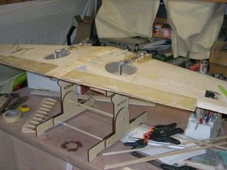

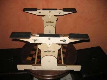

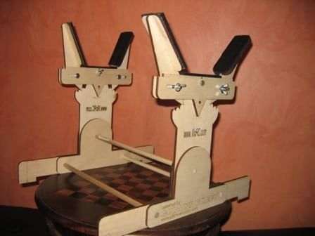

Alan, this is what I use, on my giant aircraft that weigh in excess of 35lbs. It doubles as a CG balancing machine and AC stand and is reasonably priced.
Roger
https://vqwarbirds.com/product/vic-rc-cger-stand/
Roger
Thanks! That looks like a great option. How do you set the distance from the LE to the CG point? (Like if it was 4" from the LE)
Very easy, just align the mark or tape you placed on the wing at 4" with the "Triangle/Arrow" that is shown just above the centre wingnut in the attached photo.

Ok, thanks! Do I still have to balance with the plane upside down?
Yes, low wing aircraft like fighters are normally balanced upside down. If it's a high wing aircraft like a Cessna, Beaver etc. it's balanced right side up.

That's what I thought. But then I seen the vanesssa rig and was confused.
