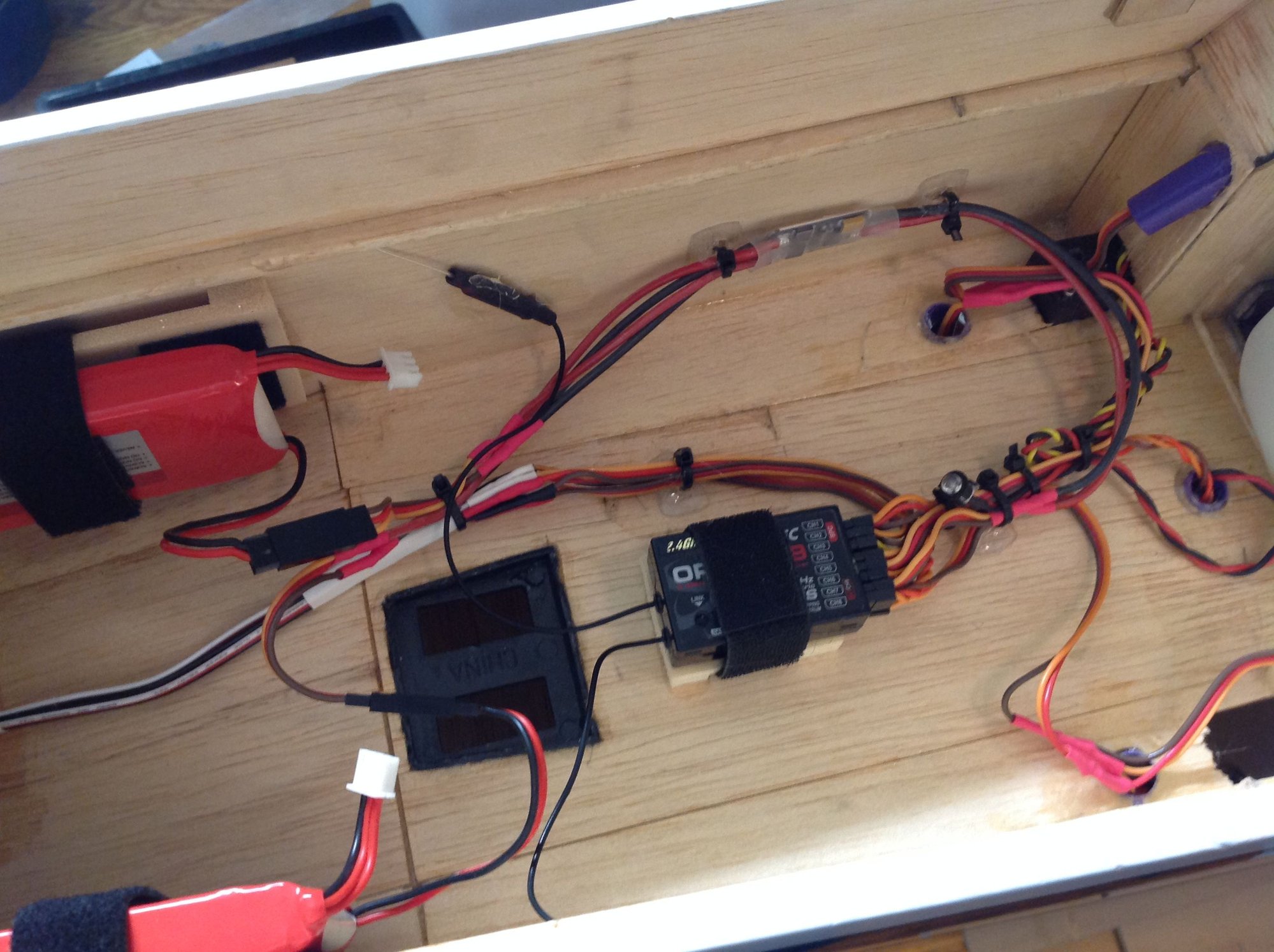

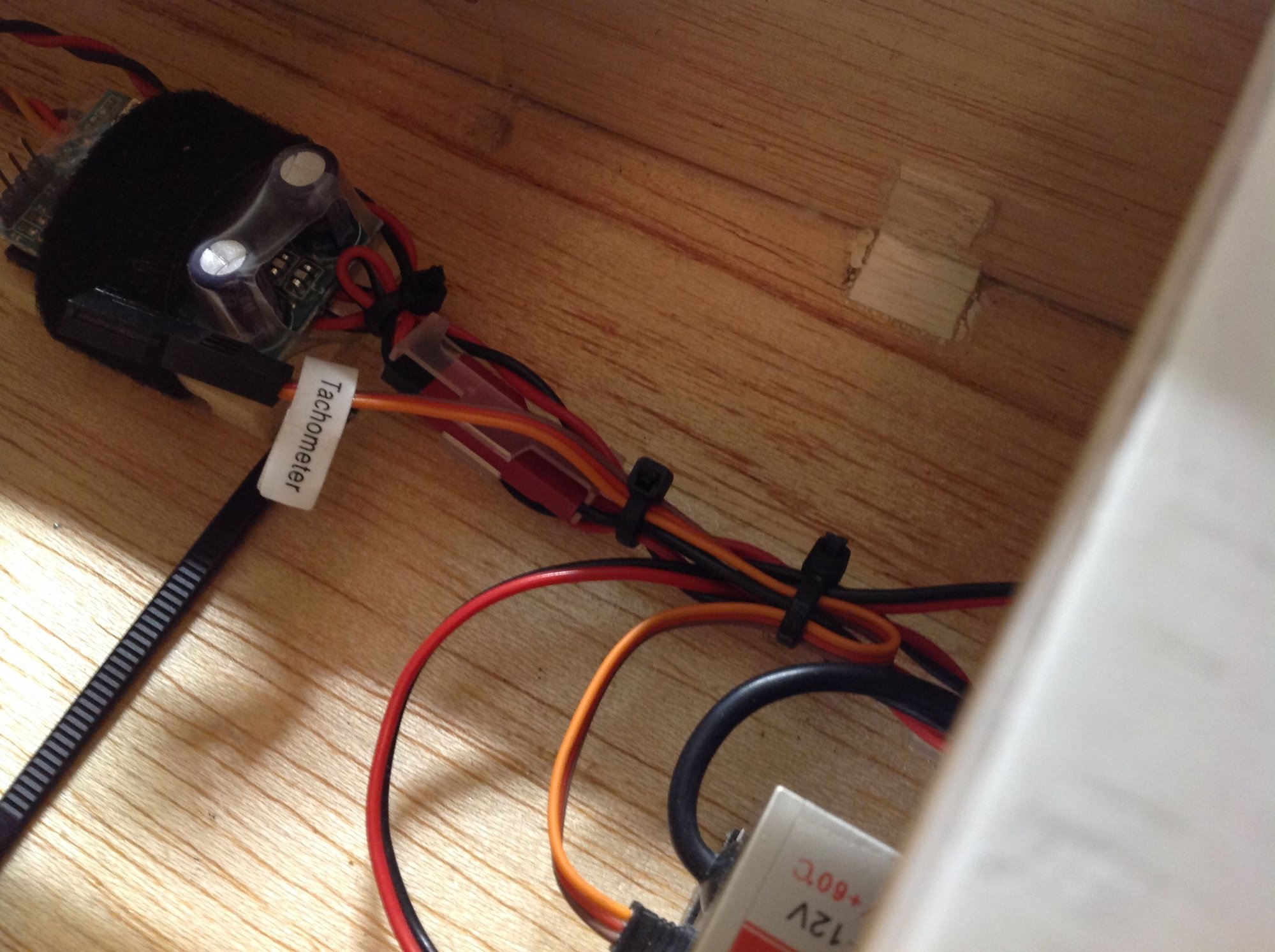

Fairly common setup. Dual batteries, Magnetic solid state switch with dual inputs, dual outputs.
Top left is the IBEC in this case set to 6V. Ignition is bottom right. Although it is a 3W engine, it is fitted with an RCEXL ignition.
It sounds like a well thought out airplane already. It would seem you only need to buy a receiver with enough channels. I would like to see a picture of the setup once you get the airplane.

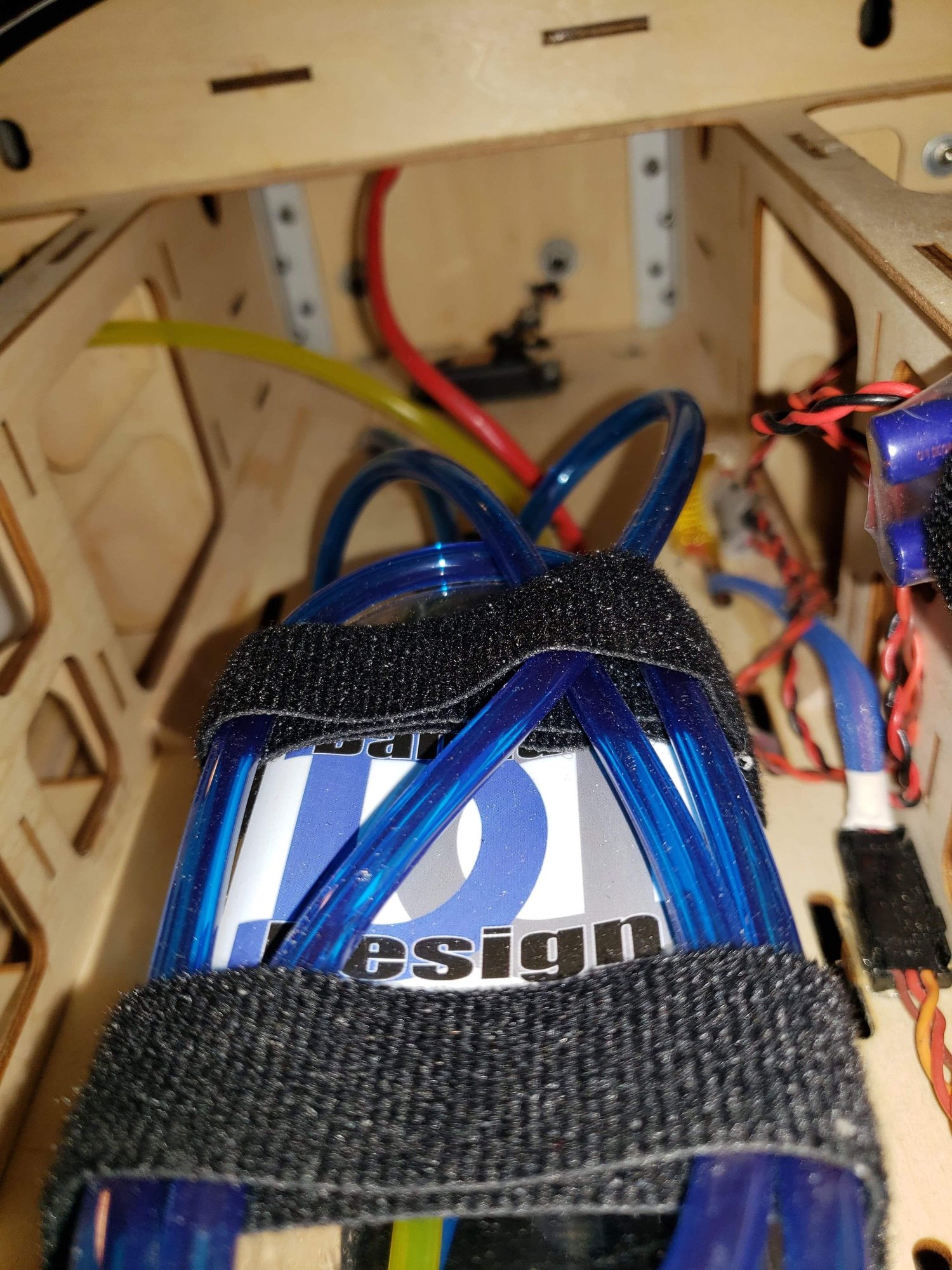

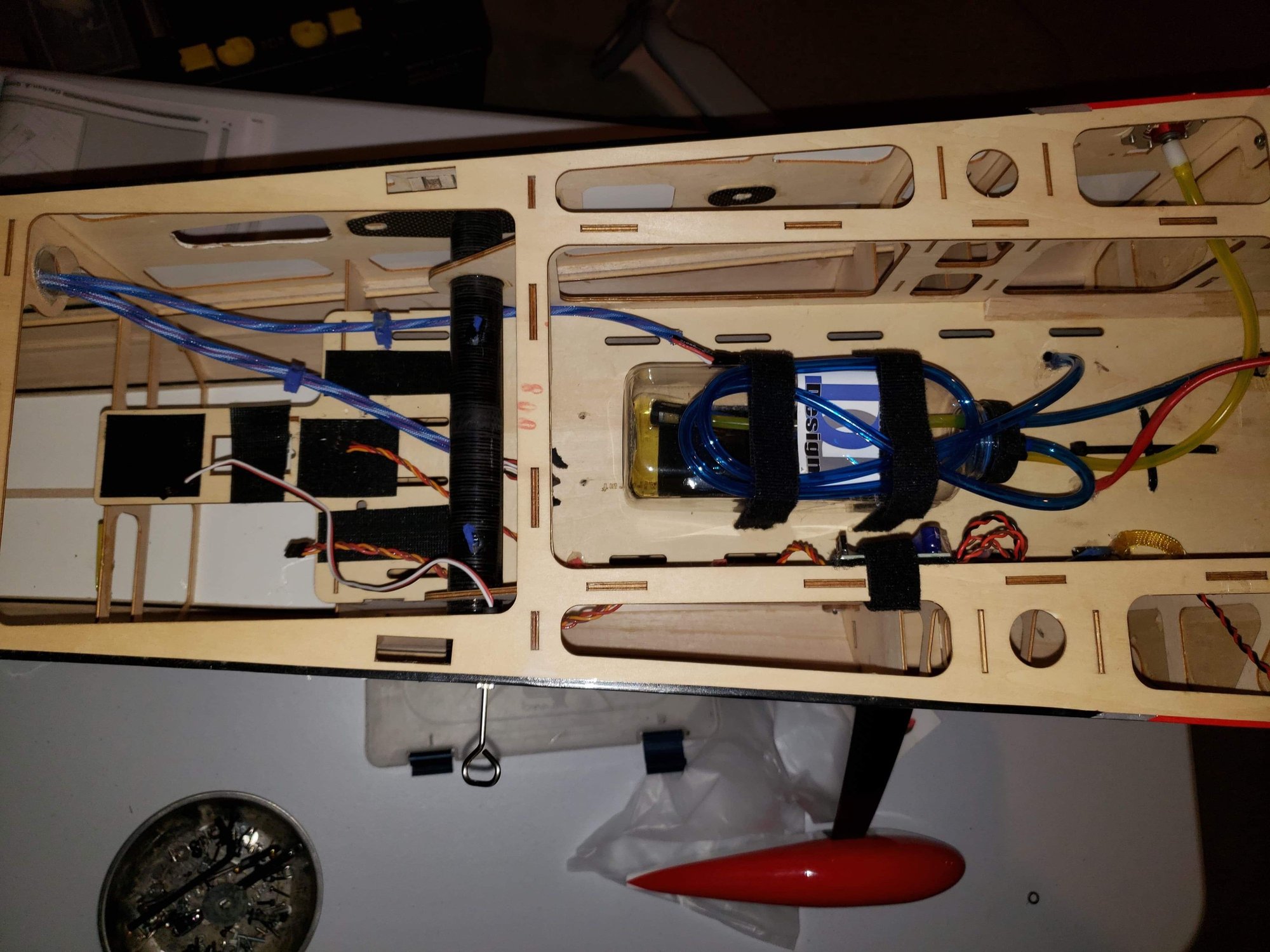

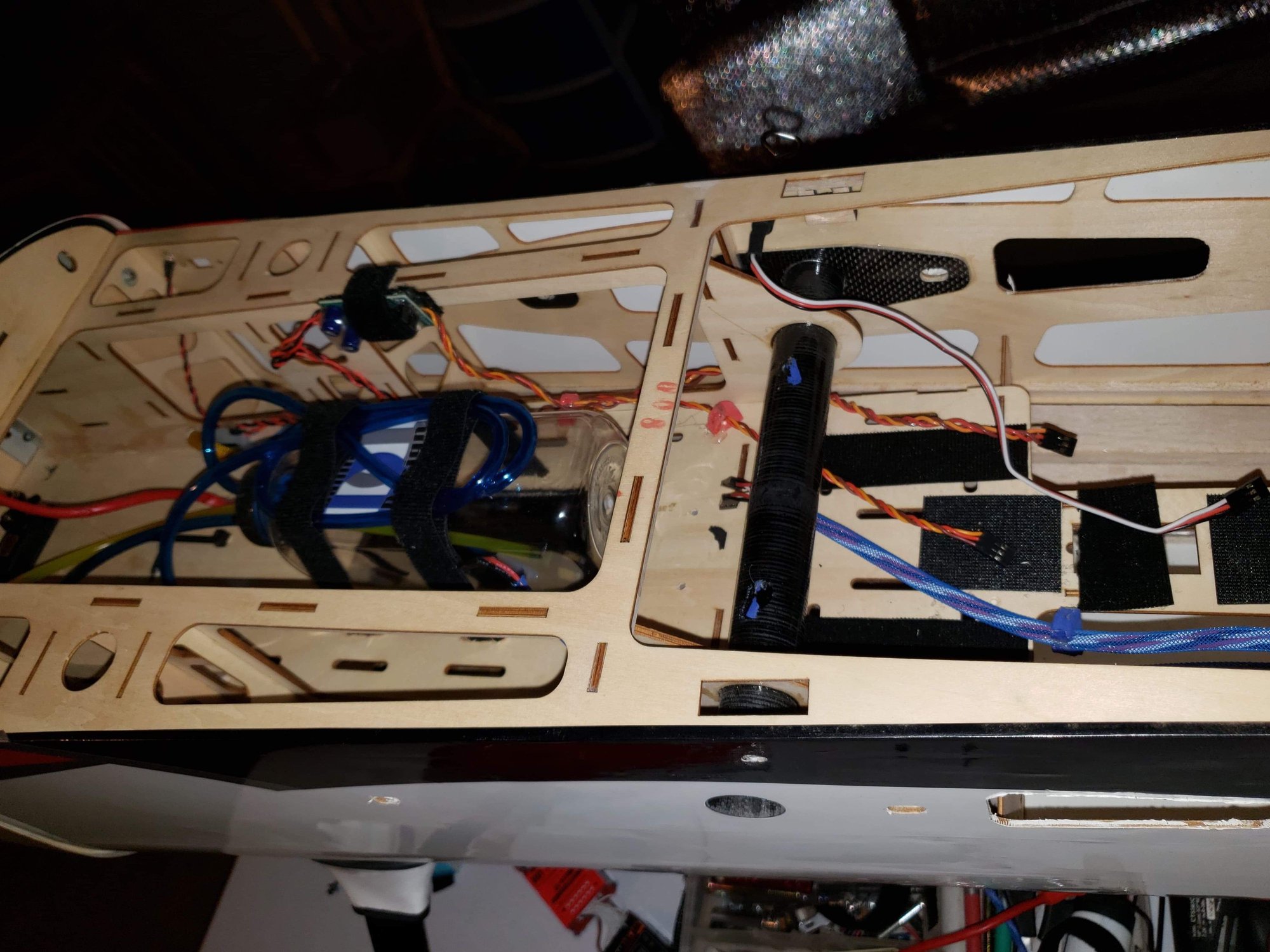

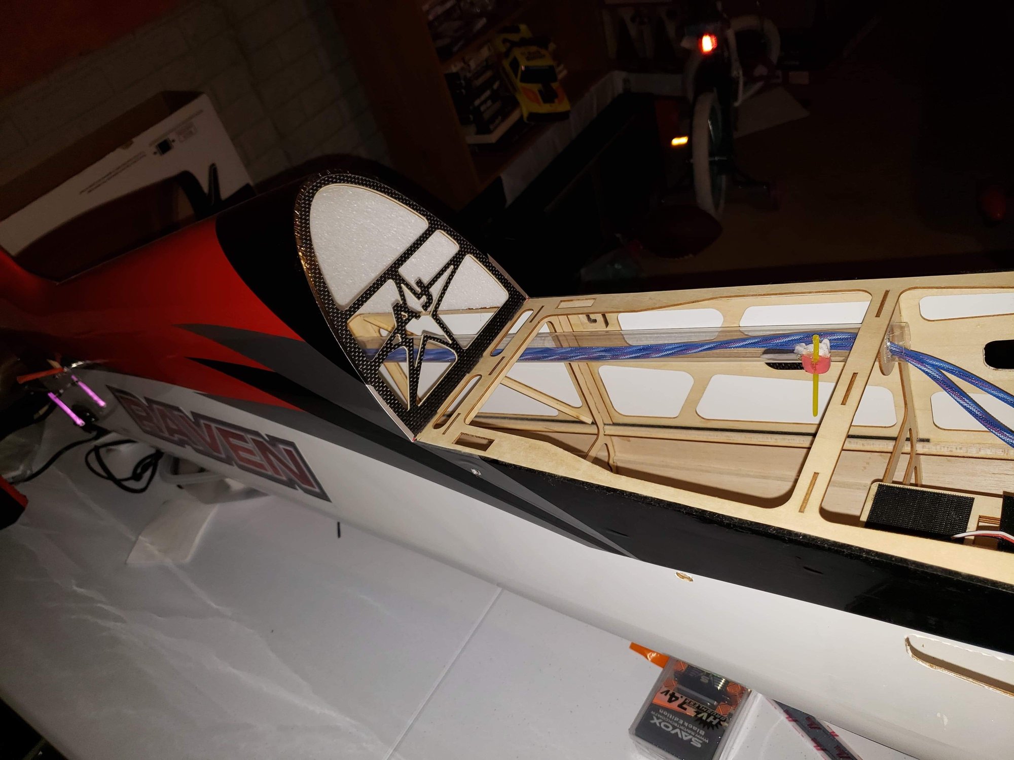

Here are some photos he sent me of the setup
