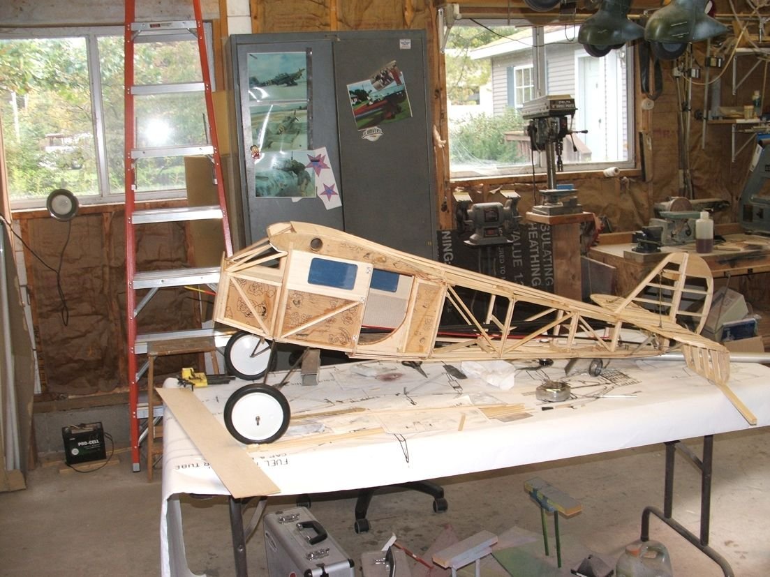

I built my Ryan Brougham from 3 views which were printed out to my desired scale (1/5). I don't feel that "full size plans" are necessary. The 3 views provide the accurate outline. All that was left was to shape parts to fit in those outlines.

of fuselage construction being built over printed 3 view.

Nice job! But I think he was talking about full scale plans. And how he could down size them.

My point is that full size plans are nice to look at but are cumbersome to deal with when building a scale model. 3 views provide the needed outlines. The model airplane parts are just that, and don't require full sized plans to design them.
