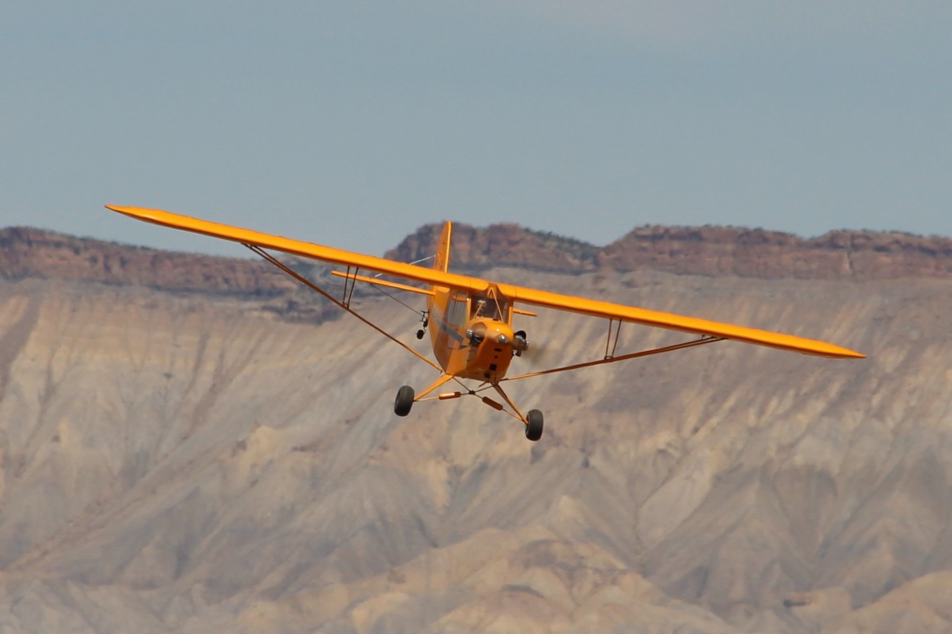

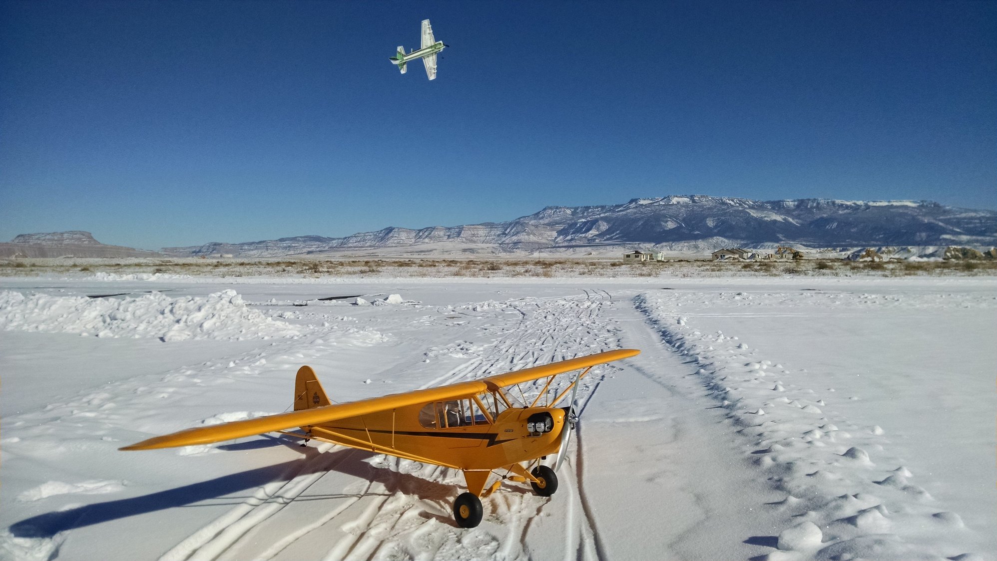

I have a sig 1/4 scale cub that I fly with an OS gt22, I have a friend with the same kit with the 160 twin OS in it, his has more power than mine but both fly well. my plane has over 400 flites and countless touch and goes, his has probably 200 or more flites. Both planes weigh about 16 lbs

Looks cold!!!

As in no way am I flying that day cold!!
