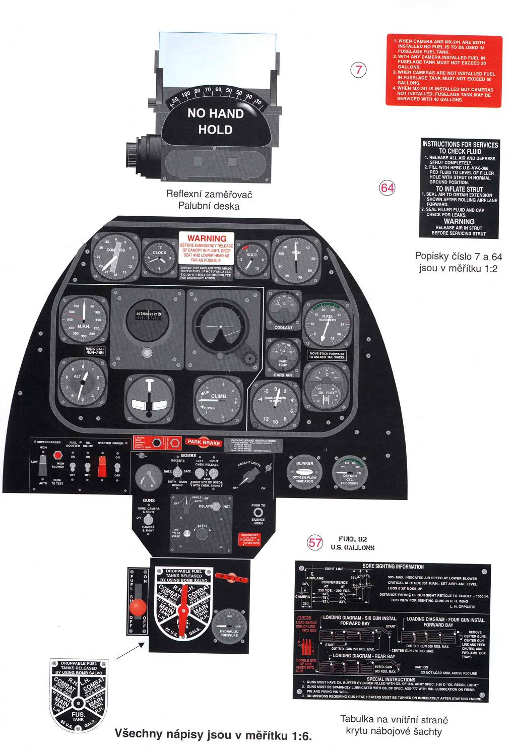

Leroy Gardner
Join Date: Jun 2009
Location: Idaho
Posts: 2,285
Received 6 Likes on 5 Posts
Default RE: top flite p-51 giant scale build
Don't forget to use spring centering when retracted or the wheel can and does hang up when deployed. Heres some picts. of my build. it's getting a paint job and I'm waiting for the graphics ( decals ) from www,aeroloft.com so I can lay out the pannel lines and rivet detail. It's going to be finished in the Cripes Amighty 3rd polished version. Plane will not have any exposed switches, charge ports or air fill port.
Enjoy, Leroy

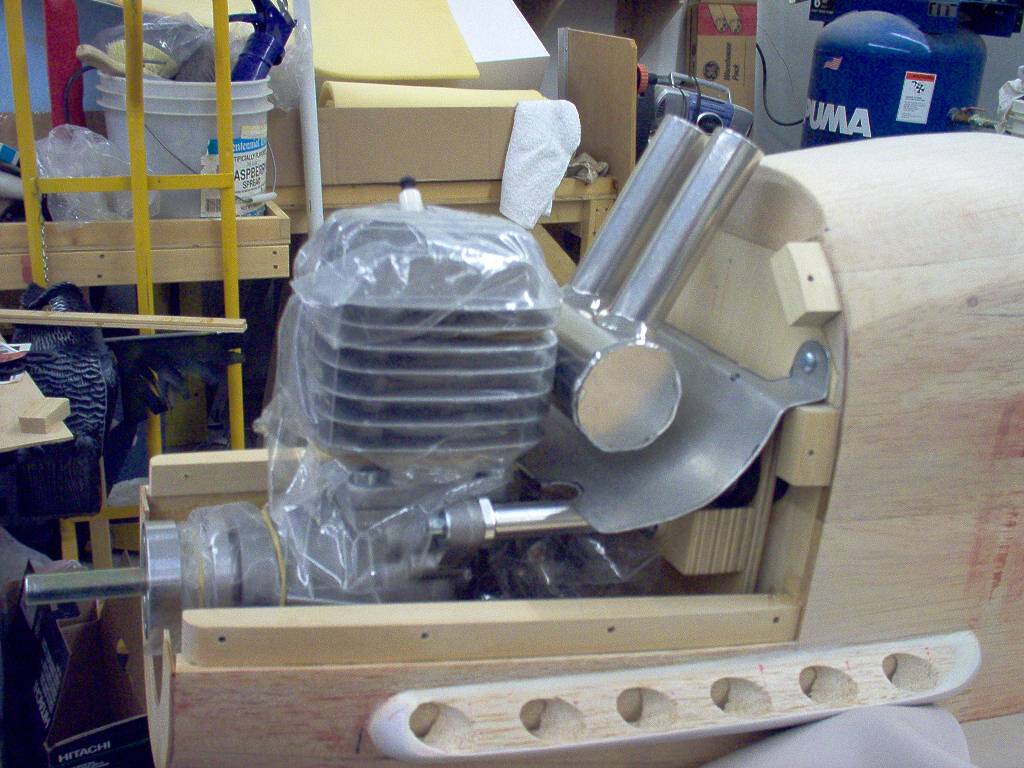

I HOPE I'M NOT TO LATE. The DLE 55 is going in mine and it's about a pound lighter than the US 41 shown on plans so get all the batteries, ignition and other stuff up there with reciever just above front of wing. Because of that this is what I did to mine Leroy

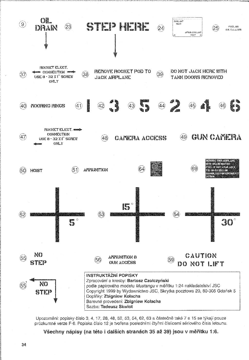

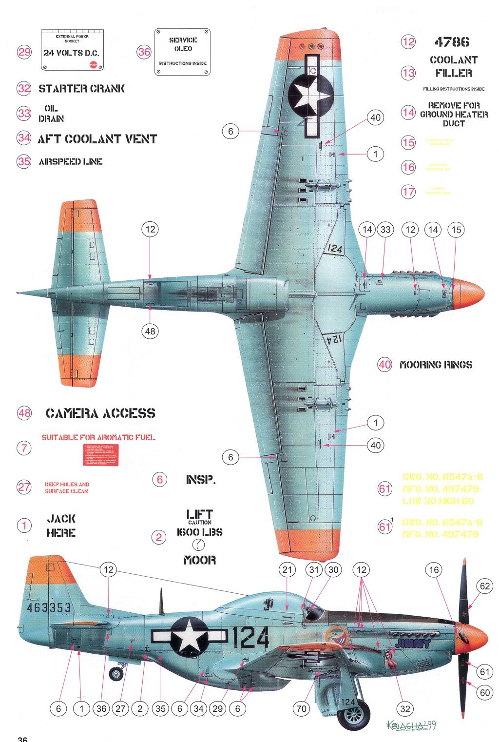

UPTON & JIMMYTHEESGLE. Maybe I don't have the right soft ware because I can't bring your pict's up. I'd like to see them,[&o] Leroy
Old 05-24-2011, 08:47 PM
  #1507
GSNut
My Feedback: (8)
GSNut's Avatar
Join Date: Mar 2002
Location: Thornton, CO
Posts: 710

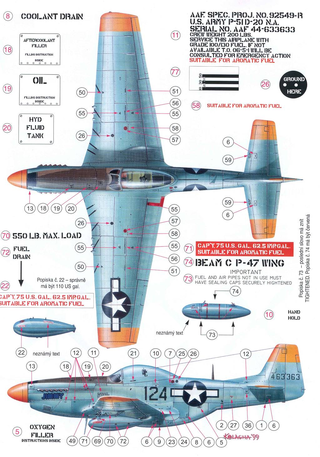

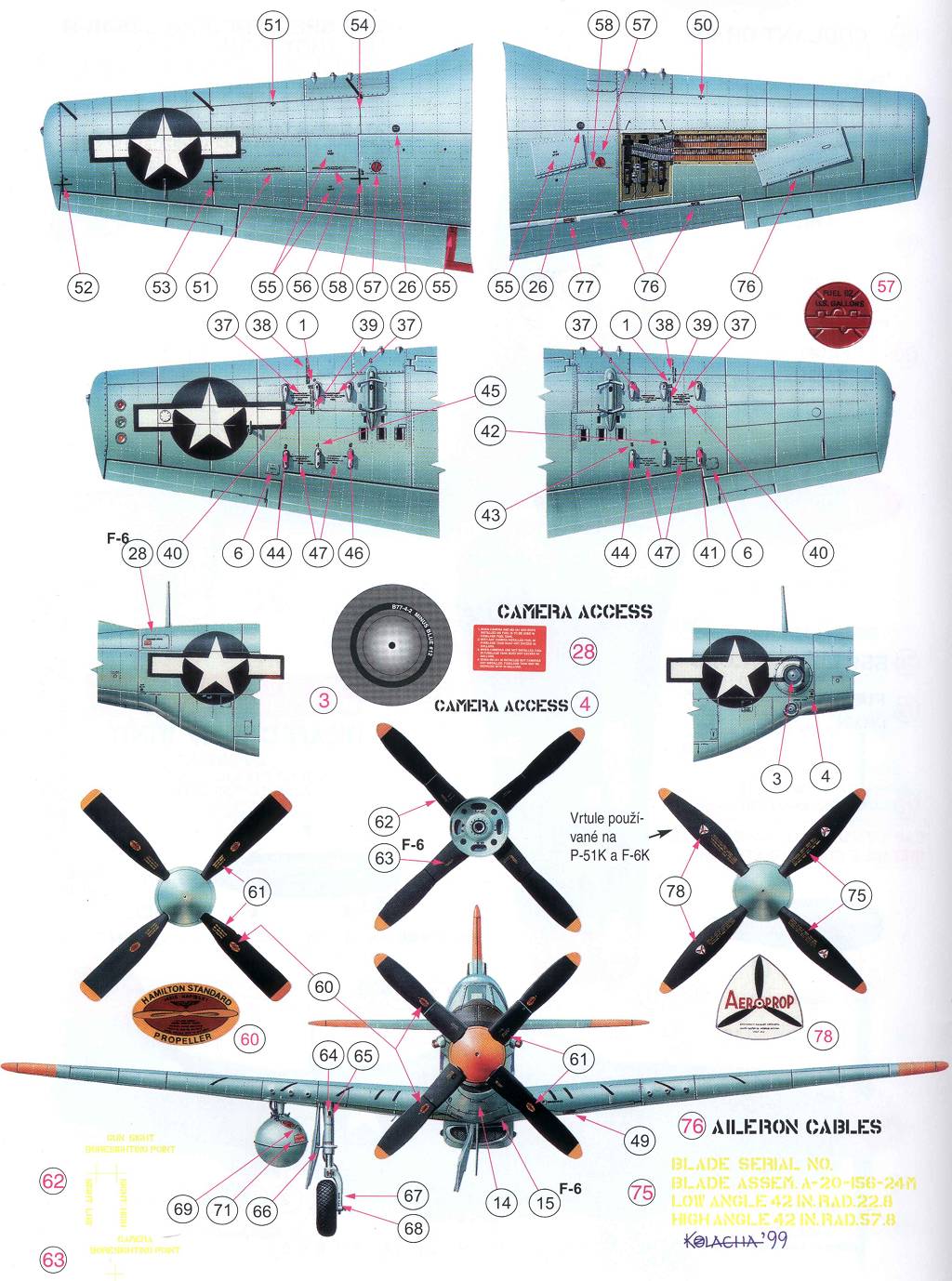

I will try to load what I have on the placement but don't know if you can blow them up enough from this page. Click for full size and Look for the Expand button on each page in the lower right hand corner. Hope that is what you were looking for.
DH

GSNut, thanks for photos they show very well when blown up. It's a nice illustration you posted and I'll use it. thanks again Leroy

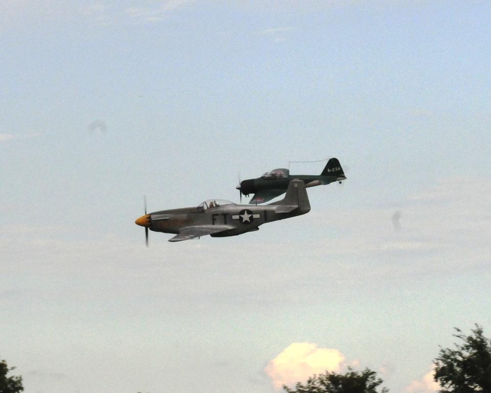

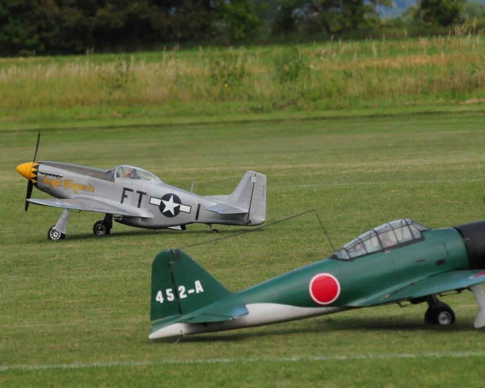

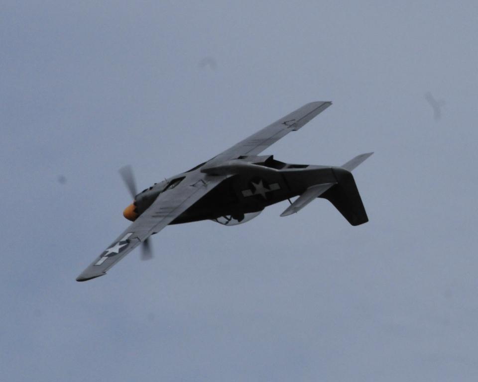

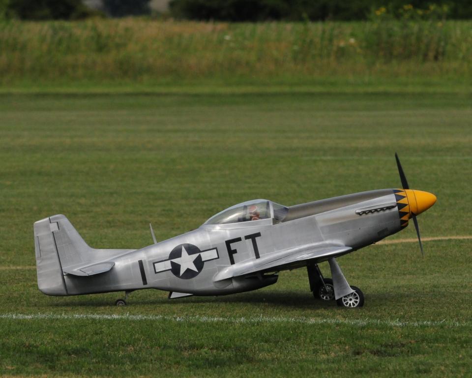

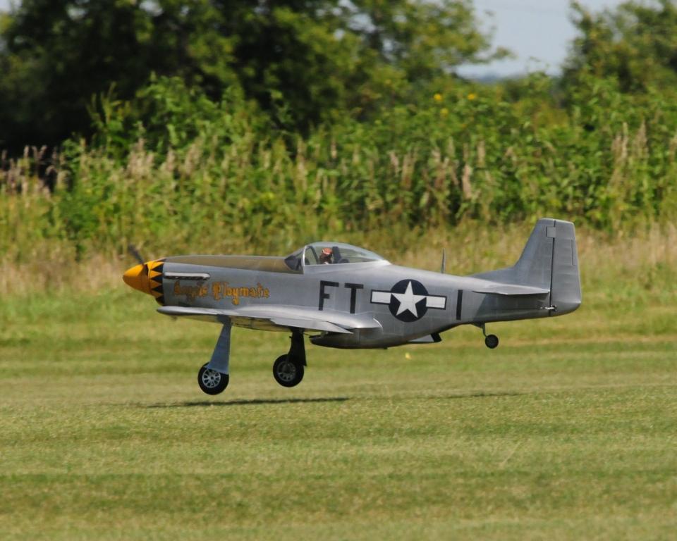

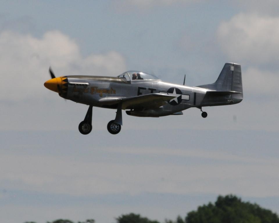

Just completed my second season on the Top Flite P-51. Here are some pictures. Flys GREAT. Revo 52 Engine still awsome. It has been clocked on radar at 114mph straight and level.
Hope you like,
Karl
