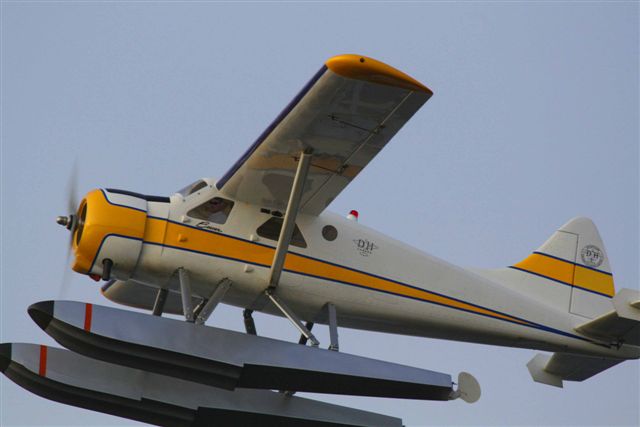

The lakes where I am have turned back into "liquid" after the winter and now time for float flying.
Presently flying a DHC-2 Beaver, see attached pic.
Sure would like to have a Tmmy Cessna to add to the fleet. Just have to figure out the float issue !!!!

Beautiful Beaver!!!!! I just got back from the Joe Nall & they had a 180lb all metal Beaver with a 400cc Moki 5 cylinder radial that was shipped from Germany. As far as the 152 build I will not be posting any pics of the build as I have stopped & started that project over the past 10 years & currently I'm in stop mode.
Saul

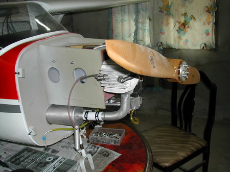

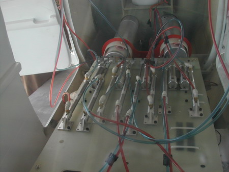

Hi Saul;
Thanks for the comment re the Beaver, it's a pretty good flyer now but did require a fair bit of trimming.
Sorry I missed the large metal Beaver, I know the one you are refering to. I followed that build for a while. It was built by a German fellow, Harald Mueller. Harald owns his own metal fabrication business and has access to all the CAD programs and laser cutters etc.
Outstanding craftsmanship and knowledge to produce the model. His web page is www.mhm-scale-aircraft.com, he has two videos of the model plus numerous pics of the build.
Still deciding between the Austar C-182 and TMMY. (Both have pros and cons).
Was reviewing the pics of the Tmmy, C-182 and wanted your thoughts on the canister installation for the 3w 157. I would like to use a canister system as opposed straight mufflers due to noise. However, most models that I have built of this size with canisters requires an area to exhaust the heat. I e-mailed Tommy who sent me a few pics of the installation however it looks like the heat is contained in the cabin area.
(see attached photos)
Didn't want to start cutting holes in the bottom of the fuse.
With no outlet I'm sure the heat would be significant. The model in the pic also used hydraulics for the surface movements. I would use straight servos of a size that would suitable for each surface.
Let me know your thoughts on the heat issue re the canister system.
Regards
Randy

RE: TMMY Scale Composites 35% scale Cessna
I agree with you on the servo use for all the control surfaces. I had no idea he had installed hydraulics. That is pretty cool though that Tommy was able to engineer that type of system. It's the 1st time I have ever heard of an R/C model using hydraulics. I would ask Tommy if the plane can be flown with servos or does it have to use the hydraulics.
As far as the canisters are concerned, as long as air is passing over them, you don't need to cut holes in the fuse as long as you use the type of canisters shown in the pics. All most half of the canister sits ahead of the firewall so it is being cooled by the air passing out the bottom of the cowl. If additional cooling is needed all you need to do is create some holes in the firewall just above the canister opening. With those canisters shown in the pics most of the hot exhaust is exiting out the front of the canister. The rest of the canister is there simply to deaden the sound. It is my understanding that with those types of canisters you really don't need to provide extensive cooling there-by negating the need to carve up the fuselage.
Keep in mind that if the Austar 182 is not set up for cans you will have to to a lot of mods. More & more R/C fields are requiring pilots that have planes w/ gas engines to take steps to decrease the noise levels. At least the TMMY 182 is canister ready which will speed assembly. Furthermore, it is evident that the aircraft was designed for cans & this is important to keep in mind because planes that are not designed for cans & have to be modified to accept cans become nose heavy which ultimately affects flying characteristics.
Saul
Saul

Hi Saul;
Thanks for the info. Had contacted Tommy who indicated that the model was experimental re the hydraulics. It can be flown with high torque servos.
Also asked him about the heat re the canister system. He indicated that there wasn't that much heat inside the cabin but did mention he would recommend an insulating floor panel over the cans due to the cockpit interior. Don't know if he boxed it in. Certainly didn't want to start cutting into the fuse.
Most models of that size that I'm familiar with have the heat exhaust holes in the bottom of the fuse if the cans are boxed.
The issue of noise is certainly a concern at many flying fields today thus the reason for cans instead of mufflers.
Agreed, re the Austar model, I have a Zenoah G-62 that I believe would fit in that model, stock exhaust etc. Alot of work to re fit for cans.
The Austar C-182 is a good sized model plus I can presently get floats that would fit it.
However the Tmmy model is certainly intriguing due to its size, appearance and opprtunity for builders colour selection and paint scheme etc. (Lots to consider).
Regards
Randy

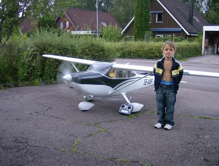

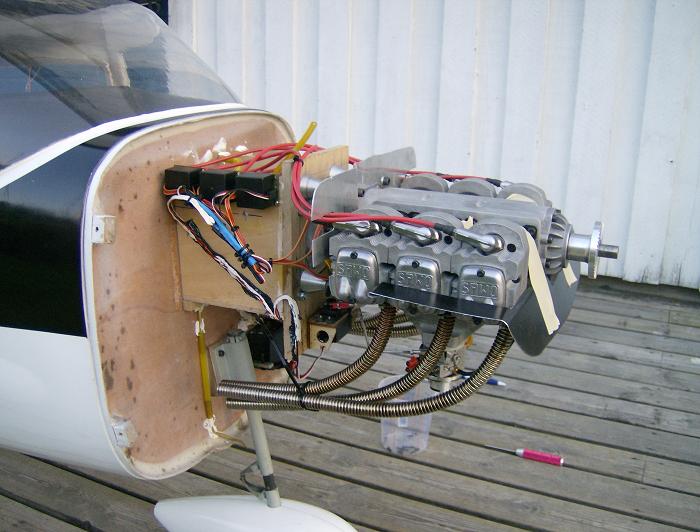

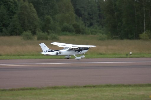

Hello.
I am the ovner of the big Cessna 182.
Its fly like a 40-trainer or better. In 2007 I hawe 3 flights whith it.
Its hawe a 4-cyl boxer 150cc gasoline.
www.sawo-motoren.de
No he bilt a new engine foor mee. 6-cyl boxer 225cc.
If you like to now enyting abote the model you can email me.
[email protected]
Reg. Johnny.

Hi Saul;
Was thinking of getting the model soon, however still "hung up" on a few issues.
1) Cooling set up of the canister system for the 3w 157. As previously mentioned keeping the cans in an enclosed area with no air going over the cans and exhausting has me a little concerned re heat build up and over heating of the engine.
My supplier of 3w also took a look at the can set and indicated there should be about 1" opening around the can to get air into the cabin and then a 4"x6" opening in the bottom of the fuse.
"Ouch", that's what I didn't want to do on a scale model.
2) The other was selection of engine. I know the prototype was flown with a 3w 157 however Johnny from Sweden indicated his 150 may be a little under powered and will be installing a 225 cc 6 cylinder box engine. (Nice engine).
3) Manufacture and shipping dates, but that would be confirmed by Tmmy.
4) Would purchase it in primer or plain white, I think there may be some touch up along the way etc.
Will keep you posted.
Regards
Randy
