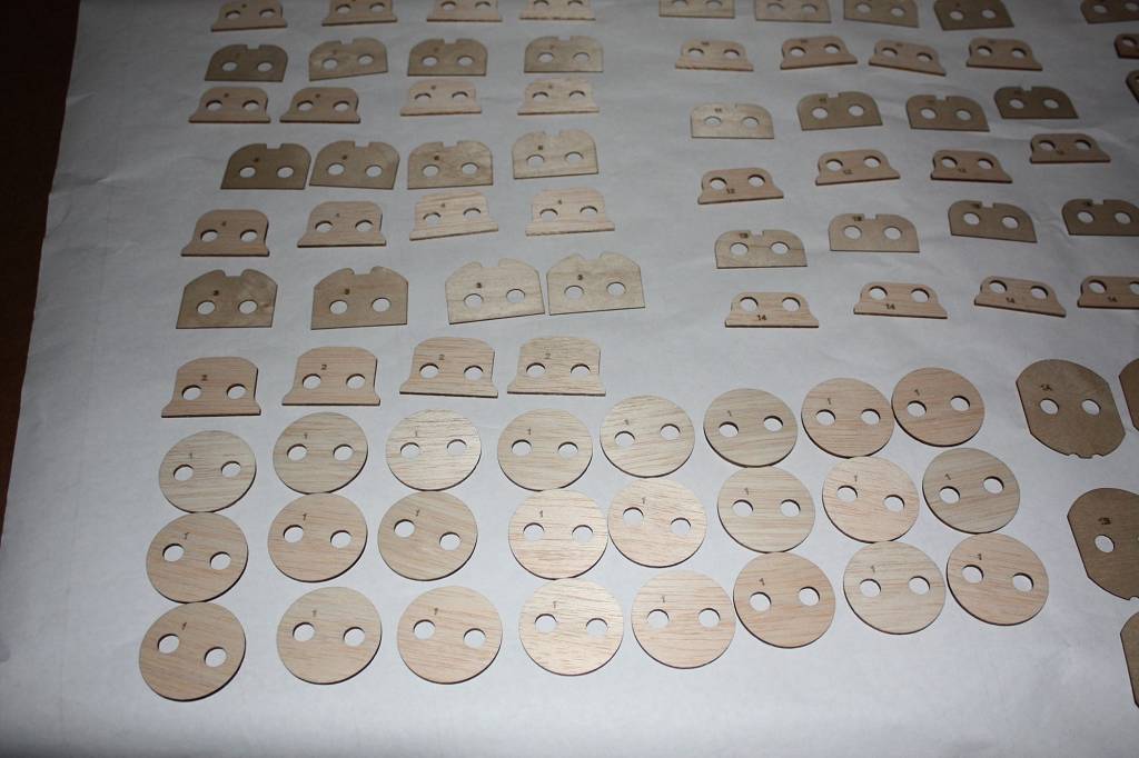

ok my dummy engine kit is here

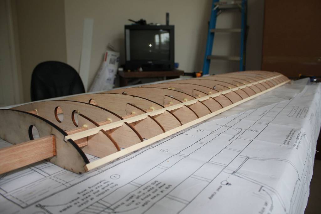

The building has started first thing was to build a staight wing Jig The plans where not square

Here what I got done

Did not get much done today But here are a couple more pictures of what I got done today.

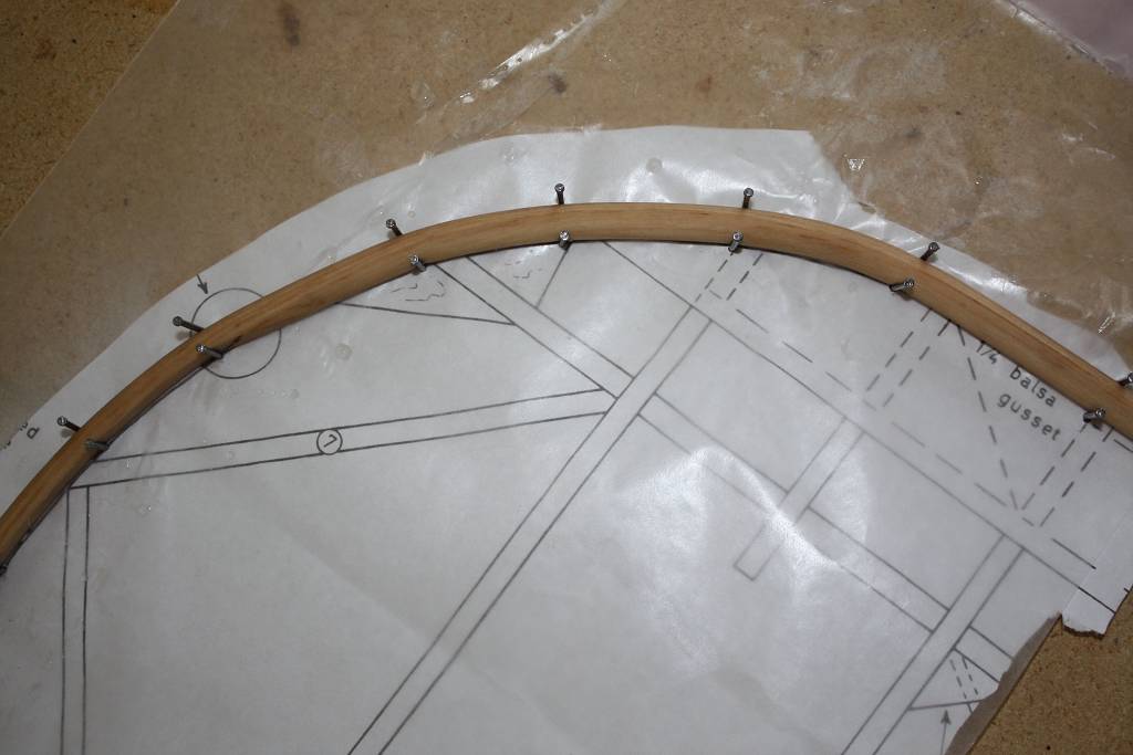

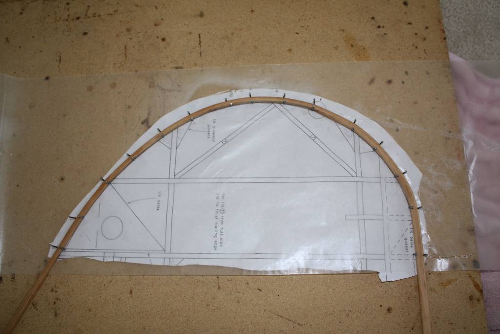

Ok soak one of the 3/8 dowel that I cut for the wing tips and made a jig. The dowel bended real easy into the jig. I am letting it dry overnight and will install it tomorrow.

Hi Billy - good job.
I did it with nails as well when I built a 1/4 scale version, but found that when the bends had dried, that there were a bunch of dents from the nails in the outer edge of the dowels, which of course meant filling and sanding.
So this time on the 1/3 scale version, I cut a form out of 3/4 ply (An inner and an outer of the tip shape etc., and fastened them 1/4" apart) - I then had a 'slot' to push the wet dowel down into, and bingo, no cracks, and no nail marks. And both wing tips etc., fitted into the same slot at the same time!
Just don't take them out till you're ready to use them - they do want to spring back some...
Cheers, Mike

Hi Mike
Thanks for the for the info and you are right about the dents I can see them already .Can be fix, live and learn .

Hardwood from hardware store - just soaked it all for a few days standing upright in a piece of plastic plumbing pipe with 2 closed ends.
No bending issues.

Yes any hardwood ,I used BUSA because I wanted 48" dowels and all the hardware had was 36" I soak my in a tub hot water for 8 hrs like the insturtion said about every 30 mins I would add somemore hot water work great. I am building a wood streamer out of copper tube and 3" pvc .Will be able to stream it for about 1Hr and shape the tight bends for the elev and the rudder. I will post pictures of the streamer after it is build and tested.
