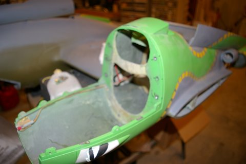

I bought a 114" P-38 from an estate. The people selling were not RC folk, so not much help from them regarding the pedigree of the plane. I am fairly certain it is a Robart product, when they built the entire H section from glass. While it looks nice, I have determined that it never was flown ... at least in the condition I found it in. Some other intel is that local folks say the original owner flew a couple P-38s, but not so successfully, and that this one might have been involved in a crash.

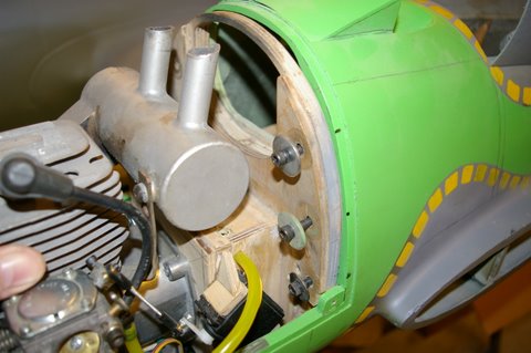

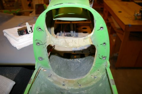

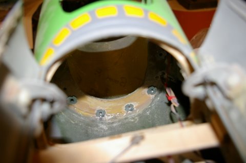

I'm reworking her from stem to stern, and am involved with the engine mounts now. I've got a fair amount of experience with large engine installation on 3D birds, but zero with composite construction like this one. I've attached some photos of the "firewall". There is a 1/4" AC ply bulkhead that is very open, and the edges are glassed very well into the fuselage structure. The design, as it stands, is that a second engine bearing assembly which includes a second firewall of 1/2" thickness, is bolted in ten places to the smaller thickness firewall (10-32 sockets heads into blind nuts - I'm not a blind nut fan).
The question - do you guys think this is robust enough for a G62 (which is what is in this plane). It seems to me that the smaller firewall would stress that glass a lot with the engine vibration. I'm used to engine boxes that carry back into the fuse structure to spread the load. However, I know there are lots of large glow engine mounts just like this with far less fiberglass thickness that work just fine.
Anyone have experience with this configuration?

Seems like a fine solid set up to me,
and I use blind nuts all the time. The blind nut in there help keep the vibration from wearing enlarged holes in the wood.
Only thing to remember is crank them down hard and back-up all those 10-32s up with a jamb nut or they will shake loose
good luck

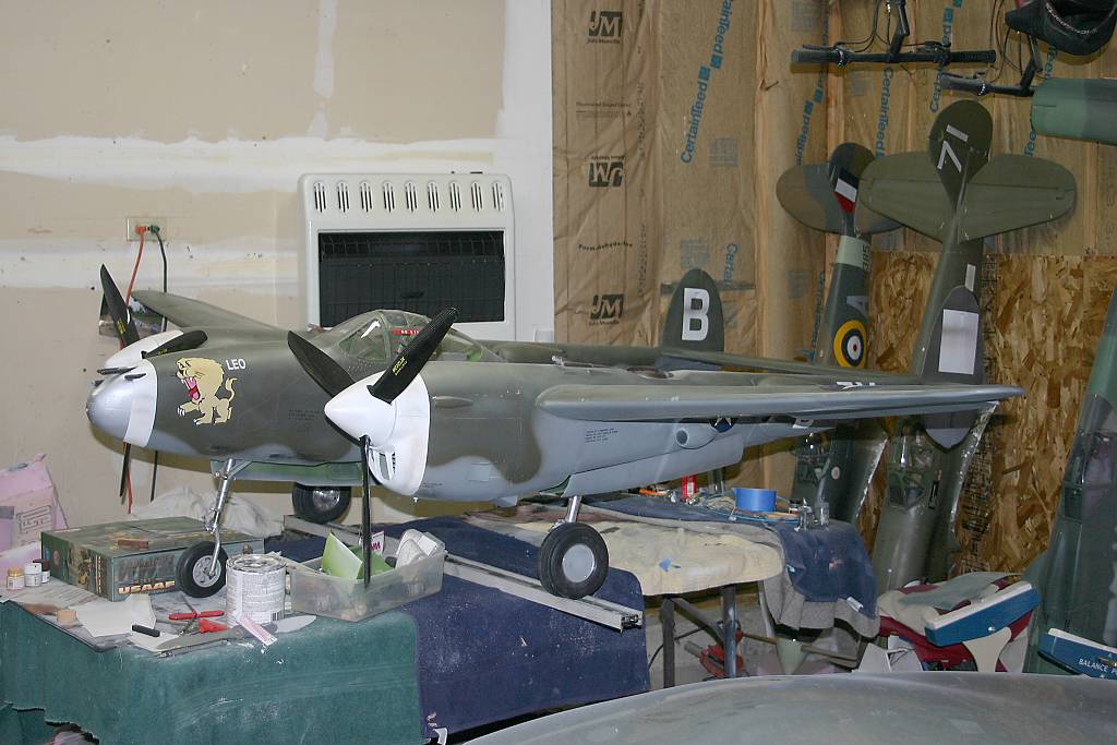

If you haven't already purchased G-62s, you might consider a pair of DA-85s for your Robart. They fit nicely in the cowls and weigh about the same as G-62s. I've installed a couple of 85s in my newly built Robart 'cause I wanted to turn near scale props ( two Mejlic 24-12W 3-bladers). If you find G-Pete's thread on his Z P-38M, you'll see he has successfully flown his model with 85s and he appears to be quite happy with the result.
I really would not worry about installing G-62s if that's what you want. If anything, on the Robart 38, I'd consider '62s the minimum powerplants to get good performance out of the model. This is because the Robart 38s DO come out a bit heavier than the Ziroli's BUT you do get a much stronger bird for the extra weight. While I haven't flown my 38 yet, I know a couple of Robart 38 drivers and they have indicated this model is the BEST flying giant scale 38 they own / have owned.
Here's my Robart just out of the shop....
