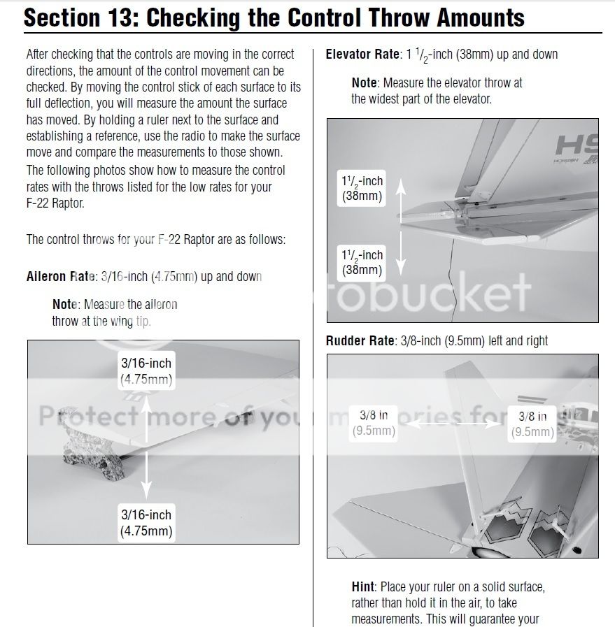

Okay,
In similar manner the user manual (perhaps an updated manual) lists three options for flaps. This of course pertains to the modification I am about to do with Elevator halves.

Guys,
I had an opportunity to measure the UP Elevator Deflection on each Elevator Halves and was horrified to witness that the LEFT Elevator Half has 1/2 inch more than the Right Elevator half.
This certainly caused the model to ROLL to the Left on each LOOP attempt and certainly caused a stall way UP high and subsequent spin.
I will try the least expensive and less intrusive solution to the issue by disconnecting the clevis at the Right and see about increasing the RIGHT Elevator Travel while decreasing the LEFT some as well.
Old 10-26-2015, 04:08 PM
  #28
guapoman2000
guapoman2000's Avatar
Join Date: Nov 2003
Location: Orlando, FL
Posts: 1,792
Received 7 Likes on 7 Posts
Okay guys,
Got down to get her done with the required adjustments and it turns out that I will not need to add another servo for making Elevator Halves with their independent servo. I did go to the Hobby Shop and bought the Reversed JR SPORT ST47 (Part Number JSP20050R ), however, I will not be needing it since I was able to perform the adjustments at the control surface clevis end.
Additionally, during the 2nd landing the Nose Wheel steering quit working and the Keeper just came off from the Rudder Servo Arm so, I didn't have any plastic lock to match the size diameter of the keeper I am using so, I used a Wheel lock collar and worked like magic.
Also, I activated the model and double checked (Verified) that both Elevator Halves were matched for the entire travel and at every level including when it is at neutral.

This is perhaps my first RC Airplane Model that has a tapered trailing edge Elevator and for me was illusive for my eyes. The Elevator Halves looked okay when operated during my initial checks. My thoughts that the model had previously flown using GLOW power and the Elevators should have been setup properly during the previous owner, right? How WRONG that thought was! It may explain why (Chad) sold me the model as it looked pretty NEW!

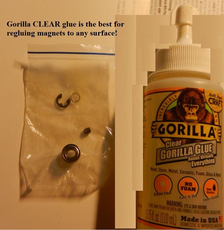

Okay,
I can honestly say that I almost changed out the motor (Emax BL3526/04) a 860Kv motor with very good specifications that allows up to 5-Cells (18.5 Volts nominal), however, I found a few articles on how to glue back in the lose Magnet from the rotor (rotating bell housing) that contains all of the rotor's magnets.
https://www.google.com/url?sa=t&rct=...-71QEmCs4mYerR
This was possible because after careful disassembly I found ZERO damage inside the motor and inspection was possible using 30X times magnifying glass (Hand held). The Stator's windings at ALL Poles looked great and sounded great on subsequent test run.
After allowing the Gorilla "Clear" Glue to cure all of it's 24-hours as specified per instructions the motor test looked and sounded very good, like new. I am sharing a few pictures of my model's issue with this motor and I will be now going to fly it with the GForce Elite Series 4-Cells, 4000mAH, 30C Lithium Polymer packs.
