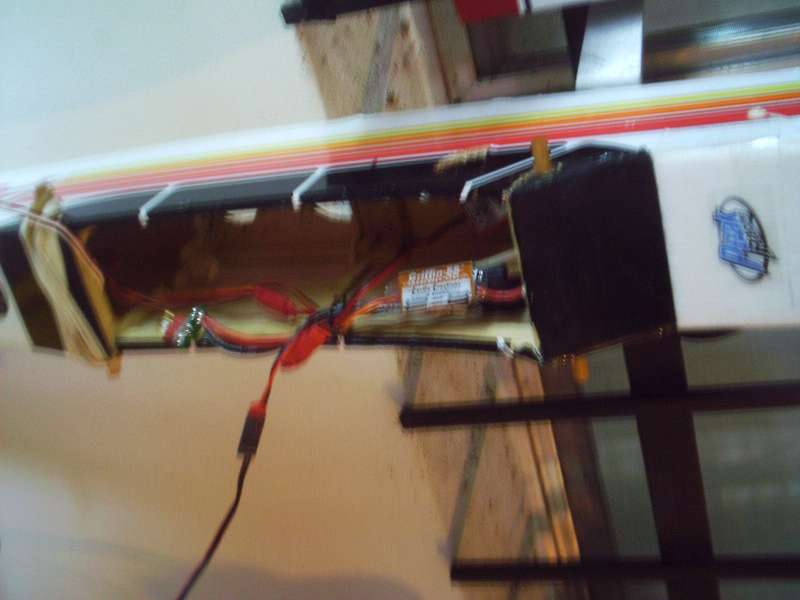

My dad is at it again. He is converting an Avistar to fly on a brushed car motor. He really likes using that whatt meter I got him for his B day last month. For best results on this type of conversion see Guapoman2000's conversion on RC groups http://www.rcgroups.com/forums/showthread.php?t=215044 He is an inspiration to us all
Whatt my dad is using, or is that what he is using.
Avistar .40 Trainer
Peak Performance Panther 17x2 Brushed car motor
GP 3:1 GB
12x8 and 14x7 props
8 Cell Electrifly 1900 SCR pack
30 A Electrifly SP control
GWS 4 CH reciever
2 standard Servos elevatror and alierons
HS 81 MG for rudder
Avistar .40 Trainer
GP 3:1 GB
12x8 and 14x7 props
GWS 4 CH reciever
HS 81 MG for rudder

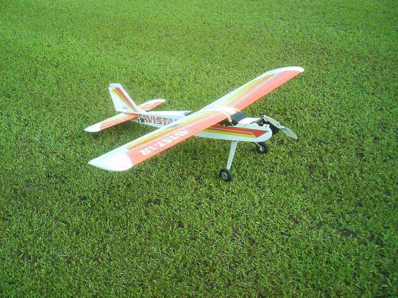

Hey everyone,
Flew the Avistar today at 0800. The take off roll was a little longer than expected but it got in the air. I flew it for they projected four minutes. I was able to do three loops and one roll. The plane lost too much altitude in the roll and I waited too long into the 4 minutes too try another. The landing was un eventfull. I have only one 8 cell pack so I flew the E-Magic for a while then trimmed some trees at the end of the field. I planned to try a 10 cell pack later on today since I'm off, but it started raining as soon as my 10 cell pack got charged. Rain all summer and blow all winter.

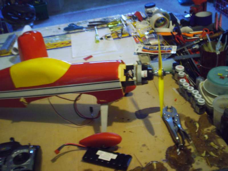

Hey Guys!!!
My son set me up my own screen name. I don't have to intrude on his space anymore.
I got off work a 0300 this am and couldn't sleep so I did some static testing on my Brushed Avistar conversion. With 12 volts of 3600 mahs, thats two 1800mah Hecells 10 packs. W 14x7 prop the thing was too hot at 49Amps and 393 watts. With a 12x8 it was doing 42 A and 363 watts. Test flying tomarrow if I can beat the weather.

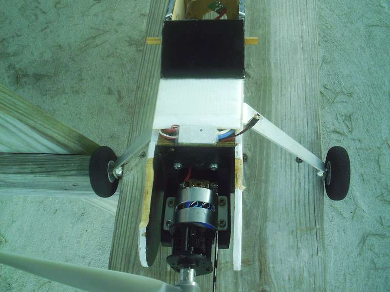

I had to go to Orlando this am to take a test for my job. The toughest test I have ever taken. Good news is that I passed. I hope I get a raise. To celebrate, I went to Graves RC and bought a Endoplasma motor for my project. They matched the $19.99 TH price. I also picked up a 12T pinion. They did not have any 10T's. Got home in time to change out the GB and get in a test flight an hour ago. A slight breeze was coming from the up hill side of the runway and the take off roll was 50 feet or more. The grass strip is very wet. Eight cell climbout with 12x8 prop was okay but not as good as I had hoped. Flew for about 5 minutes then came in for a splash down, I mean landing. Motor was not that hot and no cut out problems. I want to try a 14x7 prop on the weekend when my son is here. I'll post more pics then.
3d&p's dad
3d&p's dad
Join Date: Aug 2004
Location: Sebring,
FL
Posts: 388
RE: Avistar conversion
Guys
I survived the hurricane. The fields safety fences did not. After fixing three of them this morning, I took time to fly the Avistar with the 14x7 prop. Wonderful!!! It got off of the ground much quicker and was able to loop, roll and sustained inverted flight. The power set up is just right. About eight minutes of mostly WOT w/3600 Mah of eight cells and the Endoplasma motor.
