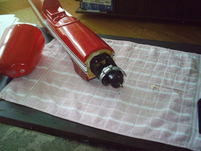

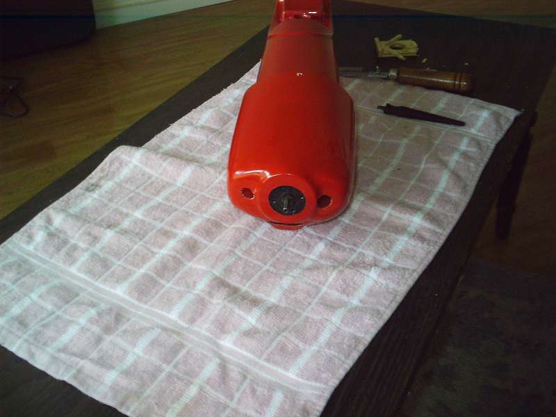

Since I had worked with this plane before I knew I had to start the conversion with making the motor, engine mount and cowl line up correctly.
To do this I first removed the wooden firewall extension.
ID:	171321   Click image for larger version
Old 09-08-2004, 06:06 AM
StephenT
Join Date: Aug 2004
Location: Sebring, FL
Posts: 388
Default RE: Modeltech .25 Extra 300 conversion
Next you need to center a Great planes .40 MM over the hole in the remaining firewall. The Jeti motor is then strapped inplace with a hose clamp. The back of the motor is one inch from the MM base with the adjustable mount closed all the way. The motor can be slid fore and aft to get the alighment you prefer. This will center the motor with the cowl when you attach it. Consult the airplane's manuel for cowl attachment.
ID:	171323   Click image for larger version

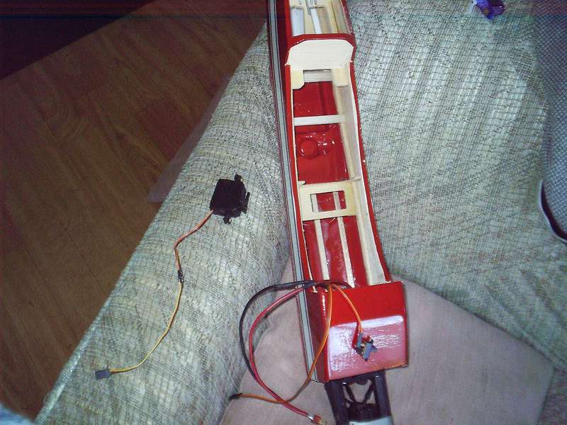

Flip the fuse over and remove the throttle servo mounting tray and cross brace. This reduces a small amt of wt. and makes room for the battery.

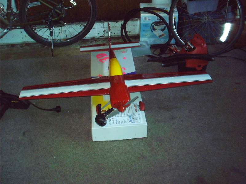

This pic shows the prop, prop adaptor speed controller and some of the batteries used to power the plane.

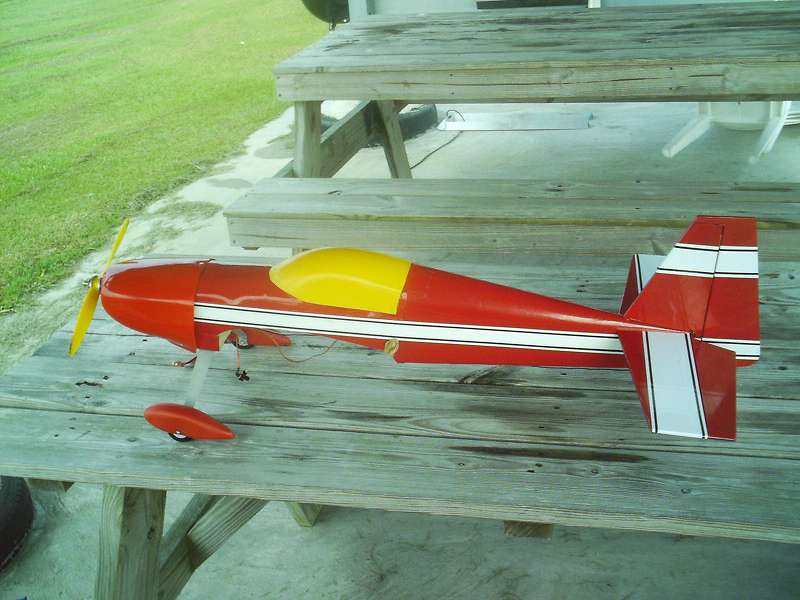

This pic shows the canopy painted yellow and mounted in place. The plan was for a yellow canopy and spinner. Can't find the right size yellow spinner yet so I will use a red one for now.

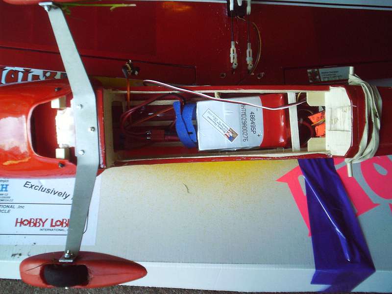

Battery placement.
here are some battery placement pics.

My plane always seems tail heavy; so, I moved the Battery forward a little. It actually flew worse. Some times it snap rolls when I try to loop. Low rates are better. I am putting the battery back to the original place.

I have reduced the throws on the Extra and moved the battery forward. Jim at the LHS said that extreme throws cause this snap effect when trying to loop. He said to move the battery forward also. I'll test it on Wed or thur. It's back to work tonight for 12 hours of healthcare fun.

I moved the Battery even futher forward. The front of the pack is to the front of the wing craddle. There is no snapping in a loop now. Landing are still too fast for me. Good inverted flight.
