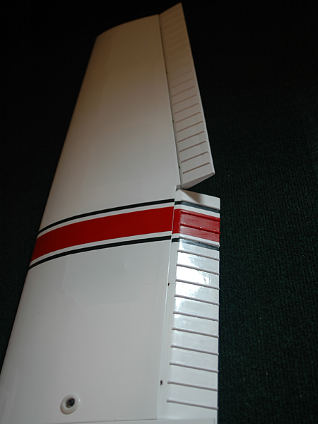

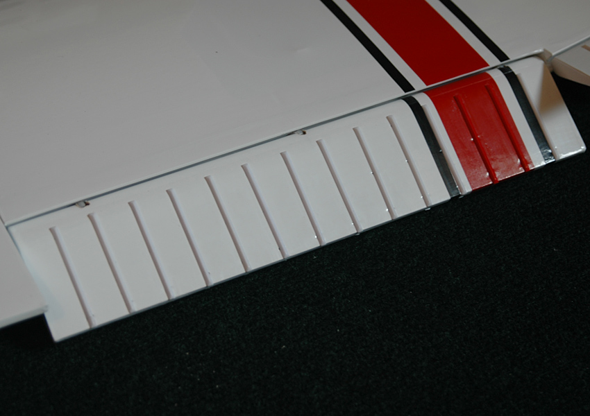

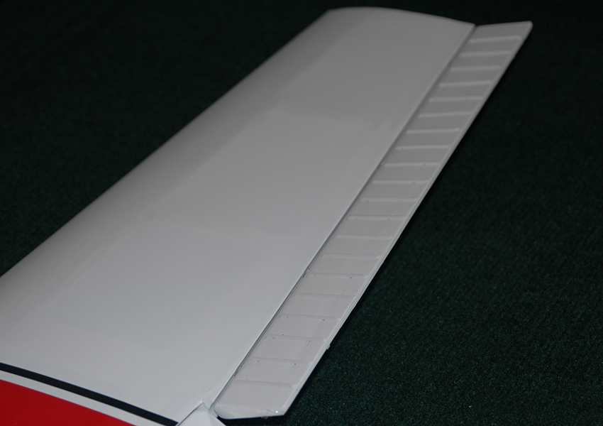

My Cessna build actually started a few weeks ago, but with work and everything I've been really busy and finding time to update things on this thread has been hard...
I finally found some time today to get caught up on things and kick this thing off with some pictures from the first stage of the build...
After opening the box, I found everything was packed really well, after reading all the instructions through a couple of times I got going on the first steps...
The first part of the build was hinging the flaps and ailerons, in the first picture you can see the detail of the strips on the flaps...
In the second picture you can see the same detail on the ailerons...
There were no surprises using the epoxy to glue the hinges into place for the flaps and ailerons, it all went quite well.
I'm not a big fan of these two piece plastic hinges but this is what came with the kit and the holes were already precut so I used them.

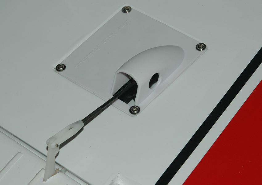

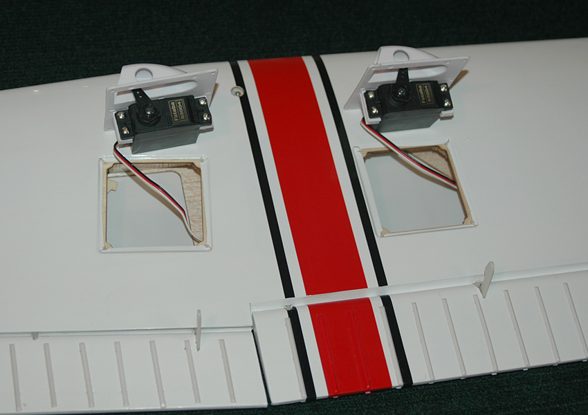

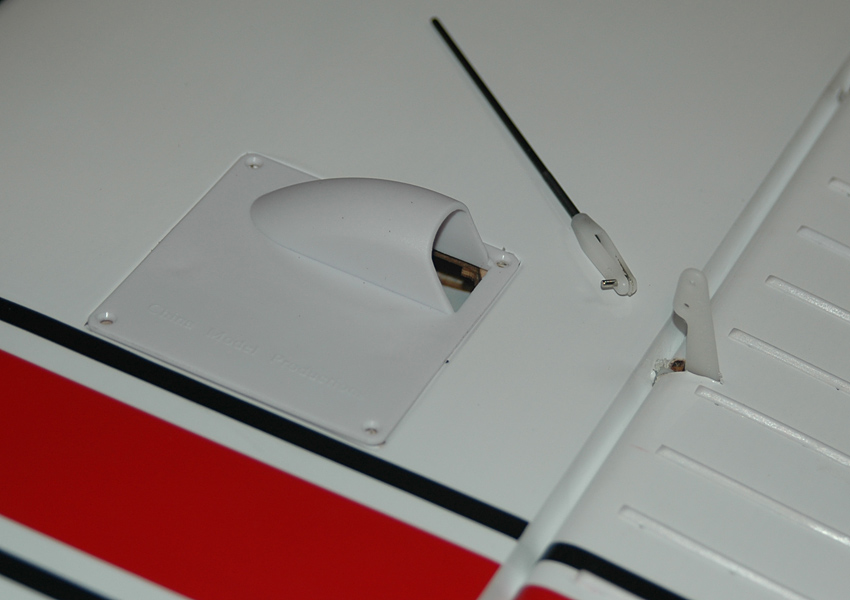

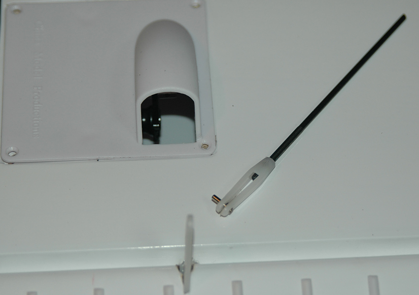

The second part was installing the four servos for the flaps and ailerons...
I used full size Futaba Standard BB S3004's
In the picture below you can see how they'er installed in the wings:
The kit has nice covers over the servos to maintain a nice scale look...
Here's one installed with the push rod cut and ready to be installed:

Here's the servos in place and ready for testing:

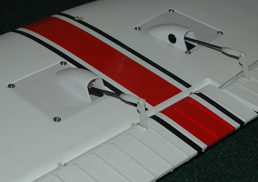

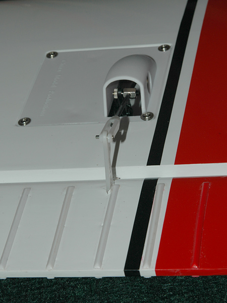

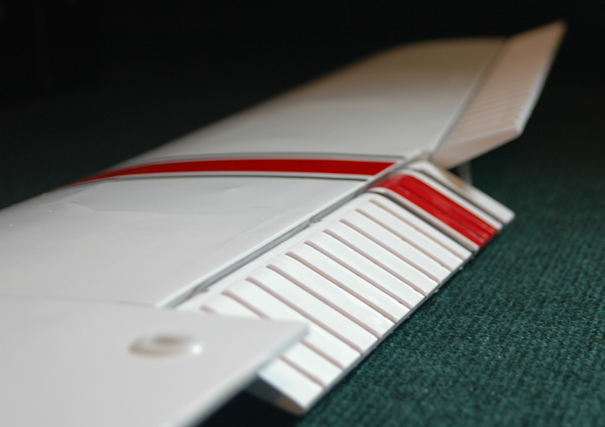

Here's a few pictures testing the maximum deflection of the flaps and ailerons:

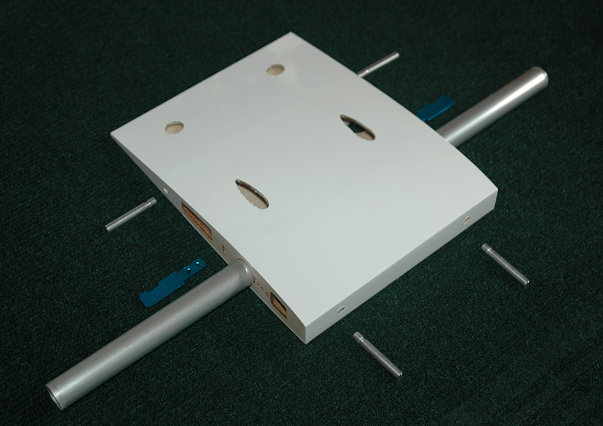

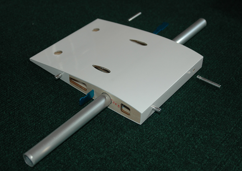

The next part of construction was putting together the center of the main wing, the kit has made this wing so it can be broken down for transport...
After looking and all the different pieces that holds this thing together I decided that after getting everything together the safe route would be to epoxy the whole wing (All three pieces) after I know everything fits nice and tight...
Here's a couple of pictures of the center of the wing where the joiners are:
Second shot shows the parts being installed:
