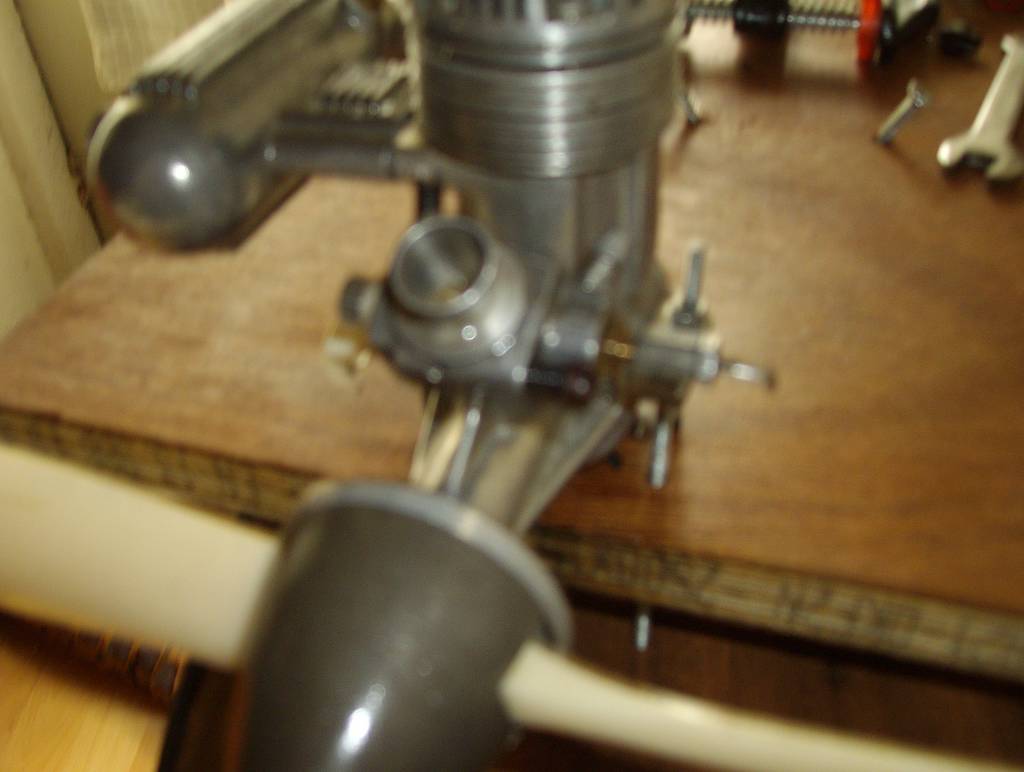

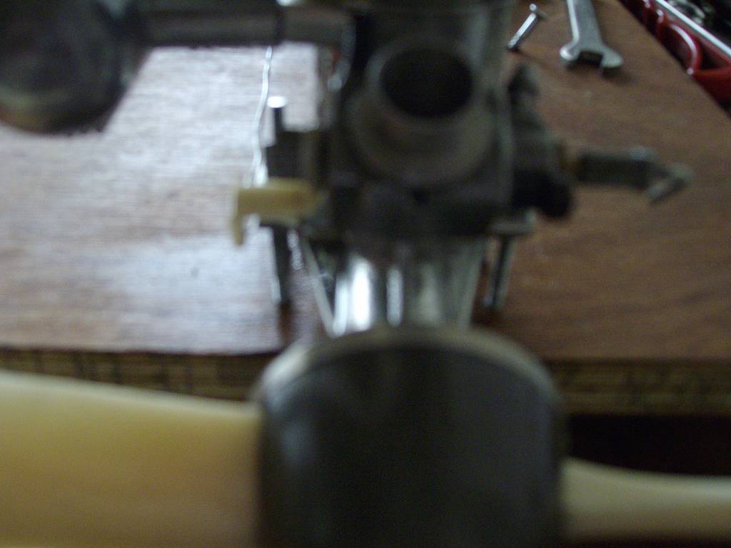

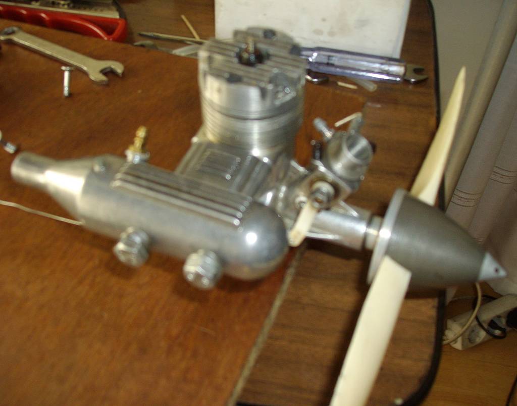

Hi to all,
this is the engine that i talk, who can tell me something about it, it starts and runs, but when i take the energy for the glow he stops, the screwthat is with the blue arrow is there for something, but i´m not sure about it.
Best regards to all,
Paulino

My first thought is that the glow plug may be going bad. I would try a new glow plug and see if that corrects the problem.
I didn't see a blue arrow pointing to a screw. But if the screw has a small spring on it, then it is most likely a idle speed screw. But it could be a air bleed screw for low speed mixture control, but it is hard to tell from the picture though.

I see the other two pictures now. Although blurry I can make it out better.
On the left side of the carb, which is opposite of the throttle arm. The large screw like thing is the high speed needle. Right in front of the high speed needle is the low speed mixture screw (it is a airbleed carb design, similar to the OS carbs like it). Now just above the throttle arm is the idle speed screw.

Hi, i´m using 80% methilic alcohol / 20% ricine oil, i think you´r wright, the glow plugs i have are used, and i must go trying the regulation of the carburator. Thank´s for the tip´s and stay well.

Your fuel looks to be reasonable. Unless the methanol absorbed too much moisture and is contaminated. But other than that I would suspect the glow plug is bad. I have had them do that before and when I put on a new plug, it started working correctly.
I suppose if you ran the engine way too rich it would drown out the glow plug too. So in that case maybe a little more lean is needed. You want to break in the engine running on the rich side, but not so rich as it drowns out the glow plug.

Oh, yes im late here...this engine is an Plain Bearing Raduga 7M, yes...
Paulino please put this engine in the trash somewhere, the piston of this thing isn't aluminum, it is cast iron and it is much to heavy.
This engine when running will shutter your RC in to parts. In a east german magazine was 30 years before was an article where the author
tried to solve this problem by making cut outs from the piston and removed as much as possible from the crank pin end of the crankshaft,
it will be run better but still is vibrating like hell. I got such a thing a half year ago with a bunch of other dumped engines, I don't even
