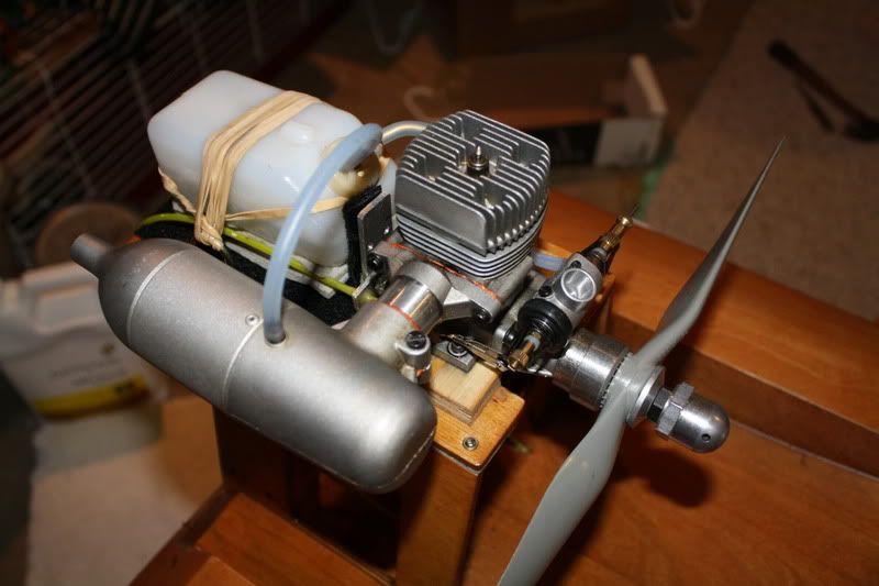

    I have an Italian S90K with the stock ST "swing" muffler and haven't had any problems with it. The S90 and G90 should have the same muffler bolt spacing. The muffler I have isnt the "quiet" muffler, as it doesnt have a baffle inside. I dont know how much quieter the quiet muffler is, but my muffler never comes loose and isnt that offensive noise-wise.
    A video of my 90 running, if you're interested. The camera geeks a little so the picture stinks, but the audio seems okay..

    I use a header with a mousse can type muffler. I use a tuned pipe mount to support the can. It will fix the muffler issue and give you a nice power boost.

    Since the muffler screw hole spacing is 47mm, any muffler with a 47 to 48mm screw spacing becomes a potential candidate. Such as the Jett 90 muffler too. If I remember correctly, the K&B .65 Sportster engines use that same hole spacing as well.

    If it were me, and stock mufflers were out of the question, I'd spend the extra $40 for the Jettstream as I think they look nicer and they give an easy 1000-1500rpm boost. If DIY is your style, a Mousse Can Pipe is the other way to go for a nice boost.
    I personally think Pitts mufflers are ugly and most that I've looked at have too little expansion volume causing either no gain or loss in performance. That's just me though.

    Just run in without the baffle. It's common for these to get a loose baffle. If you shake the muffler to get the baffle to the front of the muffler, you can twist it with a pair of long nose plyers and pull it out.
