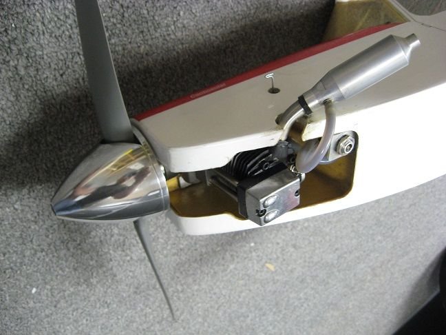

I pulled the engine out and measured distance from lugs to bottom of crankcase vent nipple then I measured distance from mounting pads to nose sheeting support stringer - difference was 1/16". I confirmed with piece of modeling clay. I removed stringer material in this area to provide more clearance around the vent. I installed a new type F plug and just got back from flying today - made one flight with it set up as before. On the second flight, I opened the LS needle 1/2 turn and opened up the HS needle some as Hobbsy originally stated, started the engine and started adding travel volume at the high end. I was able to go from 10% up to 75% before it got ragged while tweaking the HS and then the LS needle. I was too lazy to pull out the tach, but there was a audible increase in power. I don't know if clearance to the crank vent did anything but thanks to all for the help so far...

Except for the YS, the OS Type F is the best 4-stroke plug, in my opinion. They sell a ton of those, not because they are the cheapest, because they aren't, but because they run the best.
For a trainer, run a 12" prop. I like a 12-6 for that size engine. However, 4-strokes have no problem turning large props so a 12-7 or 12-8 will easily work. Your .54 should be a great engine for a trainer. With 10% fuel, an OS F plug and a 12-6/7/8 prop you have an excellent combination.
Do not ever expect your 4-stroke to ever sound like a 2-stroke engine. They just don't run that fast. Shoot for somewhere between 9.000 & 10,000 rpm. It is hard to tune by ear until you get a lot of experience. Also expect more smoke out of the exhaust than a 2-stroke.
One more thing, Thunder Tiger 4-strokes are ringed engines and have a reputation for needing a long time to break-in.

Since I seem to be getting better results, should I go another half-turn open on the LS needle and try this whole process over again? I'm currently using 15% Cruel Pwr "4-stroke motion-lotion" with the APC 12X6 and I'll be surprised and ecstatic if I get 9,000 rpm. Up-lines looked a little better last flight yesterday than the recent past but not fantastic.
I had a World Engines on-board glow on the inverted engine in this airplane at one time but removed it after discovering a chaffing short to ground. If I can get the prescribed power out of the engine, Is it worth the complexity and weight of an additional battery pack and unit to put it back in to get a [possible?] lower idle?

Long overdue but here's the rub now and just within the last three weeks:
Never flew this one much but decided that I put up with low performance long enuf - trying to fly an aerobatic routine at what equates to essentially half-throttle is lame... recently suspecting an air leak and planning to remove engine from airframe to analyze and perhaps put on a test stand, I finally took a look thru this thread yet again and decided to try leaving in place first. Perused a Magnum .52 4-cycle instruction sheet to help reinforce claims in this thread since the TT instruction sheet is for the air-bleed carb and reset hi-spd needle from 3 1/2 turns out - one turn in to 2 1/2 turns out with low spd needle reset from 2 1/2 turns out to 3 1/2 turns out with carb barrel wide open as instructed. Resisting any urge to fiddle with needles (except opening H.S. a couple clicks), turning the 12 x 6 APC, flew the airplane a couple of weeks ago on 10% Omega, #F plug, the airplane flew consistently the best I can ever remember with respectable up-lines and big loops/Cuban 8s... Put the 12 x 7 APC on expecting but seeing no higher straight line spd, verticals were about same; upon shutdown, the engine turned over rather stiff. Tach numbers with the 12 x 7 APC showed approx 8900 rpm; the tach on the 12 x 6 APC was displaying 9800 with low reliable idle and good response so my thoughts are to stick with the 12 x 6 and I am a happy camper now.
Thanks to all for the help here.
