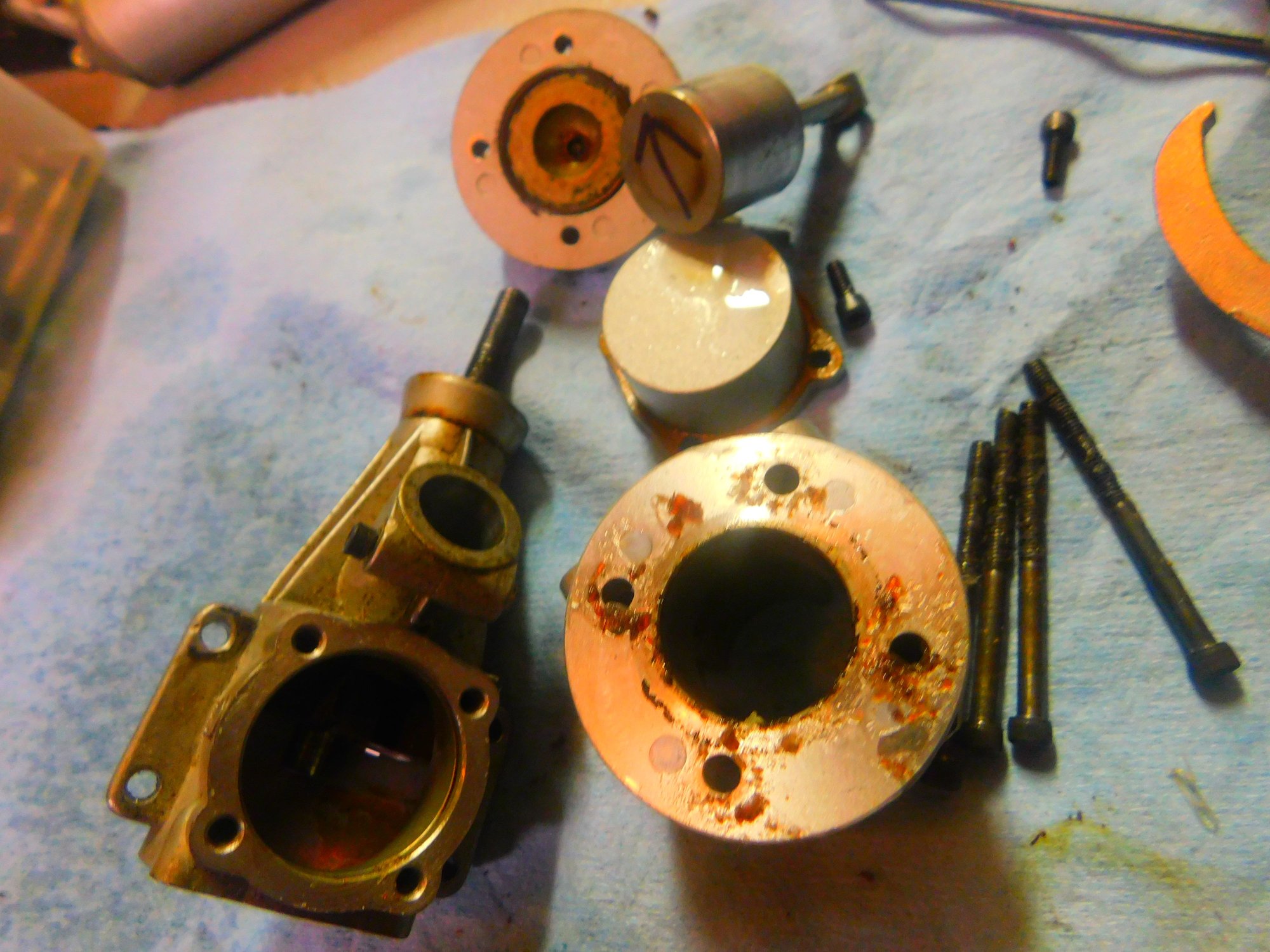

Every bolt had Loc-Tite the full thread length
Running at 5,500

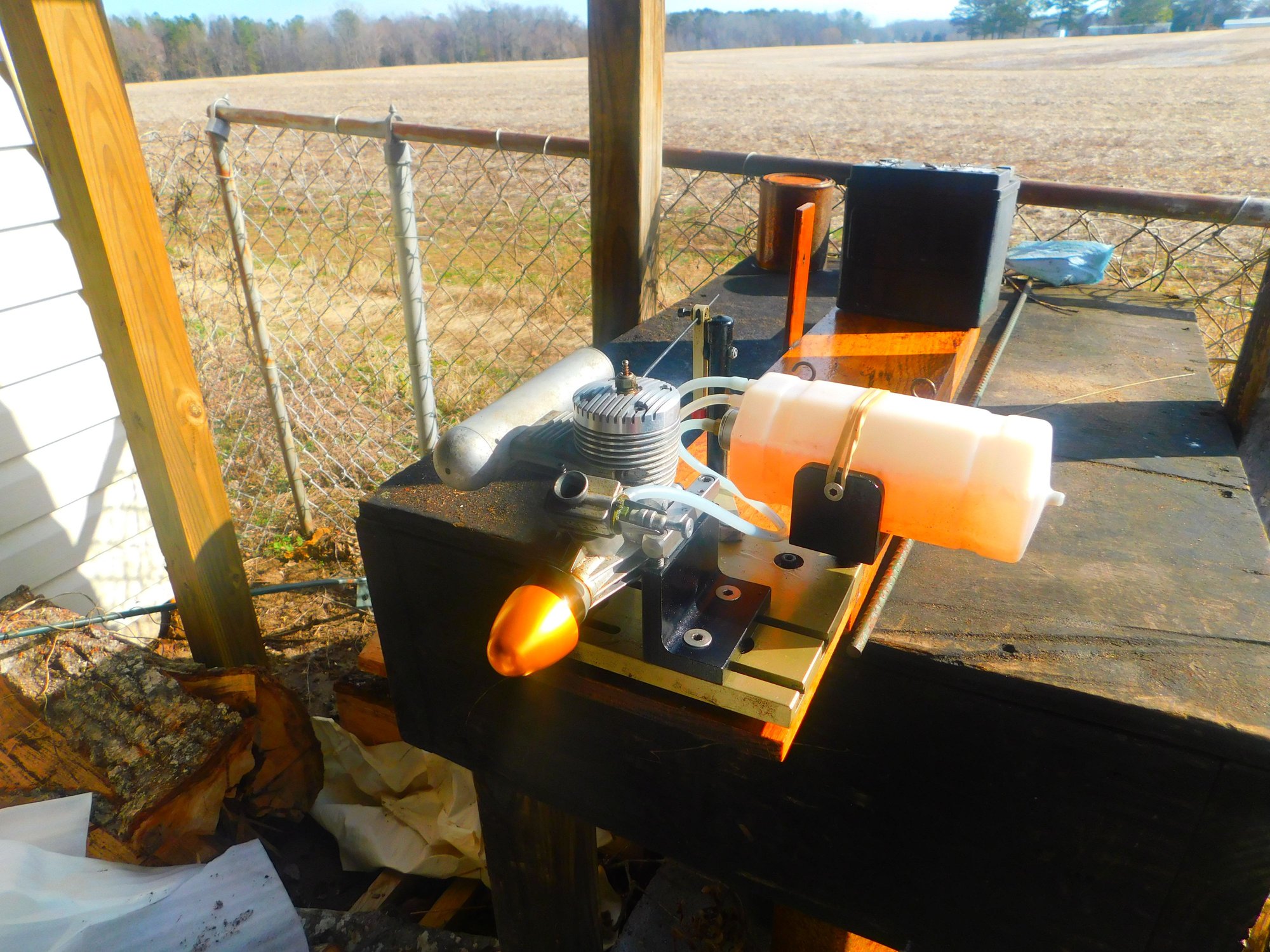

I recently bought this K&B Sportster 45 from a gent who was selling it for a friend, I expected it to be a castor queen but instead it was a red Loc-Tite queen. With a new set of bolts, new gaskets and new Fox Idle Bar plug it runs great. I also bought the Radial Mount back plate but have not installed it yet so it will fit into the PSP.
K&B 45 with O-ring head gasket
Fuel===Wildcat 10% with 18% full synthetic
Muffler===stock quiet muffler
Plug===Fox Idle Bar
Prop===Graupner G-Sonic 11 x 6
Max rpm===11,850
Set a couple of clicks rich=11,670
Idle===low 2,000's, did not adjust
