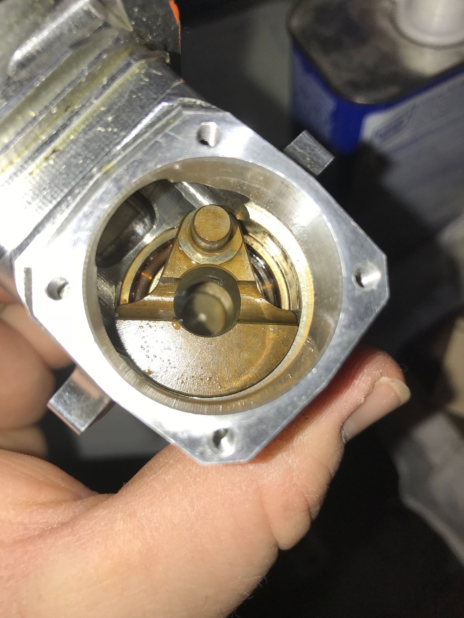

I have bought a few used glow engines on the for sale Marketplace here and have been disappointed . The last purchase was a Super Tiger 90 Glow listed in good condition . The engine I received was very hard to turn over and the bearings were very " notchy " feeling . I took off the engine backplate and head only to find a lot of rust from the engine sitting for a long time with fuel residue . Although the standard practice in RC boat racing circles , after run oil does not seem to be a regular practice in the airplane crowd . I have been flying and boat racing since 1980 so over that time I have had dozens and dozens of different engines and installed and replaces many many bearing due to use and neglect . Lube the engines up if you are not going to use them , glow fuel is very corrosive and will hurt the bearings if left to sit .. I will have to rebuild the engine I just got from Marketplace . Buyer Beware !

Not so much rust but castor residue and that's exactly what I expect an engine to look like when I receive it.. Most of the time I order the Boca Bearings before I get the engine. I just received this Saito 182 and it looks great and is great, no cam or lifter wear, rocker arm tips not worn. But when I pulled the cylinders and the cams off, the rear bearing was notchy as you described. I had a new rear bearing and am waiting on a new front bearing from Boca.

Sorry that you set your expectations so low Hobbsy ! The photo does not do it justice . When I buy a used engine in "good " condition I expect to at least be able to use it .

The little castor residue I usually see is quite easily cleaned (only when absolutely needed). On the other hand,rust from water absorbed synthetic slime is a most unwelcomed sight.

Synthetic slime is non existent, a figment of your imagination.
My definition of low expectation is called reality. Needing bearings is a non issue to me.

My imagination could never be that good. Seen the SLIME all too often. Not alone there.
Needing bearings isn't a "problem". Anybody can replace parts.

Twin hydro, I think what you are seeing in your engine is not rust but congealed castor oil. Old castor is often confused for rust. When I buy used engines I always figure a new set of bearings in the price of the engine. My latest buy, a YS 160DZ also needs a camshaft from a botched disassembly. It felt like it needed new bearings and the exhaust port was very clean. At the time a steal at $150. I'll still come out OK in the end I think.
Buying used can sometimes be a crap shoot. Over all I know I am money ahead. In your case, throw in a set of bearings along with a good cleaning and I'll bet you have a good engine there.

Guys , it's rust from corrosion , I know what I'm looking at and have had scores of model engines over the years and have dozens currently . All I'm saying is that they should be represented properly ie " needs bearings " , "feels rough " etc . At that point you make a choice to buy or not .

(if it works) click on my link, then click on photo to enlarge the photo,,
rather rust or not there is debris in that engine, before taking it completely apart I would remove Back Plate, Carb and head and soak it in hot antifeeze, every 2 hours turn the crank, when done clean off the antifreeze with WD, then rinse with rubbing alcohol, once dried add a few drops of oil and turn it over, go from there
just my $0.02 than may be worth $40

Not sure where you fly but around here, ARO is used far more often than not. Very common anong the aircraft modelers here. I generally avoid the boat and car folks so can't speak for them.
I however did not suggest what you were seeing is not rust, just that I prefer to see a bit of varnish over the typical rust issues.

Thanks for all the replies . I really don't need any help building engines as I have been building all kinds from motorcycles with 4 valve per cylinder 15,000 rpm engines , countless HP 2 stroke motorcycles and High Performance outboards and MX engines and hundreds of RC engines , but I do appreciate the feedback . The post was directed at the manner in which engines are represented as in "good " condition . In the RC boat racing world when you rep an engine as good you get a photo like this . posted . granted , marine engines are much more expensive and operate at much higher RPM than most aircraft engines except pylon racers . Rep the engine truthfully is all I ask and is all anyone can expect .
Notice ... NO RUST or BS inside the engine , this is the way it should be .

This is rust.
It's only like that because it's your engine, loved and cared for, other people can screw up a brick.

I think most people are honest in their description of an engine for sale. Some simply don’t know the condition of what they’re selling. I once bought an O.S. 61 fsr that was advertised to turn over smooth. When I received it, it turned over smoothly alright but when I took off the rear cover I discovered the main bearing was seized and the crankshaft was rotating inside of it. I returned that engine!

I always assume a used ball raced engine will need new bearings. Probably 90% of the used engines I’ve gotten have needed them. I do test run the engine first before replacing the bearings just to make sure. Sometimes a couple tanks of fuel on the bench clears them out and they turn smooth. Most of the time they need to be replaced though.

I have gotten lucky with many engines in the past . The seller has offered a refund but I may just fix it . All good replies , thanks . Not that I was looking to agree with everyone as I'm always up for a good debate ( argument ! ) . I do feel it was a good topic to bring to the forefront as it is somewhat ambiguous at times .Thanks .

I don't hold it against a guy when I buy an engine that needs bearings, as Tim stated 90% of used engine need them. I'd get far more upset by pliers marks but you'd see them in the images, usually.
