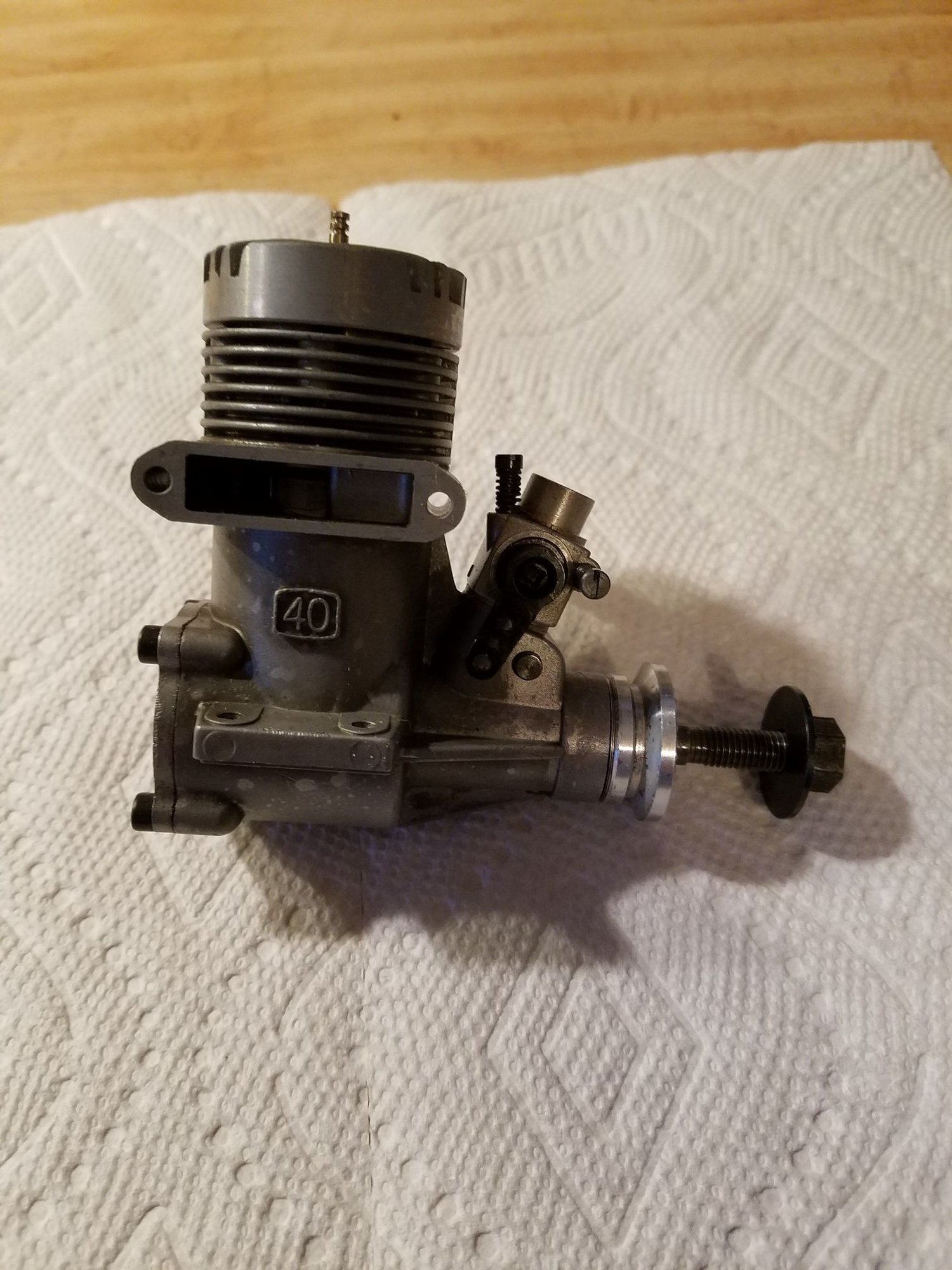

I live in an apartment, and have read that heating the antifreeze gives off bad fumes. So I decided to put the engines in without heating. It did a pretty good job, except for the stuff that's totally fried on. Will heating the antifreeze breakdown that fried on stuff?

This may sound dumb, but don’t burn your hands picking it up when you use a stiff bristled brush to brush the dirt off. 🔥 You have to brush it while it is hot for best results. One of the most important thing to do afterwards, especially if not going to run it soon. Make sure that you you flood it with after run oil, 3-1, gun oil, or any light oil to get the rinse water out of the bearings. It does stinks, so yes, make sure that you have plenty of ventilation. Even leaving it outside in the crockpot overnight on low for a good 12 hours. There must be an outdoor outlet on your patio.
hot antifreeze,
you can remove the antifreeze with WD40, then rinse the WD off the case with rubbing alcohol. I rinse the bearings too with R-alcohol, then oil once the engine is back together I oil it,
if the case comes out a bit grey from the antifreeze don't worry about it, just rub the WD into the case and the grey should go away

yes that is the hole idea, clean the parts and rebuild the engine. but on the other hand, I have a ThunderTiger 40 with a Bushing (no ball bearings) that I bought used, it's compression is very-very good, but it had castor oil burned all over it, so I tanked it and it's clean now with that great compression. I removed the head and carb and back plate when I tanked it.
if some one cleans a bad engine and sells it as a good engine then that is on them, not the honest person that just wants to clean his engine. I could sell my ThunderTiger in good faith, the 2nd photo shows how good the piston is. it's for sale

A much more humane treatment for the outside of an engine is to use something like DAWN Power Dissolve. If you can find it, it will readily take off baked on castor oil. I just recently bought a twin pack from AMAZON, not cheap, works. about $20 for the 2. Also it doesn't discolor the engine. You may have to scrub with an old toothbrush.
