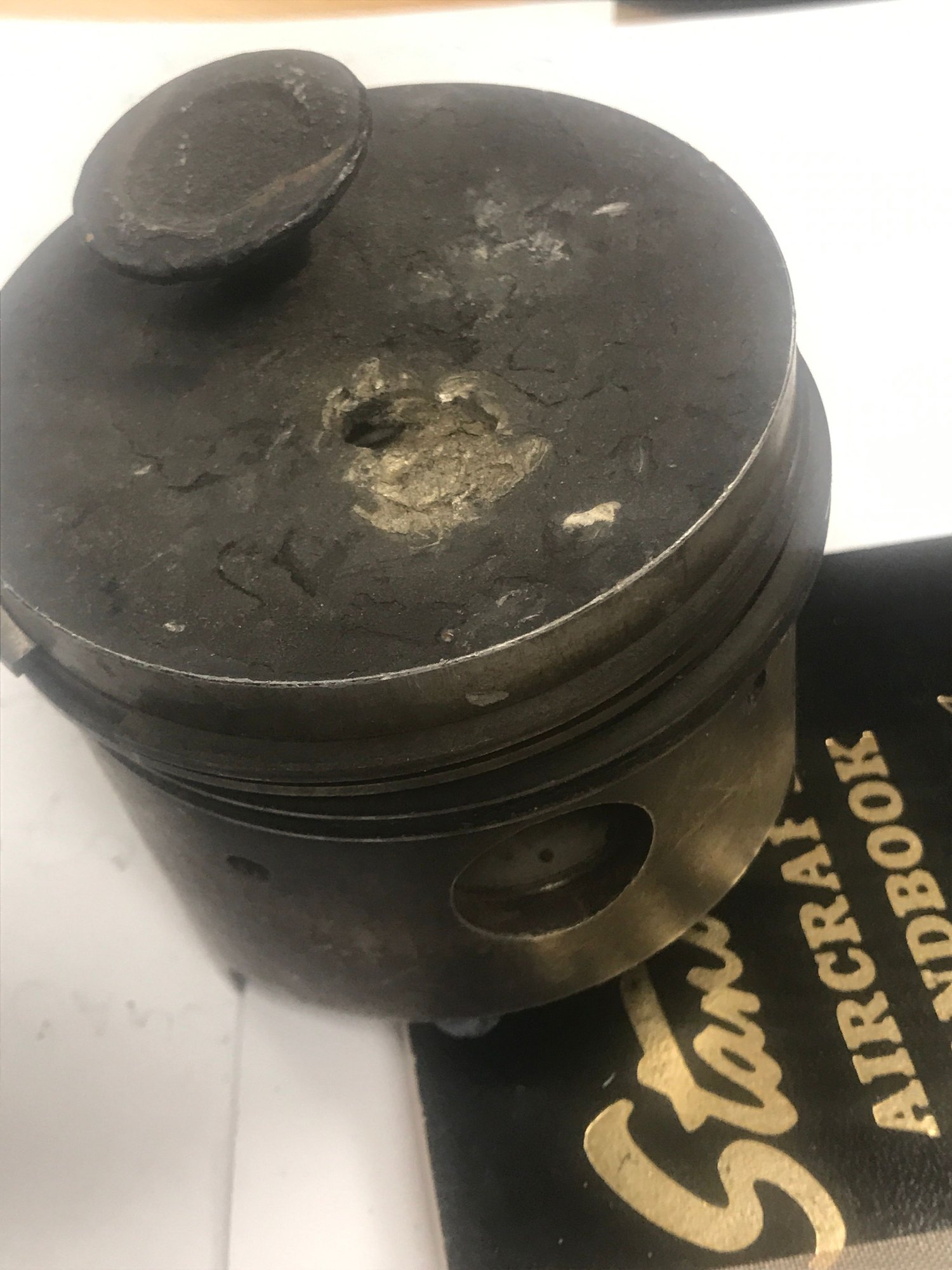

Retarded timing increases cylinder temperatures.
I used to have a box of VW Bug pistons that had swallowed valve heads. All came from #3 cylinders with retarded individual timing on the #3 cylinder.
I will look at the aviation engine handbook later for their take. I personally would lean towards piston position.

Some not so pretty pictures there! Once the timing ring is the correct spacing I will not have any retardation issue. I did note above that the #3 cylinder was hot compared to #1 and #2 though. #3 was retarded compared to those.
