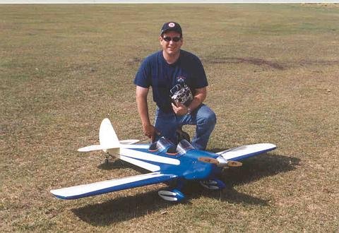

Wow, a lot of good questions there. This Spacewalker II (1/4 scale) is a Sig kit that I built over 6 years time. Not that it's a difficult kit, I am a terribly slow builder, and put it on the back burner many times.
I really over did the engine on this one. It holds a G-38 gasser up front, moved the firewall back 1 inch (probably should have moved it a little more. Had to add 6oz to the back to balance it. But it sounds and looks great in flight, very scale. As for the unlimited vertical, the 18x6-10 really moves it out. Fly at half throttle most of the time, and kick it up to do aerobatics.
I have seen another one powered with an OS 120, and it did fine, so the YS 110 should be about right if you are going to glow it. I wouldn't worry too much about the weight of a big 4stroker, look what I did with weight. Mine is about two pounds overweight, and it still flies beautifully. With that big wing, I figure my wing loading is around 32oz/sq ft, but the bigger the plane gets, higher loadings are less of a factor.
I three pieced the wing for easier transport to the field.
This plane is just different when it comes to aerobatic performance. It spins really flat, snaps rolls and loops with the best of them. But I find myself mezmorized by flying it through scale manuvers, trying to make them look like full scale. That gas motor really helps the effect.

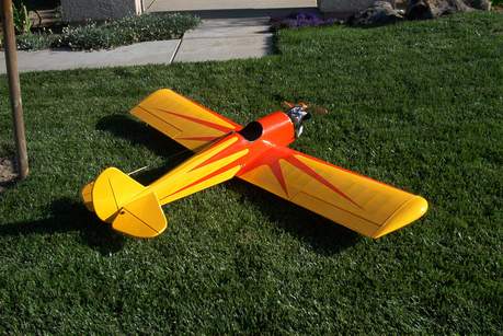

It's been a while since I have read this thread but it has been opened up again. I have bought the YS10FZ and love the engine! Besides some foaming and lean running at first (detonations), the engine has been trouble free. Well, almost anyway. The engine pulled away and seperated the firewall from the plane after only about 4-5 tanks through of flying (yes the YS's do HAVE POWER). I rebuilt the plane better, and stronger and have not had other probs since.
The YS engine just keeps on running like a champ. I'm still flying with the original plug I bought with the new engine! I will by another in due time......

Glad to hear that worked out right. Sounds like your YS wants to really fly, and doesn't like having the drag of an airplane behind it.
Your Spacewalker has the same problem as mine. No pilot daring enough to hop in for a ride. A friend of mine who couldn't stand to see that empty cockpit recentlly gave me a G-man pilot bust to put in there (his cheeks are all blown back from over G). I have a little hangar rash to fix, and then I will put him in.
