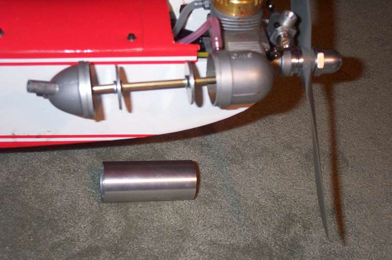

I have isolated the problem and I would like to thank everyone for their help. I'll first answer some of the questions asked, and then explain what I did to troubleshoot the problem.
The fuel I am using contains castor and synthetic oil, but I don't know what percentage. It is the Omega Fuel by Morgan and contains 15% nitro. Again, I have 2 GMS .47's with two different mufflers. The engine with the shiny center section muffler with no fins is the problem engine.
Last night I had sealed the carburettor throat leak with copper RTV. I tried the engine today at the flying field with the different suggested props, but I still was not satisfied with the engine performance. As Ed identified in a previous post, the muffler pressure was very low and you could not see any "bubbles" moving to the fuel tank, this means the tank was not being pressurized.
I suspect this is why the "nose up" test before flight caused the engine to go lean, even with the needle set rich.
I was lucky to have lots of interest at the field and one modeler, Merrick, came up with the idea to insert a baffle in the muffler to create a little back pressure. This was made by cutting a 1.25 (1 1/4) inch disk out of the bottom of a soda pop can, and then putting a small hole in the center for the long muffler screw to go through. The inside of the muffler diameter is 1.5 (1 1/4) inch and the exit hole for the exhaust is .25 (1/4) inch. We felt that the .125 (1/8) inch clearance around the baffle would be sufficient. We only used one baffle, and if you reference the picture below, it was the baffle closest to the front of the motor. (Note: In the final version, I chose to use two baffles).
The engine worked very well after the addition of the baffle, and you could see the "bubbles" in the exhaust pressure line moving towards the tank. All the props that were suggested, including my original prop worked well.
Another modeler, Al, suggested we go to his shop and make more professional aluminium baffles.
The suggestion was to make the baffels with 1/16th aluminum, 1.25 in in diameter, then use wheel collars, compressing "O" rings, on the long screw to hold the baffles in place.
Instead I opted to put the screw in the front of the muffler, slide on a brass tube spacer, a washer, an "O" ring, the first baffle, the next "O" ring, washer, the next brass tube space, washer, "O" ring, baffle, "O" ring, washer, and next brass spacer. The reasoning, I was concerned about the collars coming loose, and thought the brass tube spacers may work better.
A picture of the set up, with center section left off for clarity, is shown below.
Hope this helps others in the future with this enginr/muffler set up.
Again, thanks everyone for your help.
Fly4Fun,
Wayne Miller

Thanks for the input. I also sealed the carb and back plate as well as tightening the head last night. I still had the problem today before inserting the baffle.
It was obvious when I looked at the exhaust pressure line that it was not pressurizing the tank.
When I dissassembled the muffler, there was absolutely nothing inside except the long retaining screw. Once I inserted the baffle, the engine worked great at all orientations, and with lots of power.
Can you tell me the diameter of the exhaust hole in your muffler, and is there any baffles etc. inside your muffler?
I'm curious to find out why some of these engines work fine and others don't.
Thanks for your help.
Fly4Fun,
Wayne Miller
Fly4Fun,
Wayne Miller

Do you have an exhaust extension on your muffler? One person at our field does, and it this improves exhaust pressure for the tank - we think it may be the bend in the extension that gives a slight restriction to cause more back pressure - just a thought.
Another comment at the field was that the pressure nipple may be close enough to the front of the muffler to create a venturi effect, thus it may actually be causing a vacuum at the pressure nipple. I can't comment on this, but the baffles would help if this is the case.
I took a look and measured the "new" muffler with fins that works OK with the GMS .47. The body of the new muffler is smaller in diameter, but there is a slightly larger exhaust opening (.3 in compared to .25 in).
I wonder if the smaller diameter of the muffler body gives enough back pressure to cause more pressure to the tank?
When first starting up the engine, and without modification, you can see the "bubbles" on the pressure line of the "new" muffler moving toward the fuel tank. However, with the "old" muffler the "bubbles" were either stationary, or moving exceptionally slow.
It was mentioned that perhaps there could be a blockage or kinked pressure line, this was one of the first things I checked. It was visually clear, and fuel flowed freely out of it when refueling. Last night I also removed the tank, took off the stopper, and checked the lines and "clunk" just to make sure there was no air leaks and made sure the lines were routed without restriction.
All I can say is that with my new makeshift baffles, all is OK and the tank seems to be pressurizing OK, and the engine works very well.
I've heard a lot of people complain about the older problem GMS's, and other than sealing the air leaks (which may or may not have worked) there has been no definite fix.
I'm hoping that the baffles "fix" may help someone else who has previously run out of options. It is a great engine when it is running properly.
Thanks for your input.
Fly4Fun,
Wayne

RE: GMS Engine Tuning Problem
Wayne,
This GMS muffler is the same as the Tower/Hobbico muffler.
It is used in stock form by many, as a low grade tuned pipe, since it adds significantly to the power of OS.40 and .46FX engines, Thunder Tiger Pro .46, OS clones of all types, like your GMS and some other engines with the same exhaust configuration.
There have not been many complaints of low fuel pressure with it.
Your solution will probably raise the fuel pressure, but will nullify the whole point of the muffler boost.
The 'open' construction is there for a point (pressure waves, exhaust supercharging) and no baffle exists, intentionally.
It was not inadvertantly left out...
I believe you have another problem with your fuel system.
Your solution is power destructive and you will have less fun flying your model, with less power.
It is like driving with your parking break on and stepping more heavily on the gas pedal to maintain your speed...
