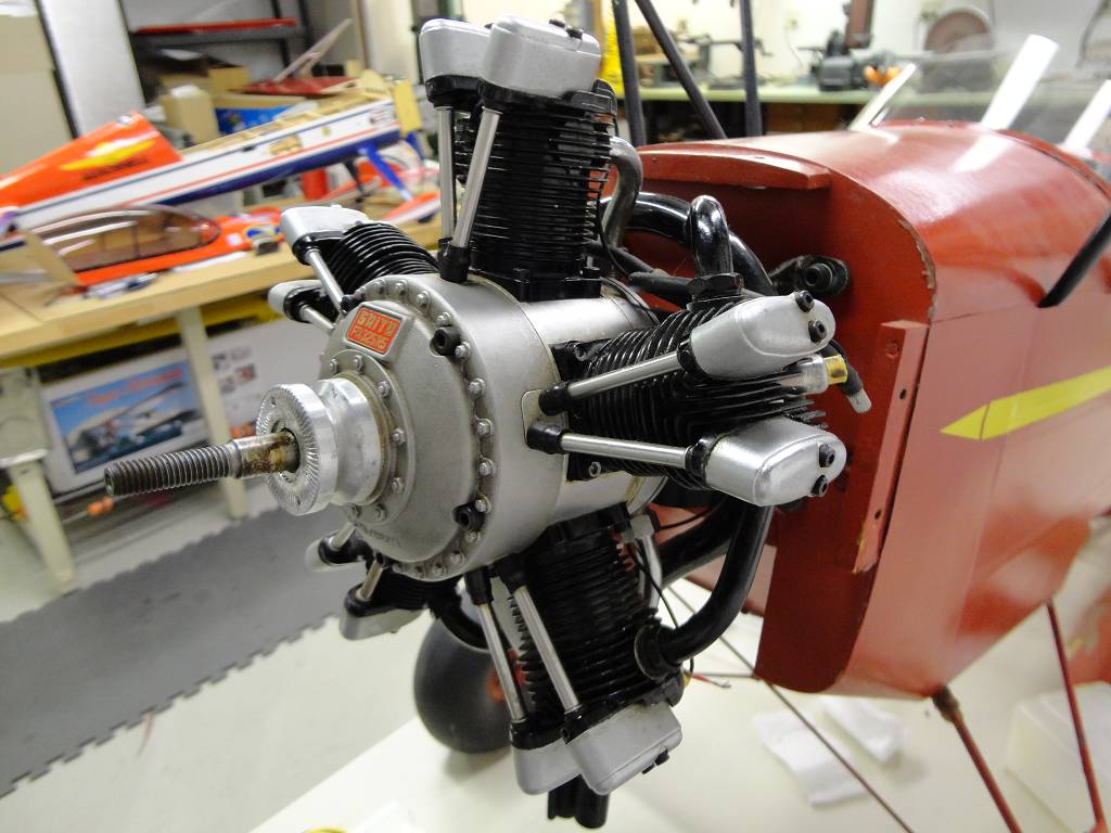

    I picked up a Fleet Bi-plane with a Saito 325R5 on it. I don't think its been run much and maybe not for a long time. What should I do to it before trying to start it? What should I use to clean it? How old do you think this is? What prop should I use? Any other info or help will be appreciated.

    That's a single-plug Saito FA-325R5, so earlier version than the more recent dual-plug FA-325R5D. A 20x8 prop would be a good starting point. You may need onboard glow to keep all the cylinders lit. It should clean up just fine with some alcohol (or fuel); would be a good idea to liberally oil the cylinders (through the glow plug holes) and crankcase (throught the carb). I use a 50/50 blend of air tool oil and Rislone, but there are other after-run oils. It's not too difficult to pull the backplate and inspect the innards if some doesn't seem right, but I would avoid tearing into it.

    This forum has been far too quiet lately. I flew my Saito 200 radial engine powered Seagull Sea Fury last week and it was awsome. The engine seems to ge gaining power and running stronger with each flight. I am very pleased with this combination. The plane is very stable and flys great. The engine seems to be an excellent match for this airplane.
    Best wishes and good safe flying.
    Roger the radial rabbit.
