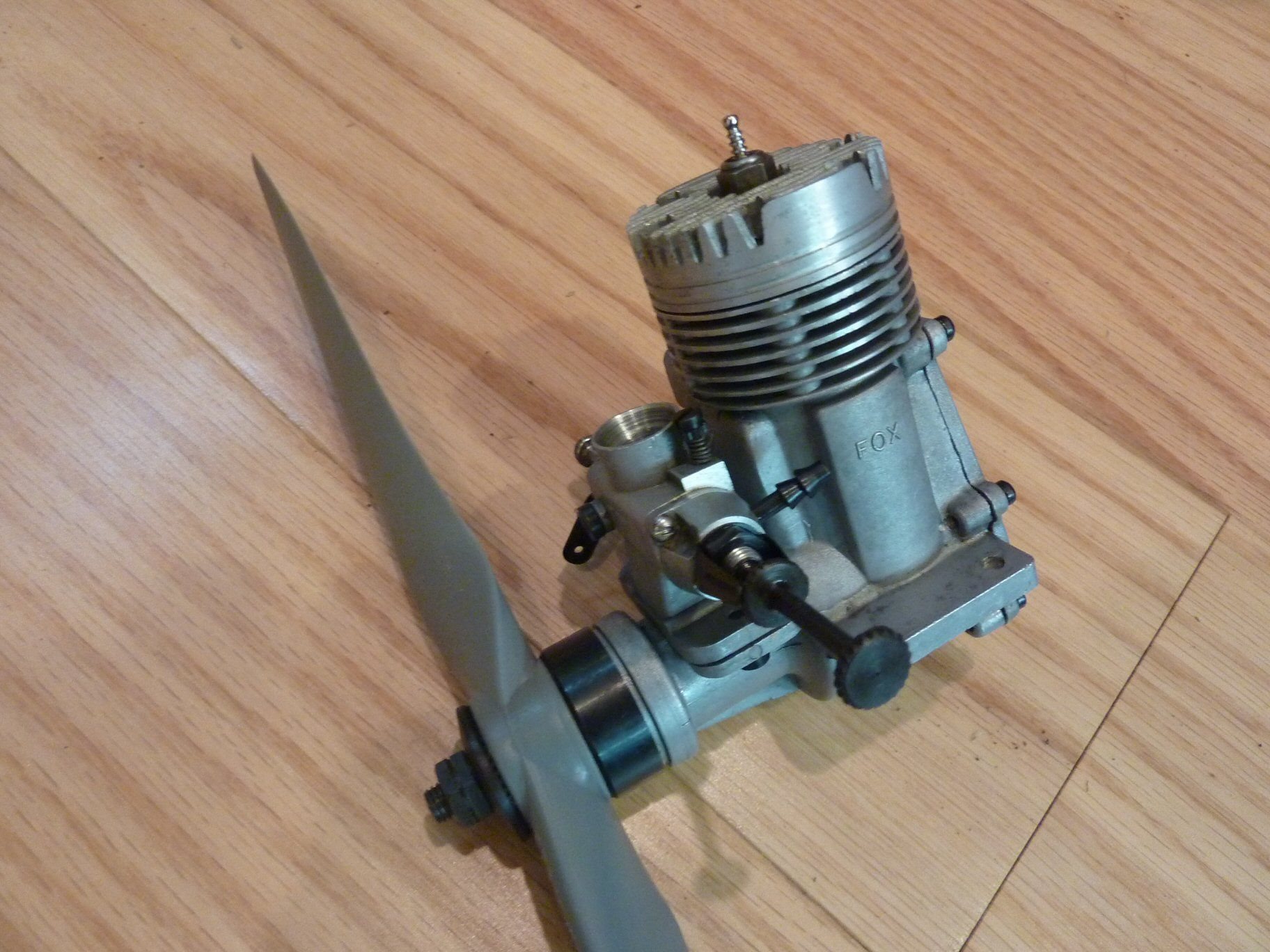

Default Difference between .40 and .45 engine?
I apologize if this has been addressed elsewhere... but I was hoping to distinguish between the .40 and .45 Fox engine. For example, I'm pretty sure this one is a .45BBRC, ca. 1982. It has the MKX series carb, with main and front ball bearings. The Fox docs say the only difference between the .40 and .45 is the bore size ... but haven't seen anywhere what the bore sizes are so that I could use a micrometer on the cylinder. I have several Fox engines, including a few that may be either a .40 or .45. Any thoughts?
PJ
Fox .45BBRC ca. 1982
pjwright is offline
Reply With Quote
Old 02-06-2019, 12:13 PM
  #5073
carlgrover
Join Date: Jan 2002
Location: Decatur, AL
Posts: 622
Gallery
My Gallery
Models
My Models
Ratings
My Feedback
The Fox .45 has a larger frame size than the .40. Put them next to each other and it's obvious.
carl
Fox made a B case .40 as well as the C case (Compact) .40. AFAIK the B case .40 never came ringed, but the .45 is ringed. I remember reading the .40 B case came in ferrous lapped construction and ABC, but I’ve never seen an ABC version. The flat flange mounted carb is a B case and the square bore necked carb came on the compact .40s. IIRC the B .40 was about 1,000rpm faster than the compact .40 on the same prop.

Fox 40BB (1964 Series)
In these reviews the 40's have a couple of different bore and stroke measurements, the 45's are all the same.
40-bore=.800 x 790
40-bore=.800 x 788
40-bore=.840 x 715
45-bore=850 x 790
