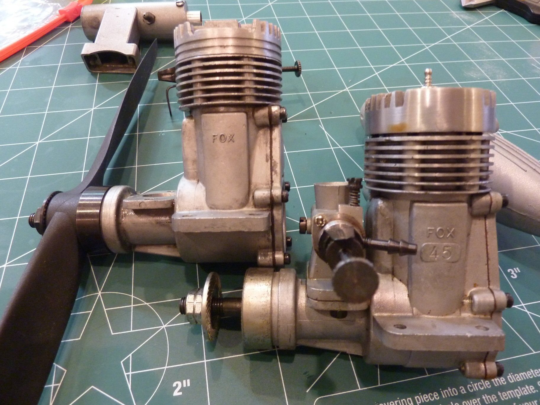

The B case will have the .790 stroke, the C case will have the .840 bore and shorter stroke.

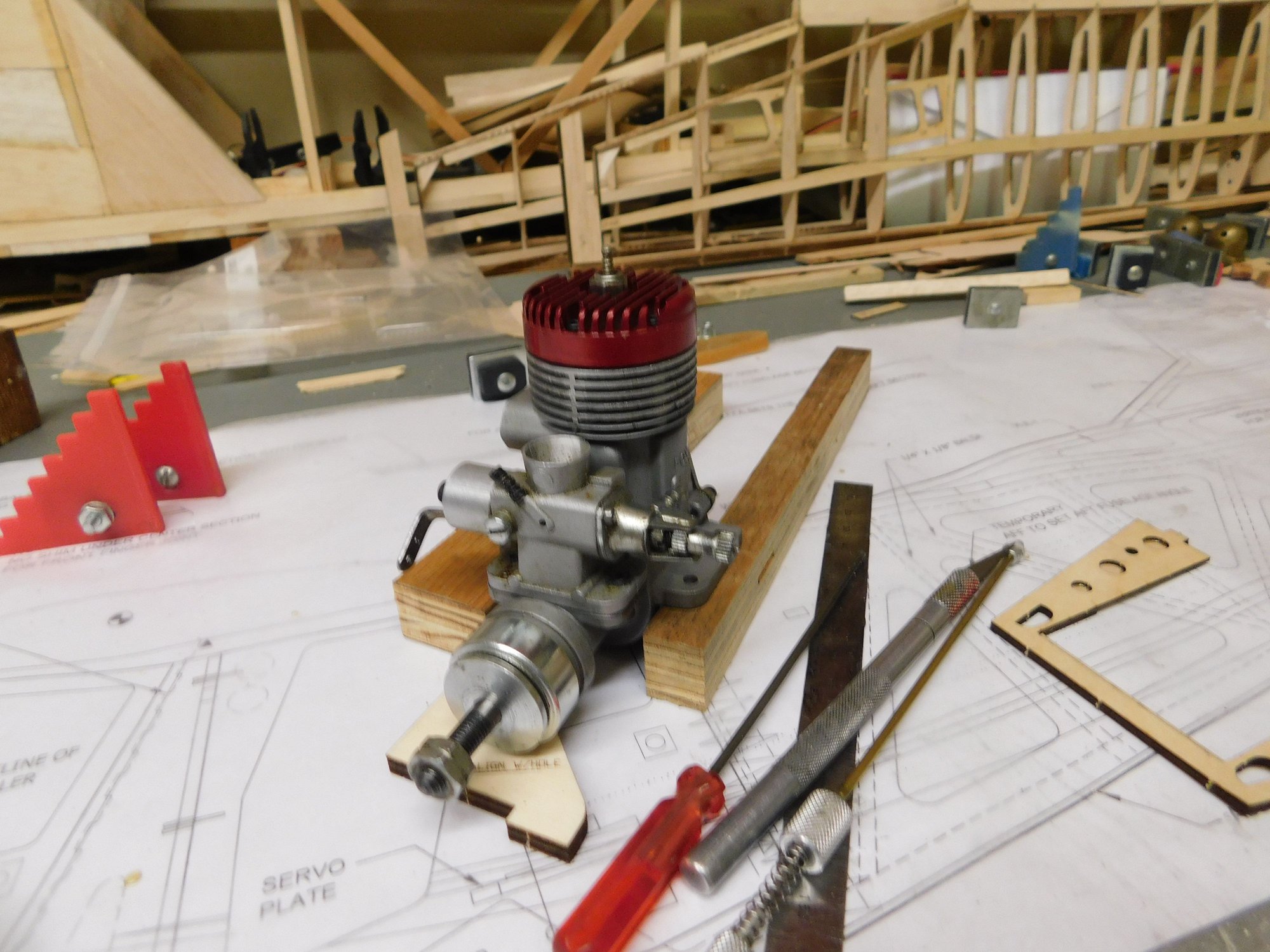

I have settled on one fuel now, Wildcat 10% with 18% full synthetic. All engines turn silky smooth, LA's seem to wake up on it.
But, I ain't disagreeing with you.

Thanks again for the timely info on bore size (and thoughts on replacing the old 2-jet carb). I discovered, quite by accident, another factor in this mystery. I ordered a muffler gasket for a Fox .45 from Larry Berman (ICBIMProducts.com) and found that, although the exhaust port size was correct, the bolt holes were too wide. Pulled a Fox .45BBRC off one of my planes, and found the gasket fit perfectly. It has the tilt-down muffler... and is actually embossed with "45" on the case! So I measured the cylinder bore of the "unknown" engine, and it came to 0.848" on my micrometer, and the stroke (distance between lowest & highest piston travel) as ~0.8". Admittedly, my degree of precision may be off, but this sounded like the specs (850x790) for a Fox 45 given in Hobsy's post 5075. So I searched at Spectre Flight, and found the following 1981 review of the Fox .45BBRC, which is my "mystery" engine! Apparently the .45BBRC underwent some changes when the newer muffler style was incorporated? (See comparison photo)
Larry is making a muffler gasket set to fit the older .45BBRC (bolt holes 0.975" o.c.) with an outside dimension to fit inside the flange-style muffler. He also has the carb gasket (which he lists as the "Type 60") that fits the MK-X mount on all my Fox 40-45 size engines.
I've ordered a new tilt-down "Fox .40" muffler from Mecoa - will be interesting to see if it fits this .45BBRC variant...

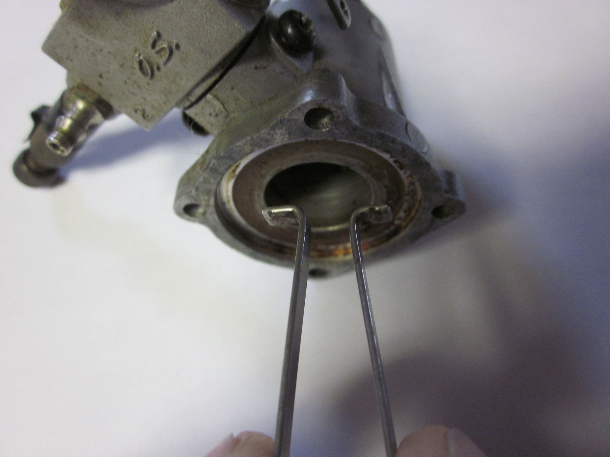

Hi. I recently acquired an old Fox .15x control line engine with an inherent problem. It came to me second hand with the wrist pin sticking out front of the piston. I was able to carefully squeeze it back in using padded needle nose pliers. With that said, I also noticed that the cylinder liner was not in exactly the correct place. So I heated up the crankcase and lined the liner up correctly and equally in line with the support in the exhaust. However, while I had the engine apart and liner out, I did notice that the pin was a bit loose and it would slightly pop out again a little bit. Is this normal, or is there something I should be looking into more? I do not want it to happen again. I do not know if this happened while running or sitting around, but just to mention, the engine has very good compression, and therector are no marks on either piston or liner. Thanks in advance for any help or input into this matter.

Check to see if the wire circlip is missing. Fox engines seem to spit circlips out often enough that Duke Fox went to using a roll pin pressed in the side of the piston to retain the wristpin in later production engines.

All good now. Got it figured out. Thank you.

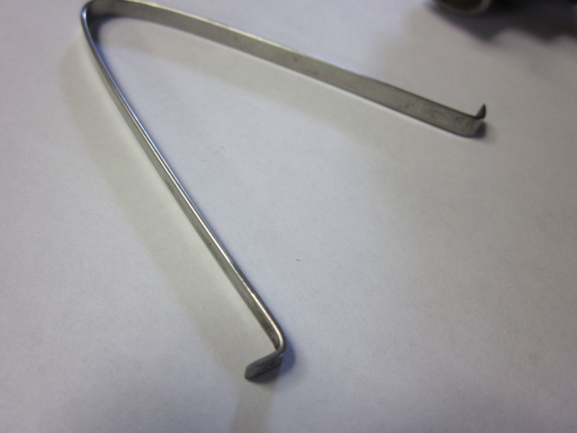

Odd that you mention the Supertiger .45, I had an especially crusty one that the bad bearing would not come out of. I made up a little tool from a piece of metal packing strapping. It could get a pretty good grip on the bearing in the chamfer. I am showing it on an FSR because it is open, and that is what I stole the newer bearing from. There are some inside collet type tools that can be bought for this purpose too. They only do one size though.

Maybe I’m just lucky and haven’t needed to make a tool to get the bearing(s) out. My S45 was smoking all to hell when I pulled it from the oven, and after one further bang on a block of hickory, the bearing popped out. Usually it doesn’t come to extremes, but some cases just have a tighter fit on the bearings than others do.
