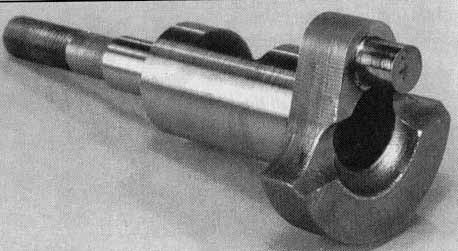

engine balance articles..?
Hi guys,
cannot easily get a back issue of RCM with Mr Benarios article on engine balancing. Someone out there who can help please..??
Attach a photo of one of my "swiss cheese" Saitos for you to comment upon. Wonder how far you can bore out the con rod before....SKRUNKK..? This particular Saito 65 sure purrs like a cat and has now a few hours running time without mishap.
Anyone out there who would like to compare notes on engine balancing - please...??..Cheers/Harald

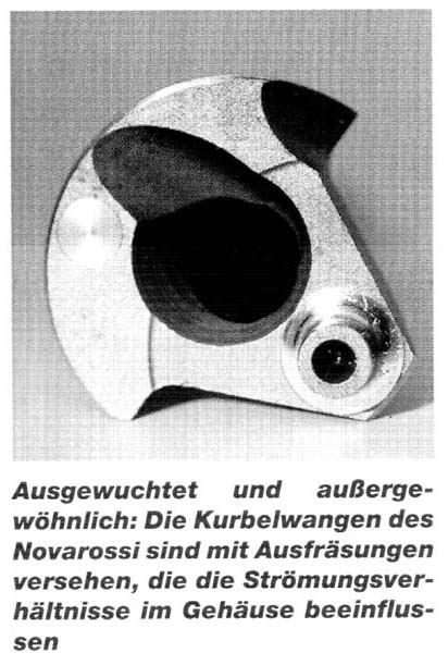

engine balance and 4-strokes..?
Many thanks Chuckauger for you informative overview.
1) Nice job and I´m happy to see the "balance factor" now being defined as the whole assembly but half the weight of the big end of the rod. I will certainly dismantle some of my modified 2-strokes to see where I ended up in my effort to take away as much as I dared on the crankpin end.
2) rsieminski commented on your nice "scoop" and it sure looks good with some further grinding just below the crankpin to facilitate breathing. Nice job which will certainly inspire me to go further in my own modifications.
Attach a photo I saw in a german magazine showing the grinding of a Rossi crankshaft. Comments..??
3) Chuckauger(or anyone else) do you know if the "balance factor" as described by you and Scott Newkirk above also does apply to a 4-stroke engine..??
4) w8ye suggested Pteracodyl do a rcuniverse search on engine balancing. Well, I tried that but did not find much beyond this thread.....my fault maybe...??
hope to hear more from you all...........Cheers/Harald
Join Date: Dec 2001
Location: Adelaide, South Australia
Posts: 1,125
Engine Balancing
Interesting photo and even though it's a Novarossi you can still see where they've inserted one of the tungsten balance weights. Actually I get the impression there may have been another where the web has been scooped out.
tungsten insert of course...!
Many thanks downunder for pointing out the tungsten insert in the photo I attached. Did not see that myself until you made me aware of it.......Cheers/Harald
PS...here is another one from a Jett.65 engine....DS

Fox engine crank
Howdy, yes indeed balancing a single cylinder engine is not trivial, maybe that´s why people approach it so differently. Attach a photo from an RCM article by Clarence Lee describing how a Fox .40 crank has been milled. Must admit that I do NOT understand the reasoning beind that particular scheme. Anyone who can explain..??.....Cheers/Harald
