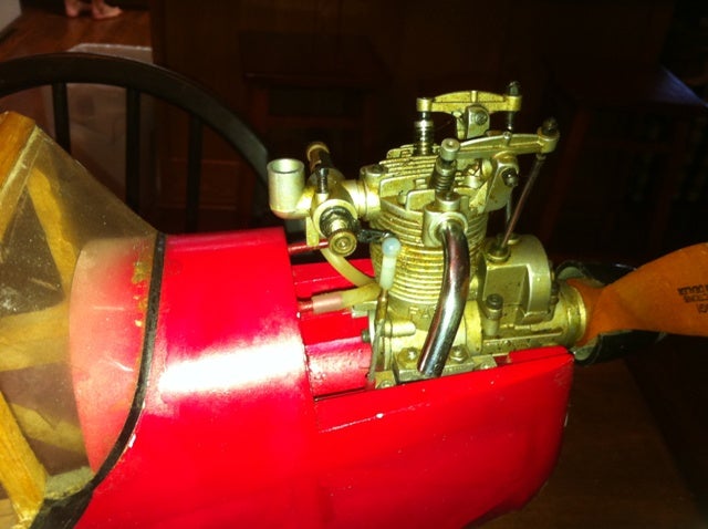

Hey Texas, I picked one of these up last year on the Bay super cheap but it was seized. Turns out that it had been run on fuel with castor oil in it and it was just gummy from the residue. I cleaned it up and got it running. Mine came with the box, instructions, tools and after I looked a little further I found the stickers between the foam and the box. I have only run it twice. I'll take it out and run it once in a while just to hear it run and to watch it. It looks cool and sounds great. Here's a link to the video of it after I got it fired up for the first time .http://youtu.be/KU6brvM6LKY

hey, nice buy!
Can I run a OS F glow plug in mine? The stock one is working fine, but who knows for how long.
Is this fuel ok (it is what I run in my newer engines):
15% Nitro PowerMaster Airplane 17% oil
