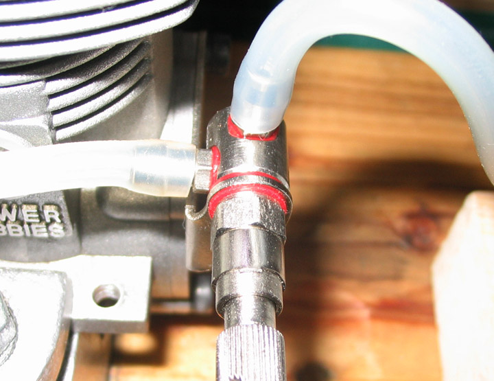

ORIGINAL: Zombie
You might check the o rings on both needles, if you haven't already done so. If you have the remote High end needle, check the washer under the nut that's on the opposite side of the carb from the low end needle.
ORIGINAL: fc911c
Is there anyplace else it could be pulling in air?
Haven't done that, I was thinking of switching carbs with my .61, I think the problem might be with the carb itself as you suggested.

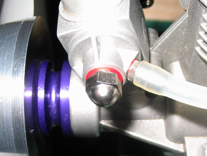

ORIGINAL: rainedave
Frank, did your engine come with all these red washers? This is a brand new Tower .61, but the .75 should have these seals as well. If your engine doesn't have these, I'd try to Tower to send you a set.
yes I have those I think. I will check for sure.
