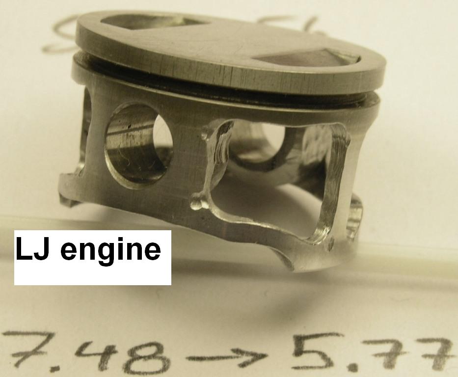

Hi again all engine tinkerers..!
I think I owe you all an update on how my modded engines do perform:
Finally last summer I took six Saito engines and placed them in my test stand using the same reference propeller (Ishipla 11 x 7½), same fuel 12% synthetic + 6% castor + 5% nitro, the same brand new OS F plug and attached you will see the results.
Special notes:
1)I chose to run all engines on 5% nitro as a compromise to have them all run acceptably well.
2)Overall it seems that milling the crankcase does not increase power much but the engine certainly runs better on 0% nitro which was my goal from the outset.
3)The .50 GK(HB) engine fitted with the longer conrod is so far a failure but I do NOT know why.
4)The .56 (LJ) engine with the “swiss-cheesed†piston is still running strong after 5 seasons use in my Sig Cougar airplane. This is a pleasant surprise to myself and probably some of you too…=)..! Admittedly it does spit out more oil from the crankcase nipple than normal and it has developed a slight bearing noise so I guess it is a bit “over the hill†by now. Will dismantle soon.
5)I cannot explain why the .56(AL) engine has a CR of 10.7 after only 1.0mm milling but that is the case after two separate measurements.

Hello Canardlover,
Great and EDUCATIONAL to read this thread from the beginning. Thanks!
I have worked much with 2-strokes over the years, but my experience with 4-strokes is limited to YS.91. Oh, yes, I also flew an RCV 120 for a brief time but that is another story... My reason for buying YS was mainly that it takes in the fuel mix with fresh oil through the crankcase to provide good lubrication to bearings and camshaft. It's just a pity that it requires so much nitro, 10-20%.
So I appreciate that your Saito.56(LJ) with "Swiss cheesed" piston spits out more oil. I'm looking forward to see what you find after dismantling.

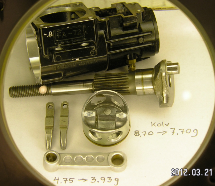

Hello again, another update on the Saito CR increase and some more "swiss cheesing".. Recently bought a Saito .72 GK in good shape and as usual I could not resist to take it apart for a closer inspection. Everything was in good order except that it was equipped with the early plastic rear crankcase cover which is rather flimsy. So I bought a new reinforced cover and gave my usual "swiss cheese" treatment and milling of the crankcase to take off 0.8mm for an increase in CR.
This time I went a bit further in my lightening of the conrod. I drilled four holes each 4.2mm dia. which is more than ever before..[X(]....!! See pic of the setup and wish me luck, testing it very soon...Thank you..!

1) The newly treated .72 engine runs very nicely and I have found out how to measure vibration - see pic - by sitting on the test stand I have found out that my butt is indeed a very good vibration sensor...
2) For the first time I have achieved a really marked increase in power with this modification. We(HB and NL) just ran three engines in a row in my "vibration metering test rig" using 7% nitro, a 13 x 8 prop and an OS F plug. Highest steady full bore rpm and lowest stable idle rpm were recorded and the results were as follows:
a)Saito.82 stock(NL) 9,400/2,400
b)Saito.82 GK stock(HB) 9,500/2,700
c)Saito.72 GK modded as above 9,900/2,700
and I can tell you that the modded .72 runs so much nicer....than the two stock engines. Much less vibration and we both agreed that the modded engine also had a snappier throttle response.
Remains to be seen if the holed conrod will hold together over time.....it is now mounted into my Kelly F1 Racer to prove its "punch" and durability....

#69
RE: increasing compression on Saito 4S..!?
ORIGINAL: Kostas1
As far as the conrod holes are concerned,
don't you think that you threw away some of the stifness and rigidity;
ORIGINAL: canardlover
Hello again, another update on the Saito CR increase and some more ''swiss cheesing''.. Recently bought a Saito .72 GK in good shape and as usual I could not resist to take it apart for a closer inspection. Everything was in good order except that it was equipped with the early plastic rear crankcase cover which is rather flimsy. So I bought a new reinforced cover and gave my usual ''swiss cheese'' treatment and milling of the crankcase to take off 0.8mm for an increase in CR.
I can honestly say that I was a bit nervous when I first fired up this Saito.72 GK and gave it full bore....[X(]...! Well, worst case would be that the broken conrod would poke a hole in the crankcase...[:@]..but second hand glow engines are cheap these days.... OK, a dead stick landing may be added to this scenario....[:'(]...but then at least I will know for sure that 4 x 4.2mm is too much and back off a bit next time(or buy a better milling machine..)
