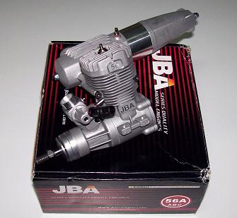

Here's my prop testing results for the JBA .56:
Bare Engine Weight: 13.1
Muffler Weight: 5.3
Total flying Weight: 18.4 oz.
Temp: Low to middle 60s
Humidity: High
Fuel: Omega 10% nitro, castor blend
Plug: K&B regular (non-idle bar)
Tach: Tower cheapie
Prop Muffler Jett tuned muffler
11-6APC 12,800 13,800
11-6MA 13,100 13,800
11-7APC 12,400 12,600
11-8RevUp 11,300
12-6MA 11,600 12,000
12-7Zinger 10,200
12-7APC 10,800
12.25-3.75 13,000 13,900
Here's what I previously got on my OS .55AX
11-6 12,800 14,500
11-7 12,200 13,700
12.25-3.75 14,500 (no muffled rpm)
Actually, the JBA .56 looks really good for the price, especially with a muffler. I would say an 11-7 or 12-6 would be a good sport prop. Use the 12.25-3.75 for 3D and fun fly stuff. That's what I run on the OS 55 and plan to use on my JBA .56, which just came in.
Here are some readings I took several years ago when I bought my first OS .46AX. They were published here on RCU if you search far enough back. They were only on the APC 12.25-3.75 3D prop. The fuel, temperature and humidity were the same as above.
OS .46AX 12,500
OS .46FX (old engine) 11,400
TT .46Pro (old engine) 11,500
Magnum .52XLS 12,800
The JBA .56 turns higher than any of these engines. The TT .46Pro will probably be better on a small prop (10-6 or 9-7) but probably wouldn't turn the larger props nearly as well, 11-7 or 12-6.
The JBA .56 seems to be more conservatively ported and timed compared to the OS .55. It doesn't respond to the Jett-Stream tuned muffler as well. You nominally need about 13,500 for the Jett to work. You can see that the props, 11-6APC & 12.25-3.75, that were close to 13,000 got a pretty large boost. Bottom line on the tuned muffler is I don't think the Jett is worth it for the JBA. With the OS, I gained 1700 on the 11-6 and 1500 on the 11-7 and that is a significant boost.
Bottom line on the engine: I'll have to fly it to see how it runs in the air, but from my initial testing and using the stock muffler, it is roughly the equivalent of the OS .55AX for a lot less money.

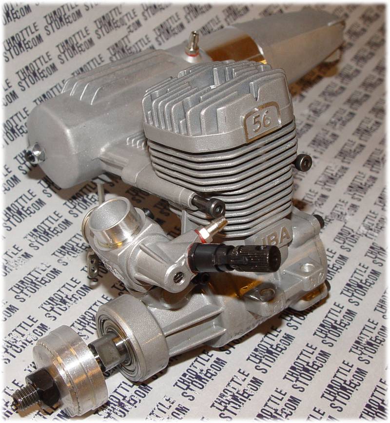

I just ran the break-in on BigEd's JBA .56. Seems to run like an SK, which is really good.
1-flip started on every tank full. Never had to resort to a starter.
After five 8-ounce tanks, I am turning an APC 11-6 at 12,800. This is the same as my OS .55AX. Same prop actually and same fuel, Omega 10% nitro, castor blend fuel.
I set the low end on the 5th tank and it will hold a low idle (I didn't check the actual rpm, but it's low enough for me to taxi) then go straight to full power without a hesitation. I also ran for more than 30 seconds with the carb half open, then full power. No hesitation again. Next, I ran at 1/4 open for 30-40 secs and full power. It seems to have a very good carb.
It does not shut down when you close the carb. Those of us who have SKs know that it takes about a gallon of fuel for the engine to really come in and at around that time, it'll shut down. This was mentioned in the SK thread and it worked for my engines. Maybe it takes that long for the castor oil crud to close up all the minor air leaks. I don't know. I do know the SKs keep gaining power for a gallon or so. I am going to assume the same for the JBA.
I haven't flown it yet to see how it reacts in the air, but at first glance, it seems to be a good running power house for a low price, $80.
I do plan to run several other sizes of 11" and 12" props and I have a Jett muffler to try. Since Ed can't use it right now up in Omaha due to snow and cold, I'm going to give it a good test. By the way, I also ordered my own JBA .56.

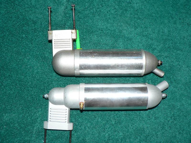

Today (New Years Day) I did a little more testing on the JBA .56. I had already tested the Jett-Stream tuned muffler and found it wasn't very helpful on the JBA. I decided to make a quick check with a Tower muffler and the E-3020 from the OS .55AX.
Muffler weights:
JBA: 5.5 oz (This was a different JBA .56 muffler from the one I weighed before and it turned out to be .2 oz heavier)
Tower: 3.8 oz
OS E-3020: 4.2 oz
Notice that the JBA muffler is sort of a slug. When I started weighing Ed's engine and noticed the JBA was really heavy, it gave me the idea to try other mufflers. The JBA is even heavier than a Jett, so it's too bad the Jett didn't work very well.
rpm testing
My Tower mini tach was acting flaky so I used a Thunder Tiger tach. The rpm on the control prop were a few hundred lower than with the Tower tach, but all you reall need is the relative numbers.
Prop 12.25-3.75 APC 3D prop
JBA muffler: 12,700 (This is 300 rpm lower than the original test, but with a different tach)
Tower: 12,300
OS E-3020 12,300
The JBA muffler showed a higher rpm on the first run and I duplicated it again after running the Tower & OS muffler just to make sure. Both times it peaked at 12,700, so I am confident that the JBA muffler on the JBA .56 is faster.
Here's a couple more of my thoughts. I may try the JBA muffler on the OS .55 to see what happens. The other thing is the JBA .56 is really has .579 cu. in. dosplacement, so it's a .58. It may need a 61 sized muffler. It looks in the photo showing the Tower muffler on top and the JBA .56 muffler on the bottom, that the JBA may be slightly larger. The larger size of the forward casting is probably what is adding the extra weight. The second photo shows the JBA on the test stand with the OS and Jett-Stream mufflers.
I did see a thread, maybe a couple of years ago, on some testing of the Tower muffler on an OS .50SZ. He had access to a machine shop and had a longer center section made from thick walled tubing. After he lengthened the center, he noticed an rpm increase.

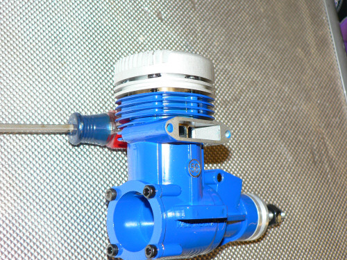

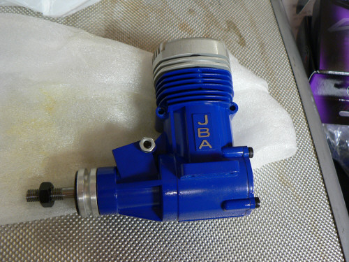

This new muffler comes with the new 56 F series engine.
I've tested this new engine (pre-series batch) for a spanish local R/C magazine review.
It's more powerful than old style JBA56 AND more powerfull than OS55AX (also reviewed)
Production batch are painted in blue (cranckase and head).
I'm very impressed with the performance and reliability of this engine. It can turn little props at hi rpm. (> 16.000) or a big 14x7 prop at more than 9.000 rpm without overheating.
Almost 14.000 rpm with 11x6MA.

Here's a couple of big detailed pictures of the new JBA 56F.
I cant believe Im saying this but the build quality is actually seems good.. pretty darn good..
If its as powerfull and reliable as the OS 55AX - It'd be a very nice and cheap alternative..
I wonder if it can turn up some revs.. Or do only get away with 12.**x3.** apc 3D prop
