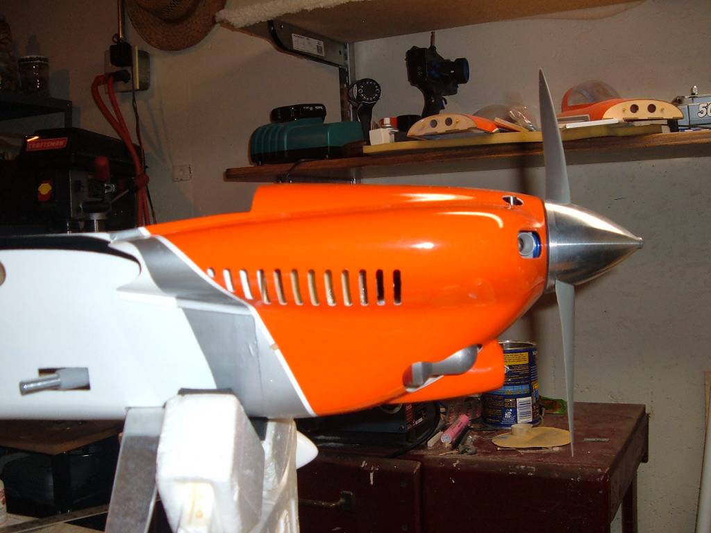

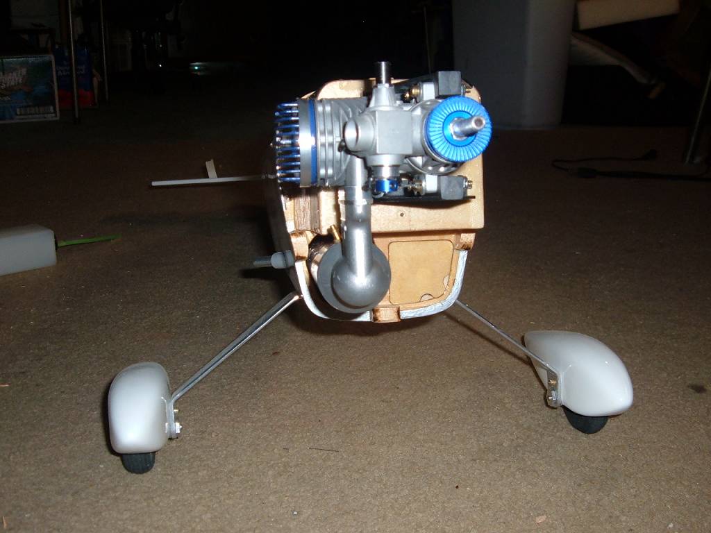

If you are satisfied with 15,000+ Rpm's (Not peak Rpm) running a 10-8, then it would fit the bill very nicely. The throttle responce with this muffler engine combo is awesome. Here is my project that is about 90% done.

VERY Neat install!! I'm putting together a Strega 40 right now with a G-51 and Jett Muffler. If I can't get what I want out of that, an APC 10x8 turning 15K should fit the bill!
