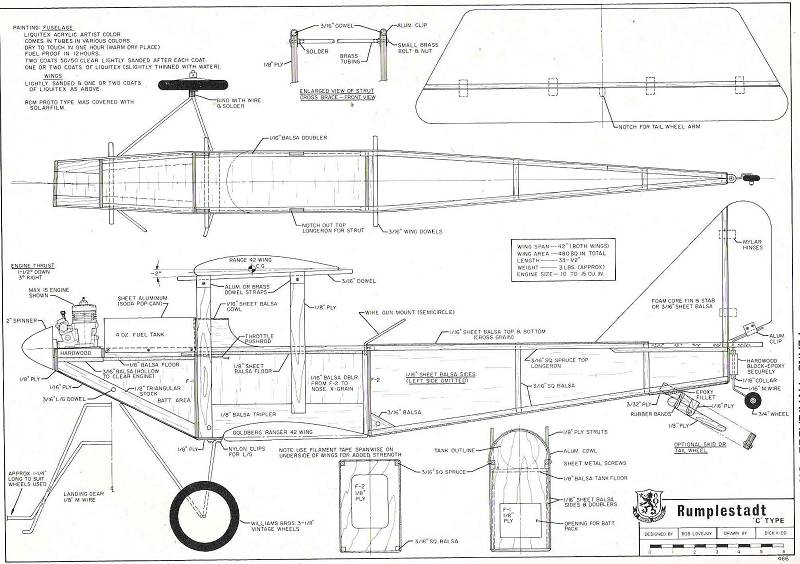

Thanks to gittarpikk I now have a fuselage plan for the R.C.M Rumplestadt. I've been trying to track down the plans for years now, with the intent of building another two. I'm still flying a Rumplestadt that I built some 25 years ago, 2 channel (elevator and rudder), an Enya .19 control line engine swinging a largish prop, and I still have a ball with this model. So relaxing to fly and in strong winds, hovers or flies backwards. A steerable tailwheel is a must as gone are the days where I chased the model across the flats when the u/c motor went off song or sagged. Mine has the built up wings, the top wing has a scollop at the centre rear for the rubber bands and the this wing is longer than the bottom. I treasure this little now rough jewel as much as any of my expensive scale model aircrafts. Hopefully the Rumplestadt will make a comeback in this day of prolific arf's. Guaranteed to cause enjoyment in model flying, and lets not forget the building.

My avitar (to the left) it a photoshopped picture of the only image I was able to find of the Rumplestadt on the internet. I don't think it is still coming up in searches anymore though.
I personally worked with someone at RCM to obtain the only thing they still had on the Rumplesatdt. ...which was a magazine reprint which included the fuselage plans (the plane was originally designed to use the Carl Golberg Ranger 42 foam wings to make building easy). The microfische they used to print the fullsize plans from was destroyed for some reason and they do not plan to bring the plane back nor offer any plans/reprints from it...which is sad...but we can ressurect it...and make variations of that great loveable Bipe.
There is actually two vertical tail outlines and decal schemes as well (plane was used in early WWI combat events at clubs in the 70's)
I was able to scan and clean up the small plans and upload them as a PDF file. Glen has copied the original wings dimensions and drew them and is sending them to me from Australia and I will get them scanned and also upload them so everyone can use them.
Will try to find the RCM reprint an upload it as well.

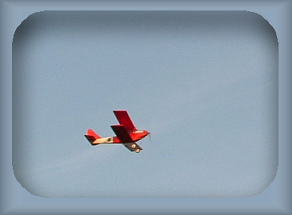

Well....
I >thought< I had a scanned pdf of the 4 page RCM article....but I see I had only scanned the plans...and cleaned them up...BUT....I did find the 4 pages RCM sent me so Hopefully tomorrow I can scan then and upload them to the Adobe site like I did the plans and post the link to them.That will take up the remainder of the 5 free adobe conversions and I will not have any left for the wing. Maybe I had better go to the copy shop and have them converted to adobe there...and not use up the free conversions. I >may< be able to clean them up enough to just upload them to photobucket (lower resolution)and put the page here as an attachment(which makes more sense)... I'll "get it done" one way or another... I'd love to start seeing some pics as their built and flown.The article is pretty thorough and has some history in it....you'll get a good laugh reading it.

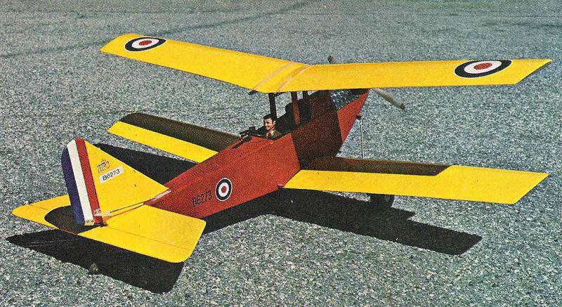

I am uploading the only pic I was able to find on the internet..and it is a good one for your wall!
Also I uploaded the text file record I had of when the actual RCM article ran and what file it was. The 2001 RCM plans simply skipped the plan 466 but 465 and 467 were in it.
I was extremely lucky I found it in a Google search and Google had the plan #....but that doesn't even come up now. Was lucky I remembered how the word Rumplestadt was spelled which was only reason I found it when I did.

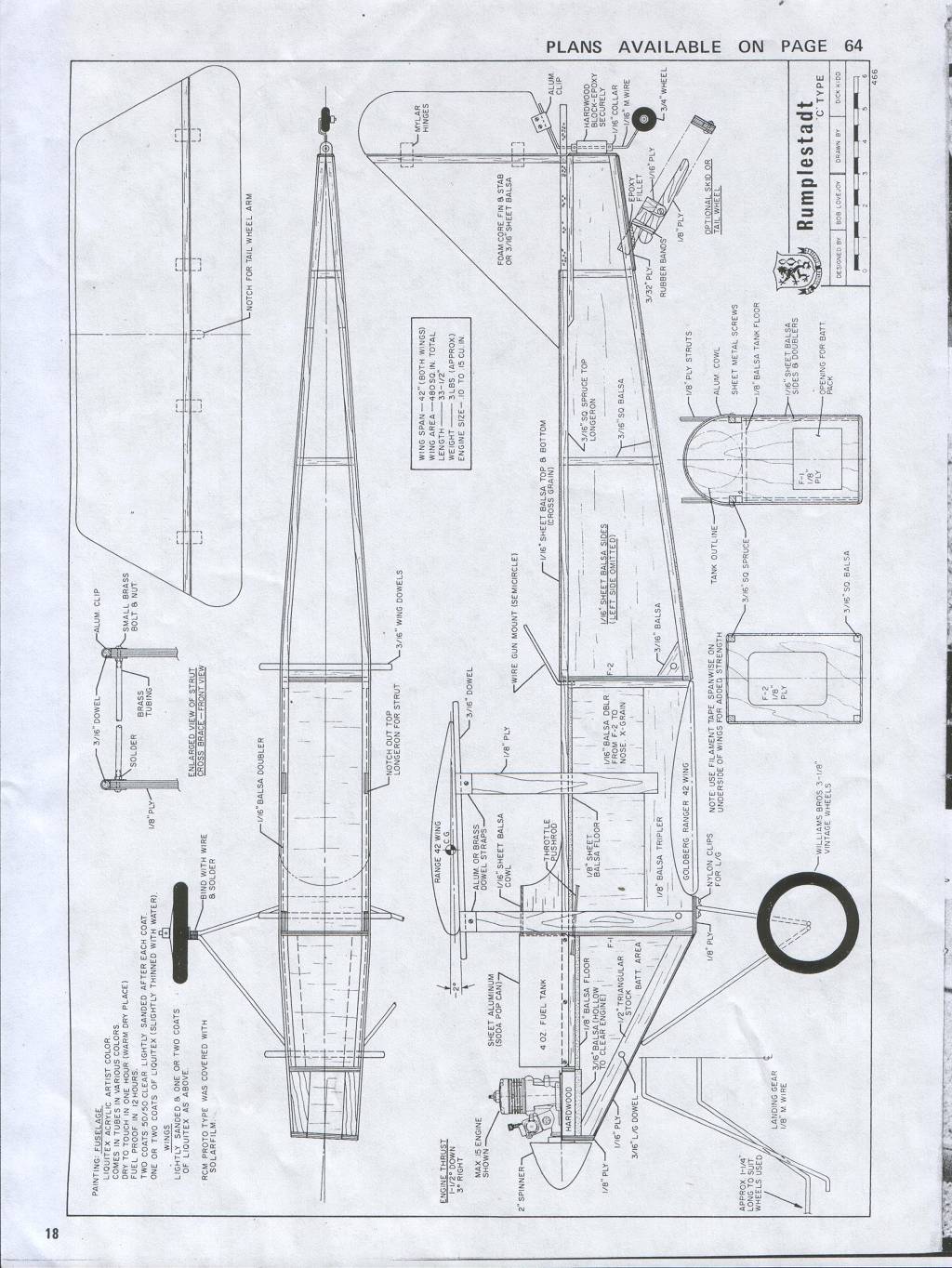

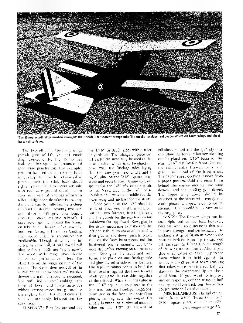

Ok fellows...heres what you can REALLY use... the reprints
I was also told today ...at a local club I just joined that they have a pict or two of the original club ...with Rumplestadt (s) from back in the 70's on their webpage history...so I may be able to nab those and post them as well.
Enjoy

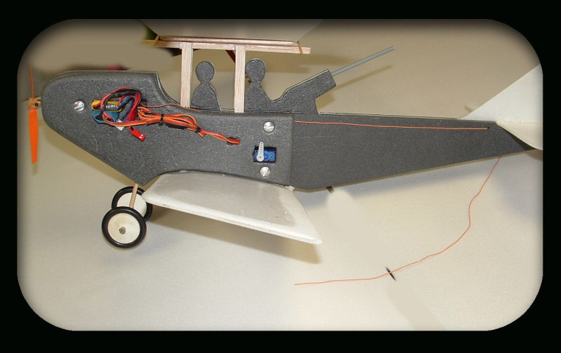

One of the combat guys at the local club that flies SSC (slow survivable combat) got me going...
here is the text I wrote him...
Looks like I will have to draw this up (real simple) and post this for some more fun with this Rumplestadt..Yippeee!
quoted-
In 30 minutes , I designed a flat foam depron rumplestad bipe with
profile pilots and machine gun. What is unique is the (power pak)= landing gear ($1.50,)prop (.80) motor,($6.95), battery($7) esc($9) receiver ($15) and 2 servos ($3 each) all mount in a sandwich of 1/16 or 1/32 ply, 3 MM depron, and 1/16 or 1/32 ply and is a separate part that can be detached from the 3 mm depron fuselage/wing/tail assembly with 4 small bolts or pins and can be changed to a new fuse wing assembly in about 2 minutes with bolts or in seconds with some sort of pin latch.
What is super nice is that to go to a monoplane warbird, shockflyer, highwing mono trainer or Yak style fuse takes less than a minute..... so one would only need to build one power pak and say a half dozen planes that cost less than $2 each and would build from sheet plans in less than 5 minutes each using low temp hot glue.. What more could park flyer combat ask for???
I found a charger for about $20 that does great on lipos and one would need maybe 3-4 batteries at $7 each to last for several rounds....unless you just wante to take a chance and charge them faster at the field..
The whole rig minus transmitter costs less than the motor on the SSC... and is damage-disposable. I even designed in a landing gear/wheels that will take off short grass..;-)

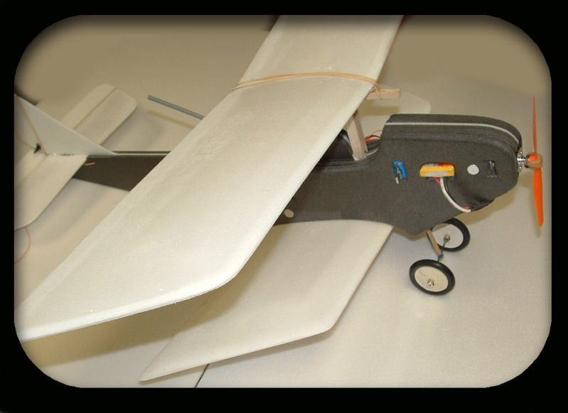

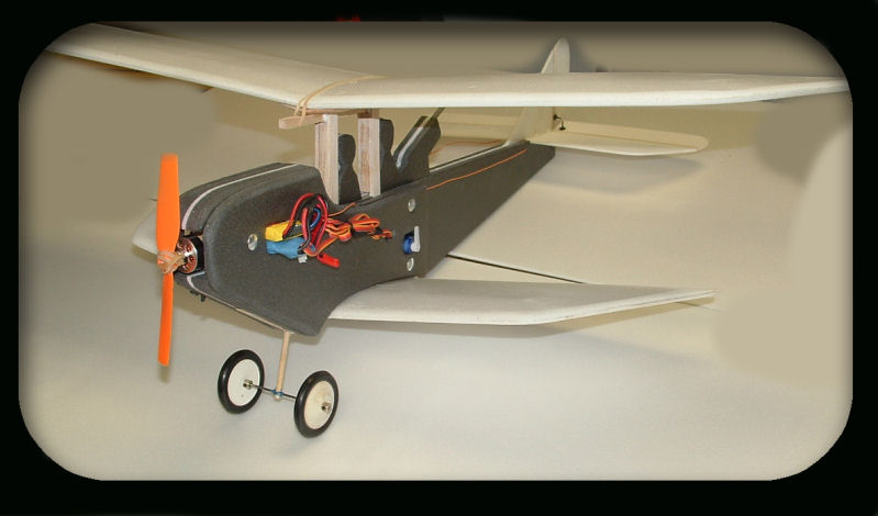

Lol...couple of things... I have been designing again....OMG!
As I described earlier...Now I have an almost finished ...I guess "didley" version (maybe this is what Glenn I believe meant)
Update: This I found, was a comment from Bob on another forum...my apology
of what i would call a "caracature"<sp?> of the Rumplestadt bipe...sort of a profile fuse with quickly removable nose which includes the motor, esc,receiver, battery, two servos and landing gear....WILL take off short grass..(you'll never believe what is used for tires...lol)
Intention is for use in very,very slow combat, cheap, manueverable, survivable by virtue of the entire last half of fuse, wings, tailfeathers are replacable as one complete unit in 2 minutes and that part buildable in one hour ....
whole plane including charger excluding transmitter is less than $90 with the replacable aft (the part that gets sawed/clobbered/chewed up-tell me that don't happen and I'll tell you you've never flown combat!) costing about $3-$5 in Depron (so ya can afford to build many spares while using spray bombs and markers to doll em up...or ger fancy with an airbrush)
This could be the airplane everyone could fly in combat....and there's more...the forsection as described earlier..(that contains all the flying parts less flying surfaces) is also interchangable with WWII warbird profile scenerios...and a third and forth respectively would be planes like the Yak or a high wing trainer. etc with the mid-low wingers having ailerons built into the wings and just plug up....
Pics forthcoming... this is a project born from this dear old Rumplestadt design

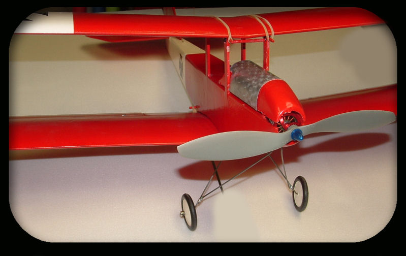

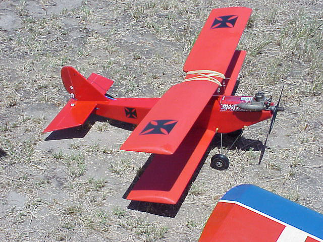

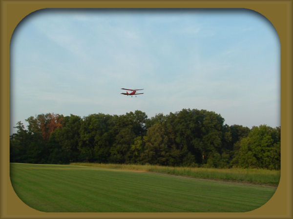

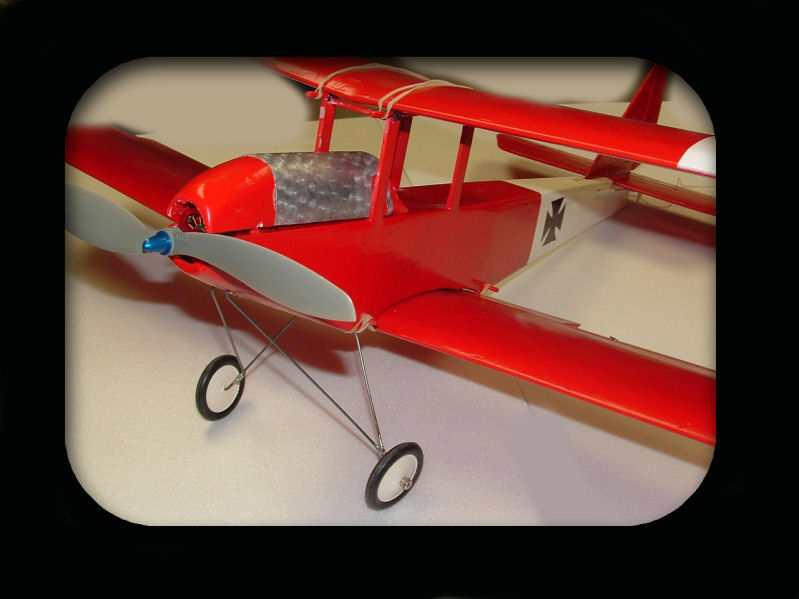

Ok Mates...here's a few that'll bring a tear..and a few that'll make ya laugh.... The 3/4 size Rumplestadt Electric....and My new design flagship of a new class of "disposable" super slow combat planes...Rumplestadt-Combat

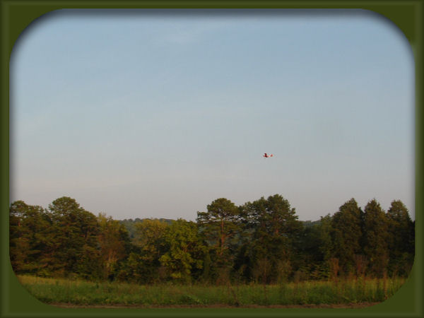

Took the combat foamie to an electric fly-in in Cookeville Tn over the weekend and it was a hit!..even in very windy conditions. Everyone loved it and wanted one....and so extremely affordable.
Took it that evening to the VAM club and everyone loved it and stated it flew so well. (I was doing slow lazy eights directly over the grass runway in about 20-30 feet length at approx chest altitude) the plane wouldn't stall or do any snap tendacy.It was extremely stable and predictable. The "full width" fuse 3/4 size was ready to maiden, but I did not want to decrease its survival percentages due to the higher winds...so that will come later.

Hey Pikk'
The Rumplestadt's you have done above look awesome, very nice work on them.
Thanks for sharing, and please post the plans along as the website link when its done.
How would it be as a Parasol version???

could you EMail me the wing, tail surface's print, any size. no problem to enlarge to my size. its all done the old fashion way, pencil, triangles, calculator and who cares if it's off a little bit. [email protected]

You can get that from RFJ's post... but I will upload what I have (a jpg file you can use paint to change size to whatever size you need, just figure what percent you nee larger and then pint it...it should tile print)
I am also providing a link here
https://share.acrobat.com/adc/docume...3-4ee0434b8663
for the original plan Glen drew and was scanned into an adobe file. The plan was just a slight bit crooked when scanned and I am doing a lot of cleaning up so we have a near perfect file of it. This file is the original wing for the Rumplestadt ( as Glen described in his past posts..)and not the Ranger 42 foam wing version
Also including a cleaned up version in jpg form of Glen's wing plan that can be opened with Paint and tile printed

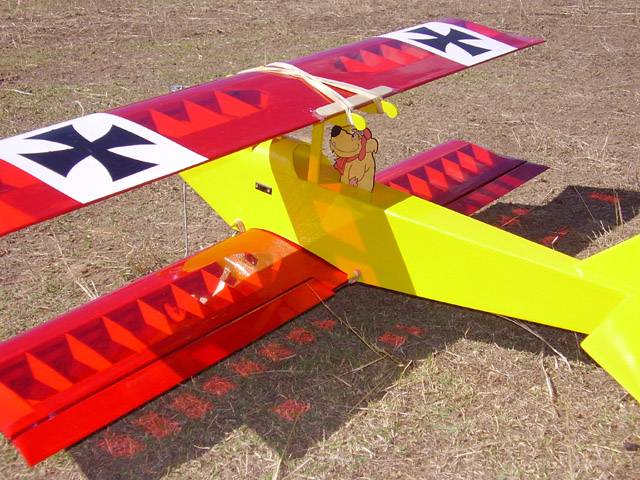

Hi, Mike. The 2 Rumplestads I bought from freeair have been built and covered as by a professional model maker. Immaculate is not an understatement. While freeair was in the selling mood, I also bought Pilot kit of the Bucker Jumgmeister to be powered by a .40 four stroke- have just a little to do to get it up to flying status. Also an Auster 9, for a 60 to 70- four stroke, fuse built primed ready for the final wet and dry, the wing panels yet to be covered. And also a small old time, built/covered, ready for motor and radio installation. The builds and covering of all these models is exceptional. One of the Rumplestads has the wing and tail planes covered with Solartex. Very appropriateMind you, these 2 new Rumplestads make my 25 year old one look sad. But 3 Rumplestads, all mine, on the flight line. Glen
