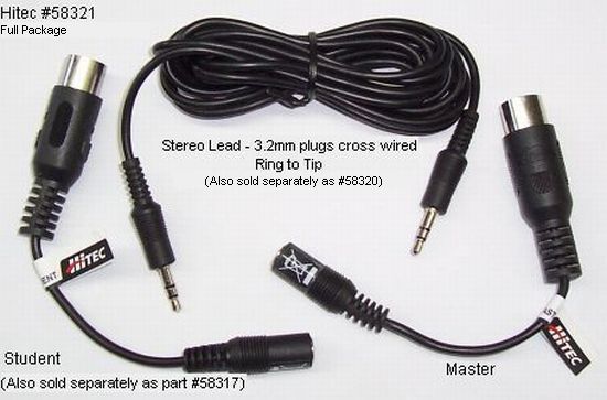

Sorry if this has been addressed before but I have a Prism 7x with spectra 72 mhz module and was wondering if I could use it with the Auroro 9 that I have my eyes on?
Thanks!

ORIGINAL: Heyrandy Sorry if this has been addressed before but I have a Prism 7x with spectra 72 mhz module and was wondering if I could use it with the Auroro 9 that I have my eyes on? Thanks!
Yes, as per
Aurora A9 - Trainer / Buddy system Master & Slave function Set-up
Aurora A9, Spectra Pro & Optima - FAQ & Undocumented Features - Mixes, Setups, Tips. {Individual Links often updated}
Regards
Alan T.
Alan's Hobby, Model & RC FAQ Web Links
