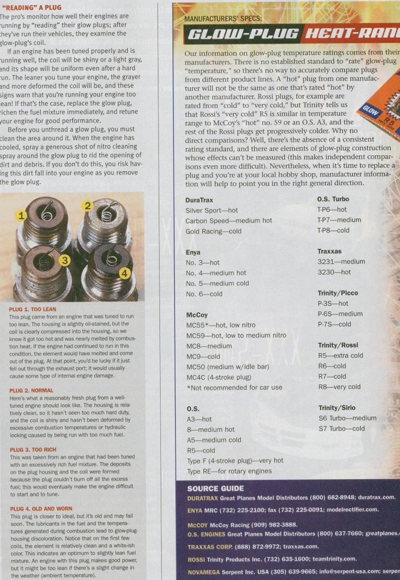

Are you sure glow plug is good?

ijust put a new one in when i started it. whats the best plug for a svage engine?
