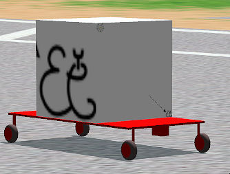

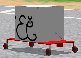

A note on texture mapping techniques in AFPD
Subject to the amount of RAM memory installed on the computer being used, I have found that I can use a texture file up to 4096 x 4096 pixels, that is 48 Mb in size. I don't yet know what the upper limit is in AFPD.
In addition, copies of the same texture file that have been re-scaled by a simple factor can be installed directly in the selected AFPD aircraft folder without any other changes or, in particular, any other re-mapping of the textures.
For instance, in the first example below, the texture file had a size of 4096 x 4096 pixels. In the second example, the same file was reduced by a factor of 8, 512 x 512 pixels. All I did was copy the reduced file into the folder.

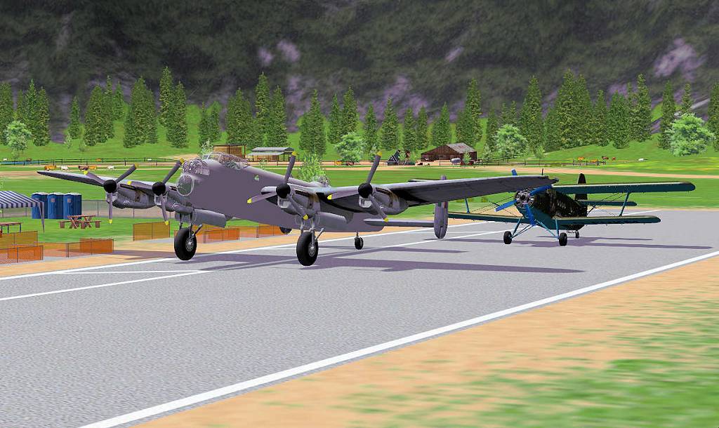

Hi all, join with me drinking a half bottle of champagne!
I wanted the Lancaster to be at 1:1 scale relative to AFPD. But I had a lot of doubts that I would get there. It really is big at 31 metres wingspan. Compare it to the True Scale Antonov AN2 in the second image.
Then I've loaded the model with a whole heap of fine detail - taking the polygon count well past the normal. Would my display frame rate disappear?
Well, it's here at 1:1 scale and without any noticeable hit to my frame rate!!
But only a half bottle. It does fly just - like a very drunken duck; I haven't started on the TMD file yet. But I can't make any promises yet.
But here it is - the MIGHTY LANCASTER.
Enjoy

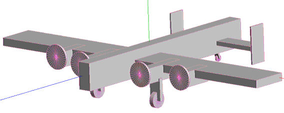

There is tons of stuff about moments of inertia and radii of gyration. But it’s all formulas. It is difficult to find anything which says what those two are. I think it’s a maths abstraction which actually works for some unknown reason. The best explanation I have found talks about the radius of gyration being the optimum distance from the axle or axis of rotation to apply torque force to achieve a required degree of rotation.
Actually the maths is really quite good. The easiest shapes to find the moment of inertia are solid rectangles and cylinders. You can approximate a complex shape like an engine nacelle with a number of different sized solid rectangles and cylinders. Each of these smaller components will have its moment of inertia and radius of gyration about its own easily known centre of mass. It’s easy to re-calculate the individual two values about the centre of mass of the nacelle itself. Once you have that, it is easy to combine all of them together to give the moment of inertia and radius of gyration of the whole nacelle about its own centre of gravity. You can continue combining and re-calculating until you have these two things for the whole aircraft
Once all the moments of inertia and radii of gyration have been combined for, say, a tailplane, Aerofly 5 requires that a solid rectangle be defined which has the same characteristics as those of the tailplane.
You can get some idea from this drawing. But in this case the cylinders corresponding to propellers and wheels need to be converted into equivalent solid rectangles:
See Moment of Inertia Equivalent Solid Rectangles Image below (MoE.jpg)
