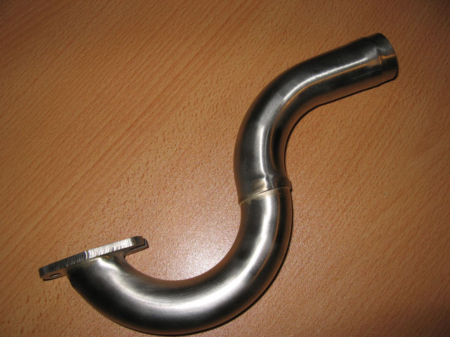

Sure. I would send pics, but RCU won't let me. Maybe I have to be a senior member. Anyway, the problem is the Can is too long. Getting under the Wing tube is very tight. And because the header does not have a drop in it, you have to angle the can down, therefore resulting in the rear of the can sticking out the rather large hole you have to make in the bottom of the fuse. So the last 2 or 3 inches of the can sticks out of the fuse about 1/2 inch. Does not look nice. Also this means that the Teflon tubing is bent at an angel and I am told this might not hold up. It is interesting that in all the pics of the DA and can installation in the 2x2, show the hole in the fuse, before the can is installed and only show the can installed in shots where you can not see the area I am talking about.
I worked with DA and they were very helpful but did not currently have a solution.
CA says they fly the 2x2 with this setup ?
So in the end it does not look good, the can is almost touching the wing tube and the Teflon connector is bent.
I will be test flying my 2x2 this weekend. I guess we will see how it works.
You might want to consider a Pitts style exhaust. Not sure it would work but there has to be a better solution then this.

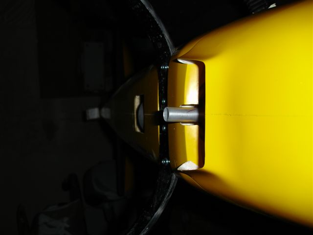

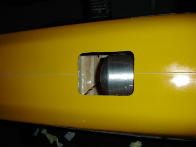

You can see some build pics of the 2x2 on the German Composite website
[link=http://www.composite-arf-world.de/ea2x2-da50.htm]http://www.composite-arf-world.de/ea2x2-da50.htm[/link]
There are no pics of the pipe (MTW TD75K) yet on the site, but i'll post them here.
Maurice didn't bent the teflon connector but made a drop in the MTW header.
The MTW header consist of 2 pieces, a 180° turn an a 90° turn. You can heat the weld between these 2 pieces and turn the 90° piece about 1.6mm down to create a drop in the header. Put back some silver in the weld.
The muffler doesn't touch the wing tube and doesn't stick out the fuse.

Well that’s Brilliant !!! Un solder, adjust and re solder the header. Maybe CA should put that step in the Manual. Or at the very least tell their employees about so when you call they at least have that suggestion. Well to be fare, this is the first run of this product, but still, CA says this is the setup they fly.
1 question. With the Pipe being a 180 and a 90 deg parts, adjusting the 1 connection would put the exit end of the header at an angle wouldn’t it ? Although it appears that may work, to get the can back level again, doesn’t there have to be some bend in the Teflon tube ? I am told that can be a problem. If we had a header with an actual drop in it (rather then just angled down) that might work even better. Or one that was a 3 piece unit, then we could customize the fit, get the correct amount of drop and have the exit level, not at any angle.
But still, your solution is better then what I have now and the best suggestion I have heard yet.
So who’s bird is that in the Pics ? Who came up with the idea ?
