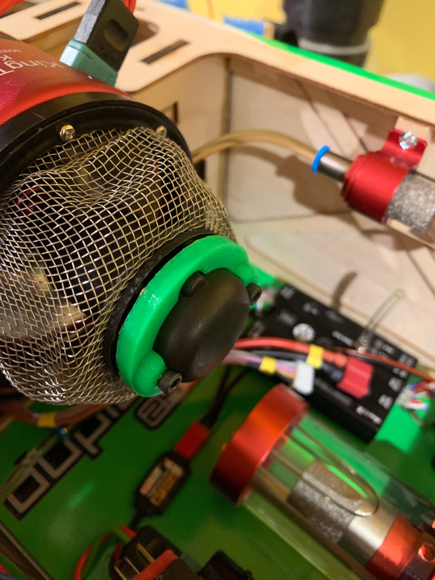

I have a new K-85 in my TopRC Cougar. It’s been a great engine, but it’s developed a problem.
it starts and idles fine, but when I go to full throttle, it flames out and the GSU says “speed low.” It lets out a big puff of smoke when it quits, so the pump is running up. I tried advancing the throttle slowly, and I can get to about 3/4 throttle and 120000 RPM and it will run, but any higher throttle, it quits - “speed low”
Any ideas?

Look at your pwm setting at the time of flameout (3/4 throttle), note it, then compare if it's close to the max pwm setting. This could indicate a fuel restriction since you say it was running fine before. I would check for a kinked fuel line or clogged filter.
Also, note if there are any small air bubbles in the fuel line to the turbine just before 3/4 stick and/or if there is any change in the UAT fuel level. I'm kind of new to the game but that's what I would do before sending it in.

Sounds like a fuel restriction or bad pump to me but yes, talk to Barry or Dirk

Jeff was at this event and he suggested looking at the pump PW to see if there was a restriction as well.
So we were inspecting the fuel system and checking the fuel filter and we happened to look in the intake and noticed that the FOD guard had come off. We removed the engine and saw that the FOD guard had settled in the intake and was partially blocking the RPM sensor, as well as blocking some of the intake as well, of course.
Luckily, no damage was done to the engine. The O ring that held the FOD guard was nowhere to be found. On this engine, there is very little space for the O ring to sit on in front of the FOD guard, and it must have slipped off.
At Jeff’s suggestion, we replaced it with a zip tie around the starter motor casing in front of the FOD guard with a few drops of CA for good measure.
Problem solved and the engine is again running great!

These can be 3D printed quite easily....
