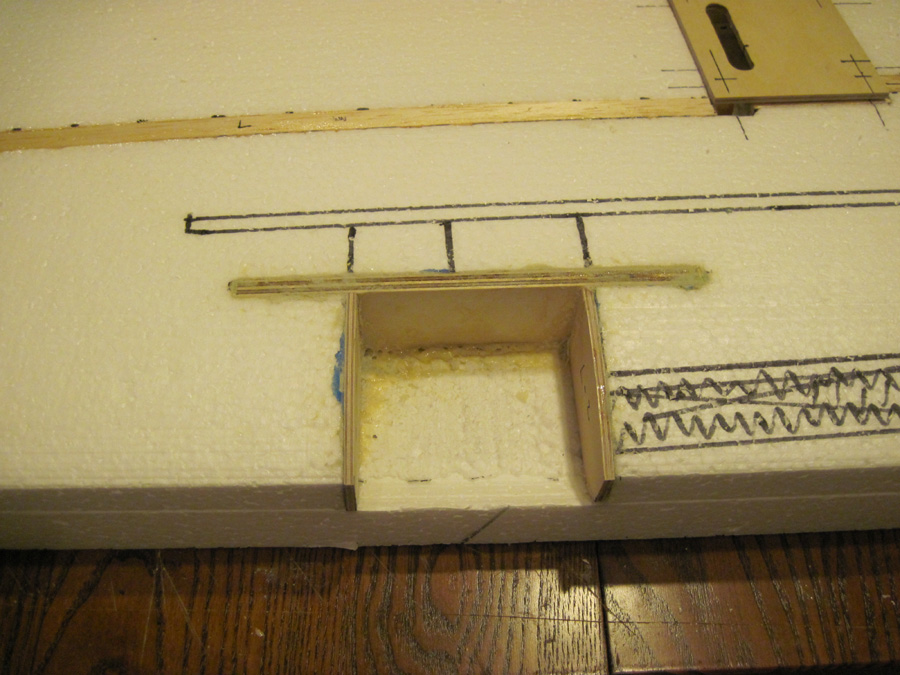

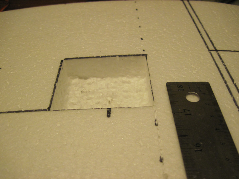

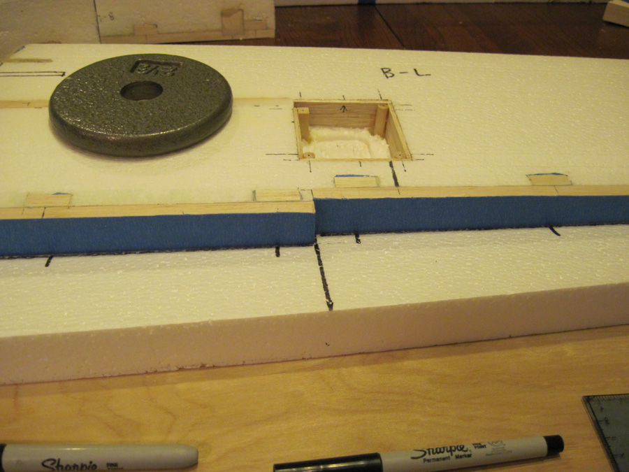

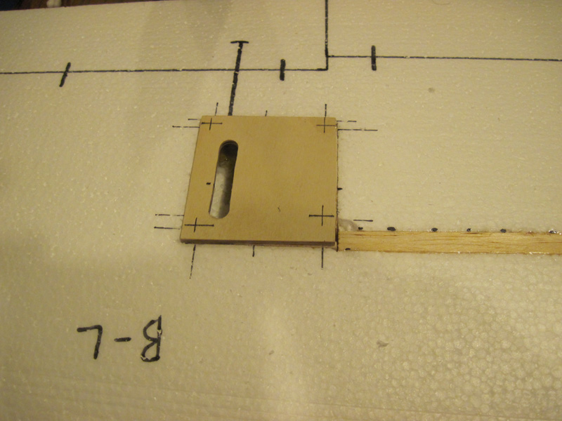

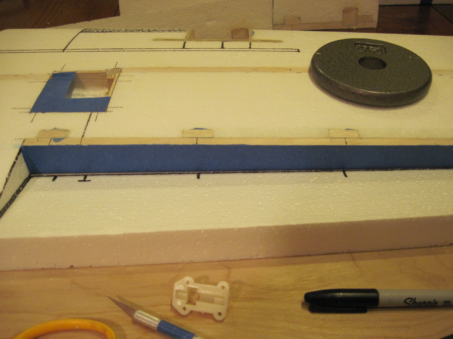

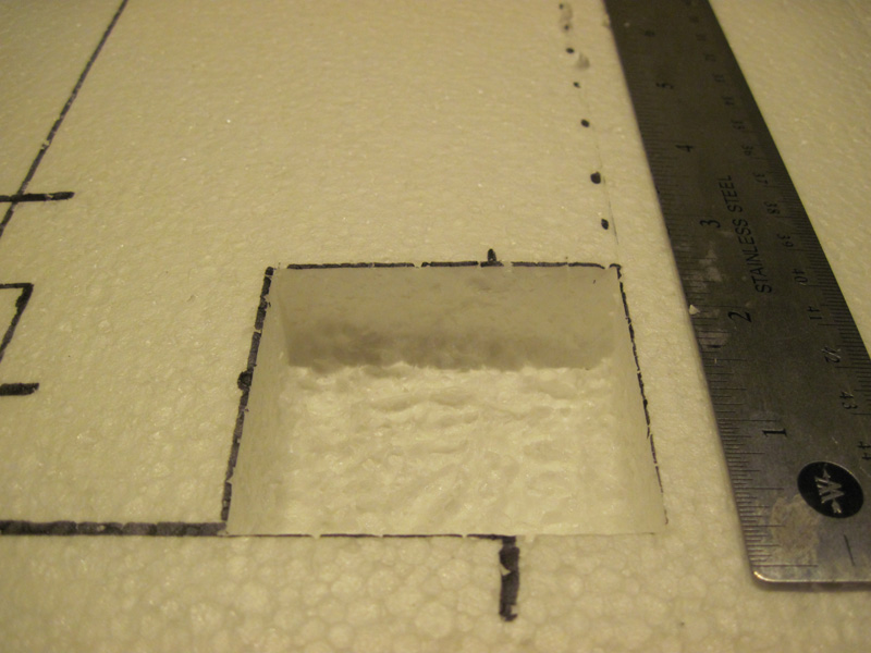

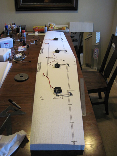

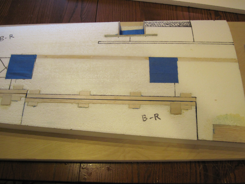

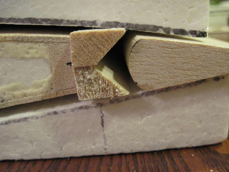

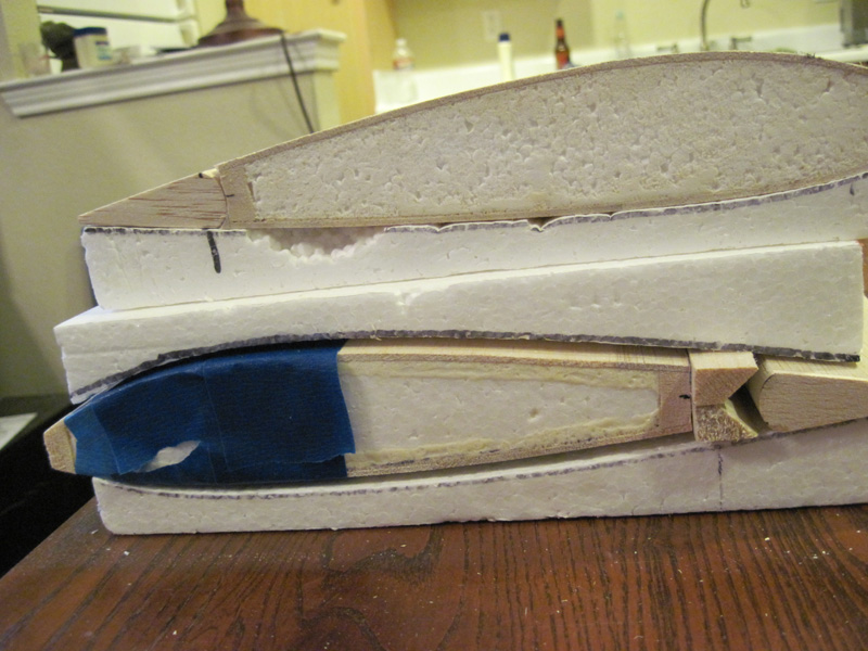

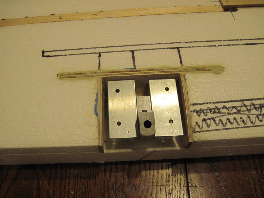

    I started the wing the other day with layout. Servo bays, landing gear blocks, spar, hinges, and control horns. I also glued the stabilizer halves together along with the wing husks. I want to sheath the stabilizer hole. I will start cutting this week. I will sheet the top of the wing first, then install the LG blocks, trench for servo cables then sheath the bottom. Still waiting on wood so I have all week to get ready. Here are a few pic so fare.

    Here are some more pics!

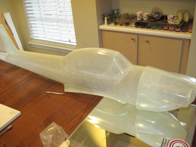

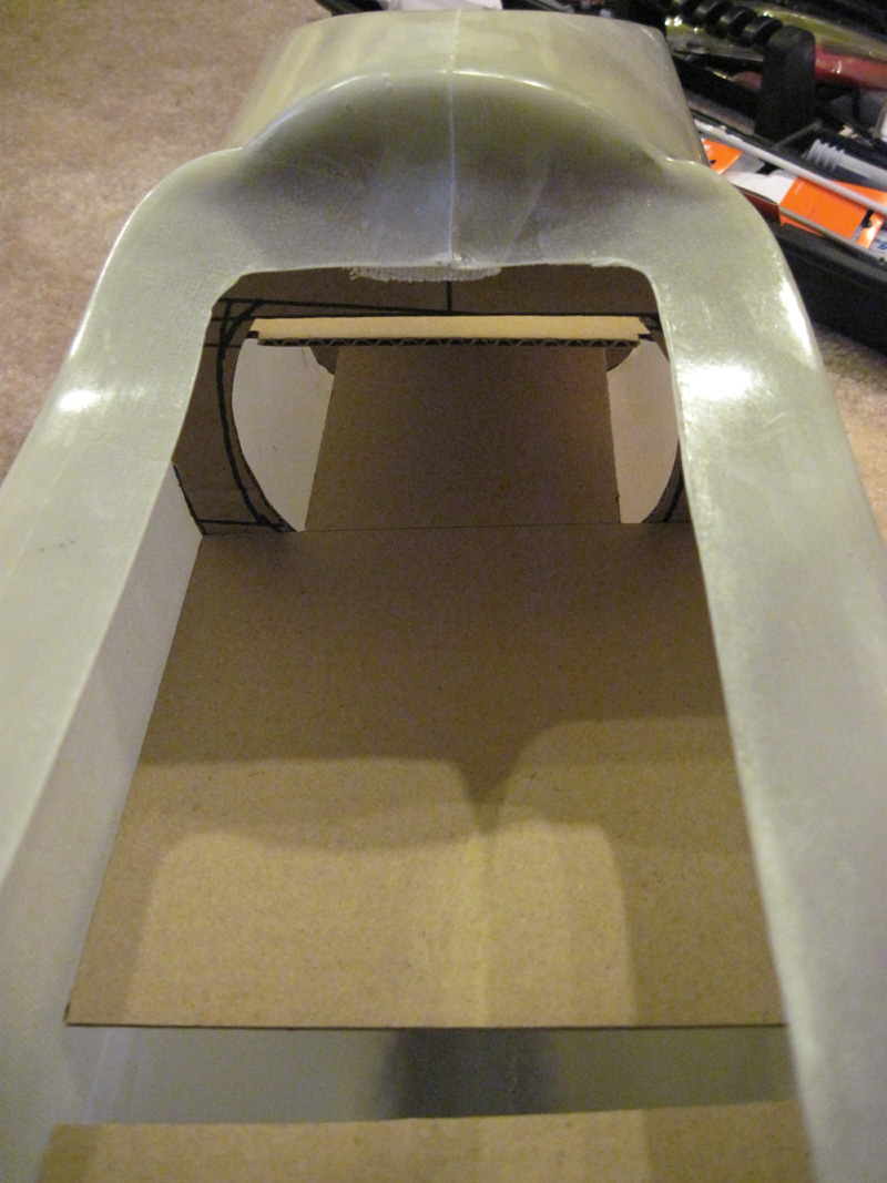

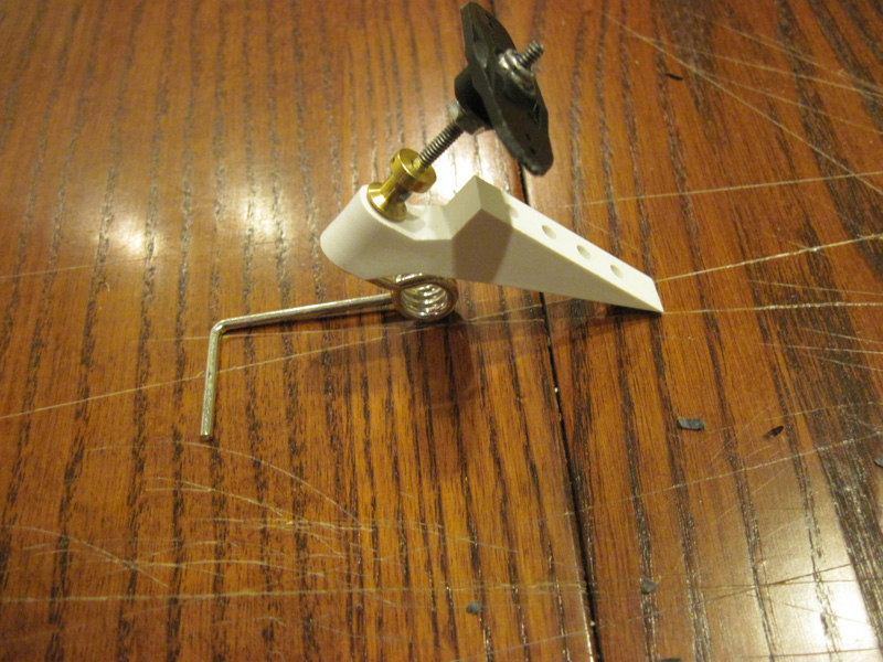

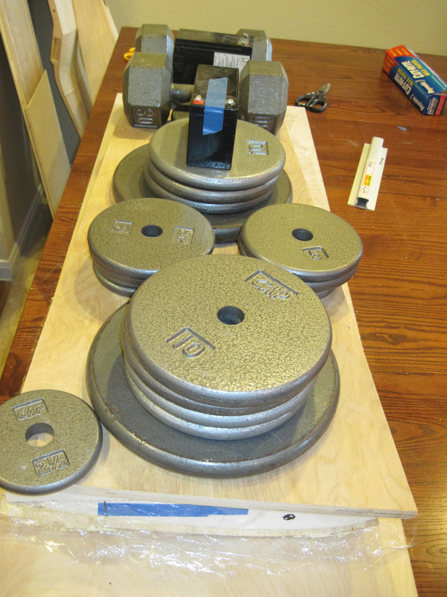

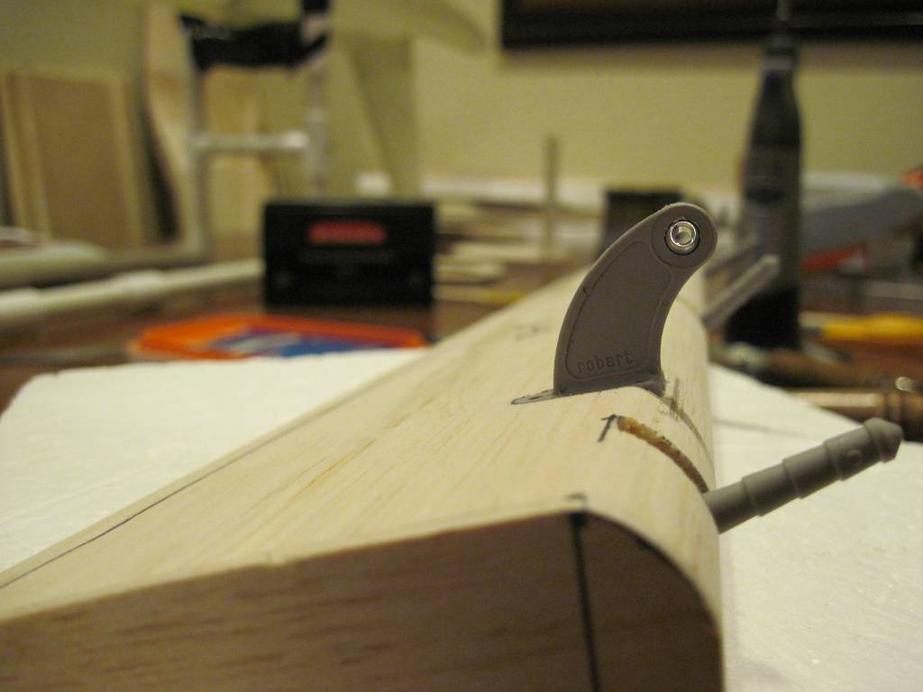

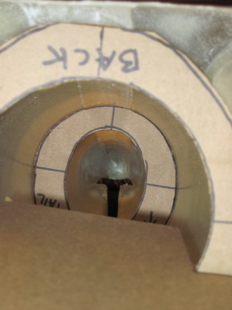

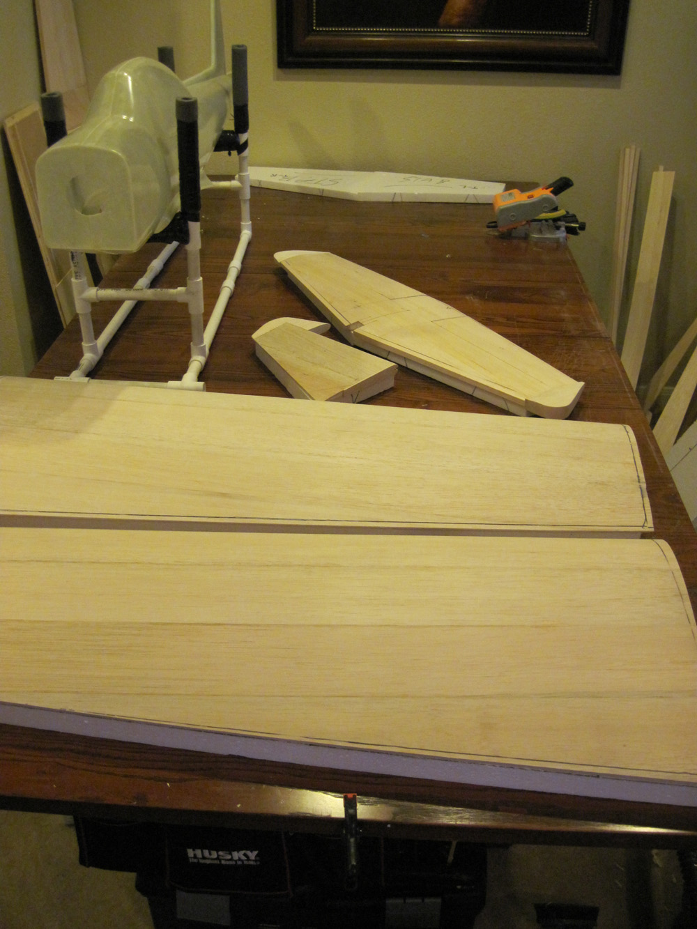

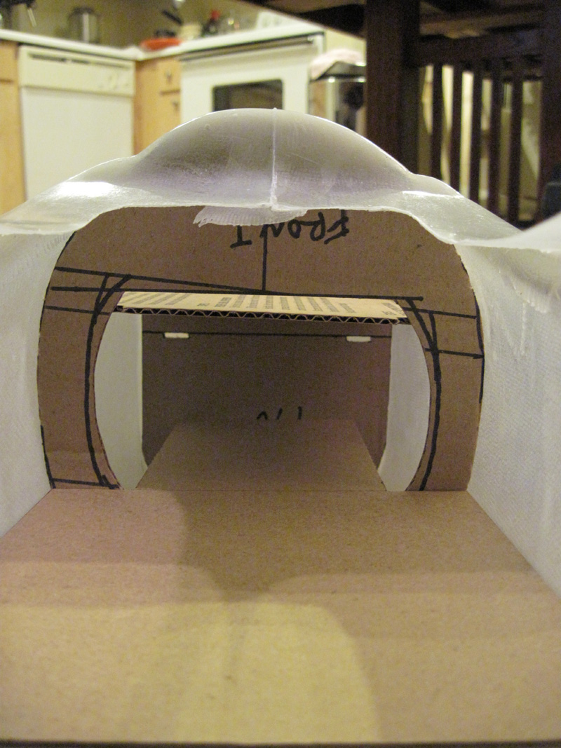

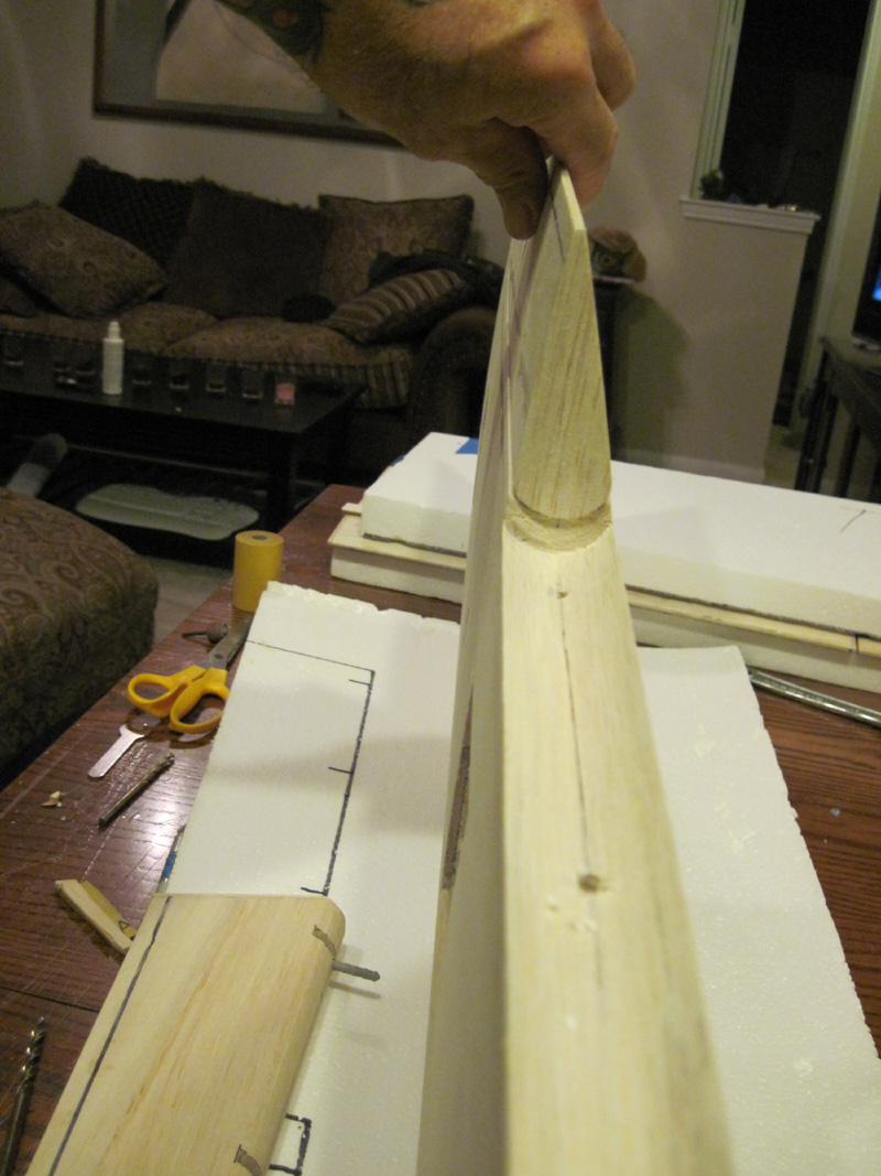

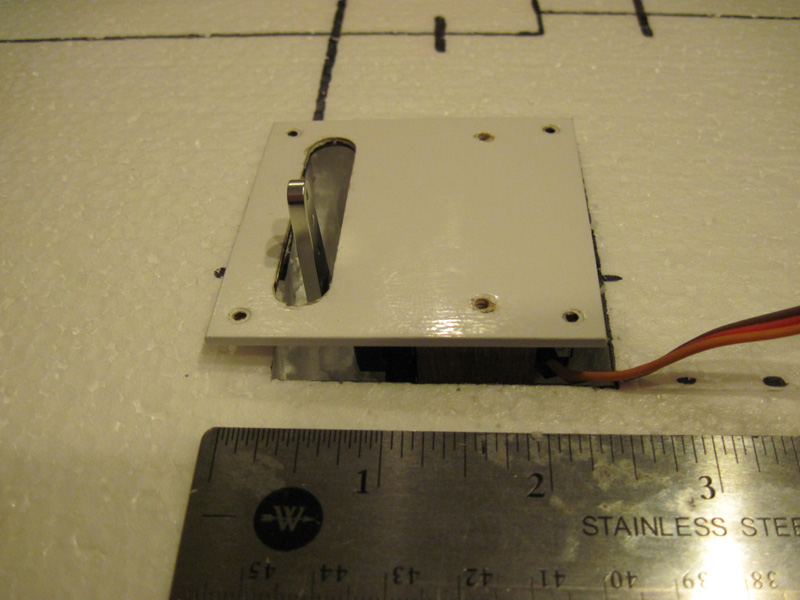

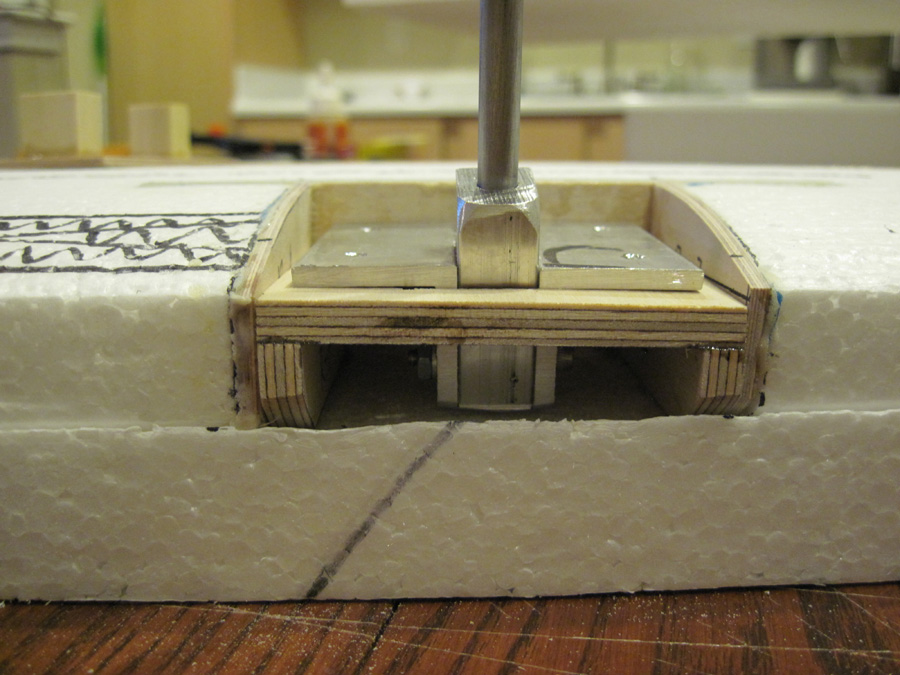

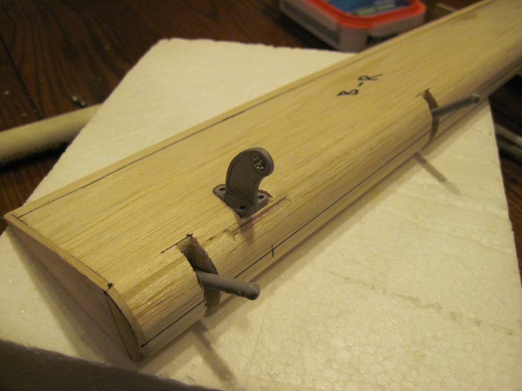

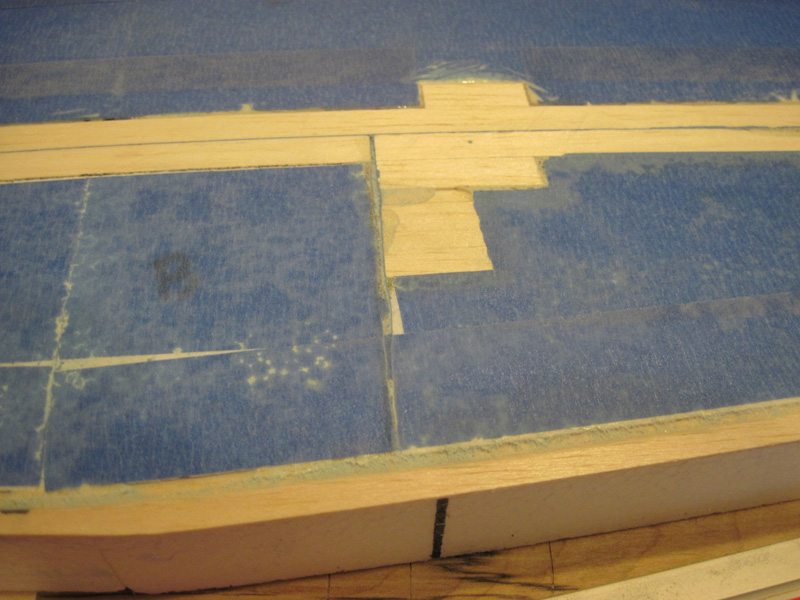

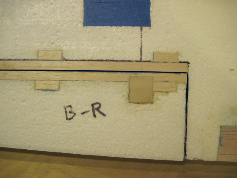

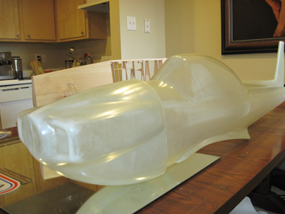

    I have been working hard on the wing and tail feathers. Funny how a foam wing take just as much time as a built up wing, well maybe not as long. This is my first so I am taking it slow.
    I started working on the fuselage making templets of the firewall and bulkheads out of cardboard. I tried fitting the DLE 55 and it is just to big. The cowl would suffer a butchering and it would not look right, it is just to big for this plane. So I will go with my first choice, the DLE 30.

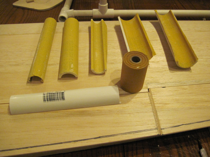

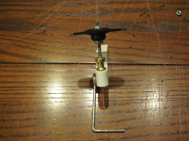

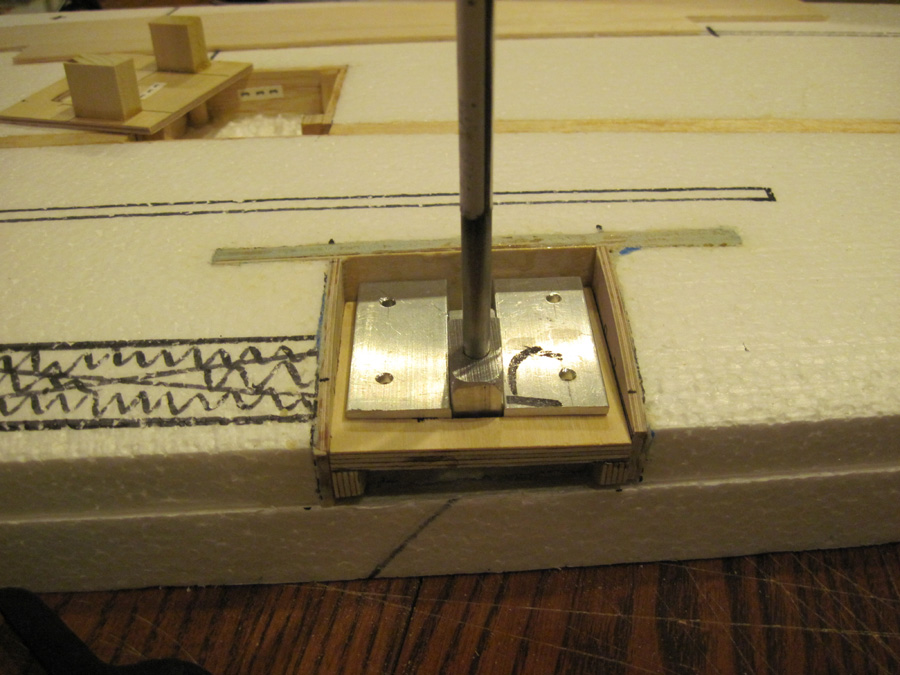

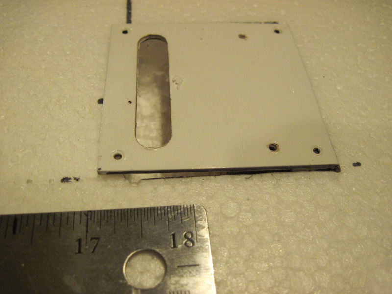

    I bent the 1/4 landing gear wire and after doing that I really wanted to find an alternative. One of my mentors suggested making a bracket for the LG. So with the help of Edwin I made a set of aluminum landing gear blocks similar to standard retracts, but fixed. They will install just like you would with a retract.
    This will be a much cleaner way to do the LG. The material cost is less then $10 and about two hours of fabricating, very simple. They weigh Only 3 oz, same as the 1/4 wire.
    I cut in a 1/4 ply bulkhead and tied in 1/8 ply for sides going from the LE to the 1/4 ply. I then made a mounting block out of 1/4 play and glued it in place. I will make a hatch out of 1/16 ply to cover the LG.
    The plans show sheathing the wing then apply the LE and Facing for the ailerons and flaps, butt glued. I will cut the ailerons and flaps and face them before sheathing so the sheathing will be on top of the 3/8 facing. The LE I will butt glue after sheathing. I will do the same with the tail feathers.
    I have been trying to weigh parts as I go, fus, wing cores and tail feather. I want to see how what I do effects weight and try and keep it down if I can. All the wood from BUSA is high quality, but heavy. One balsa stick, 3/8x1-1/2 weighed 2 oz, I picked some up from my LHS and the same stick weighed 1/4 oz, softer but for facing it will do just fine.

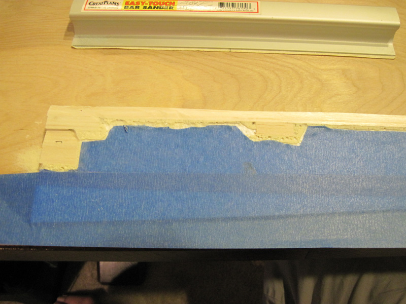

    I glued in all the facing for the elevator and rudder. I found that painters tape works great to mask off the parts I do not want sanded.
    I have been working on the wheel assembly and the toque rods for the tail feathers.
    Here are some pics of my progress.
    I am just starting to sheath the tail and working on getting the wing ready.

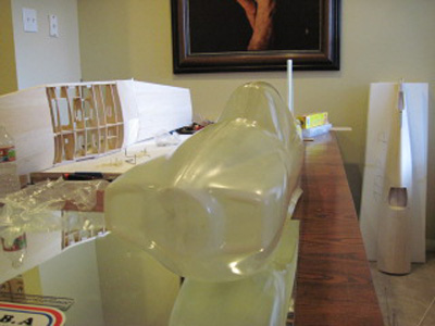

    And some more, now off to work on the ailorons and flaps!

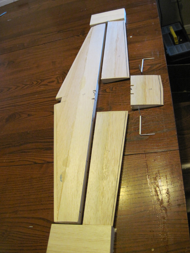

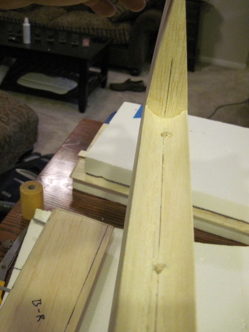

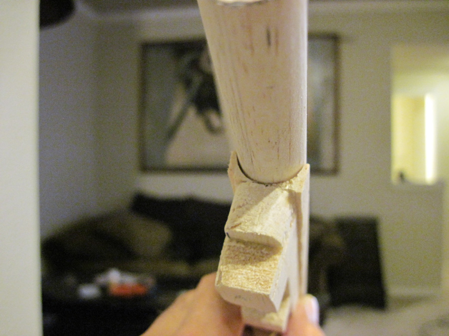

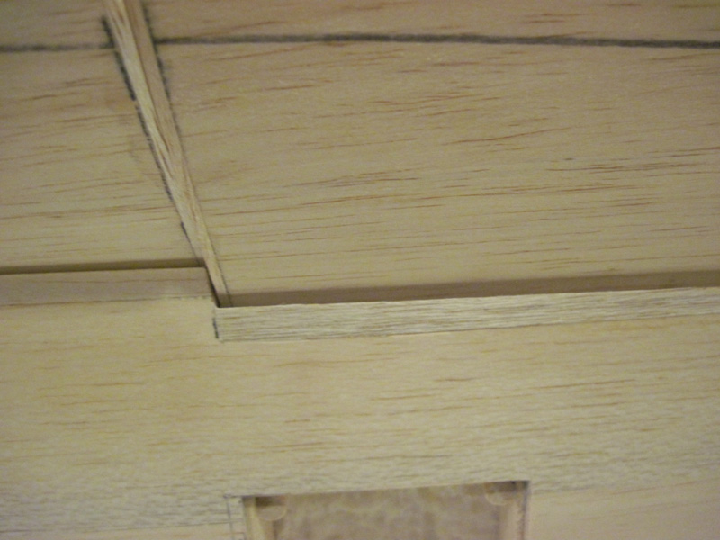

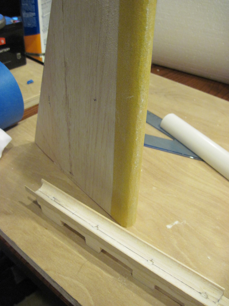

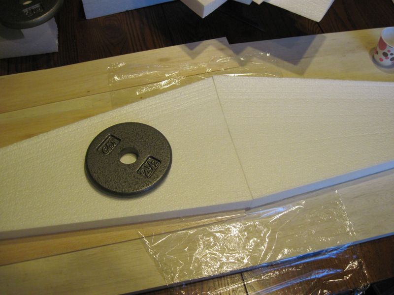

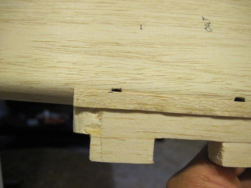

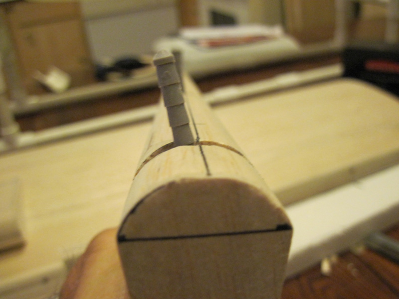

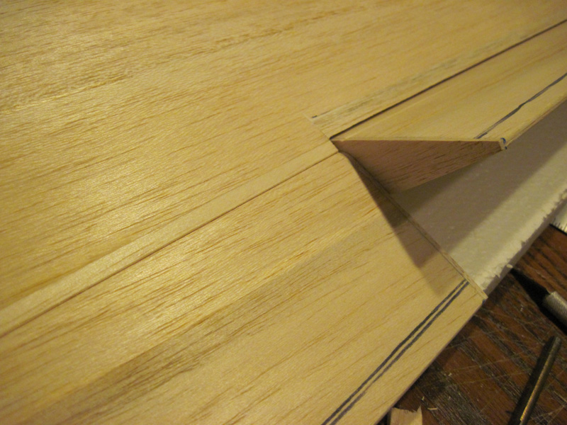

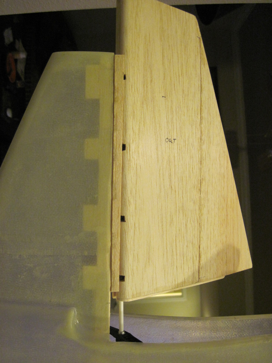

    Dragon, I am planning on doing the stars and stripes scheme, with an added airbrushing of some graphic art.

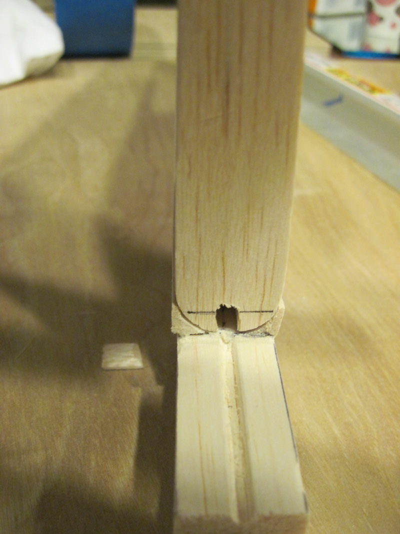

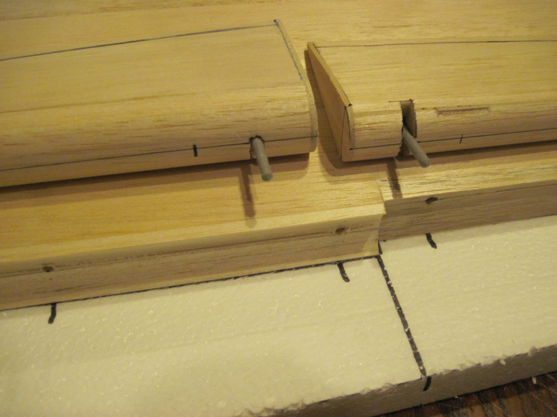

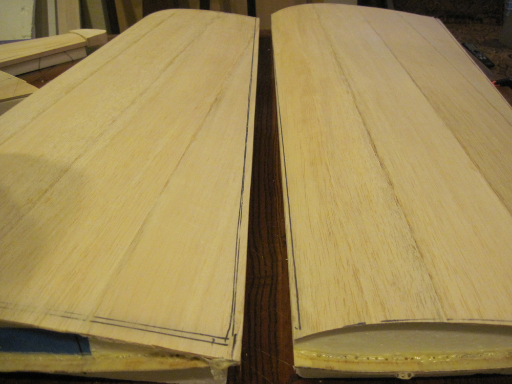

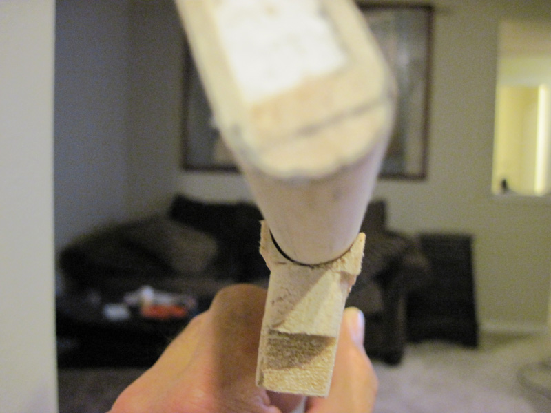

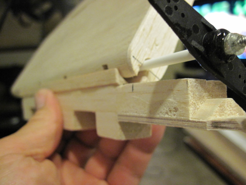

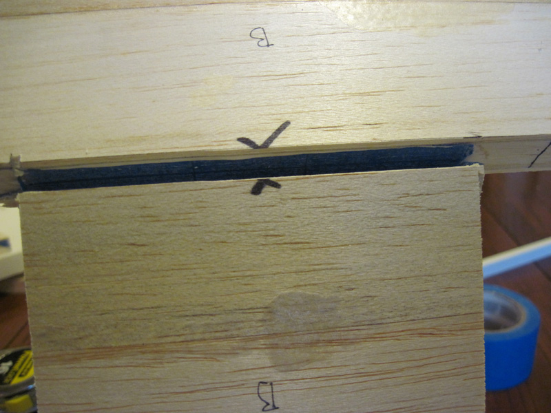

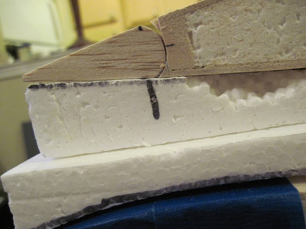

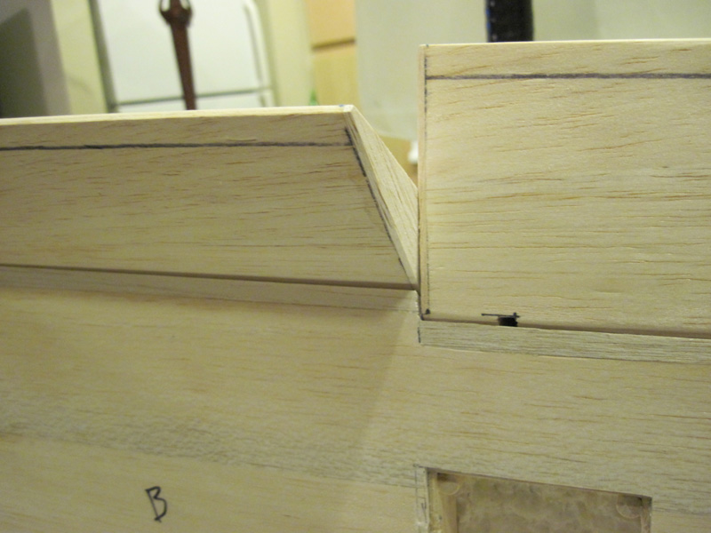

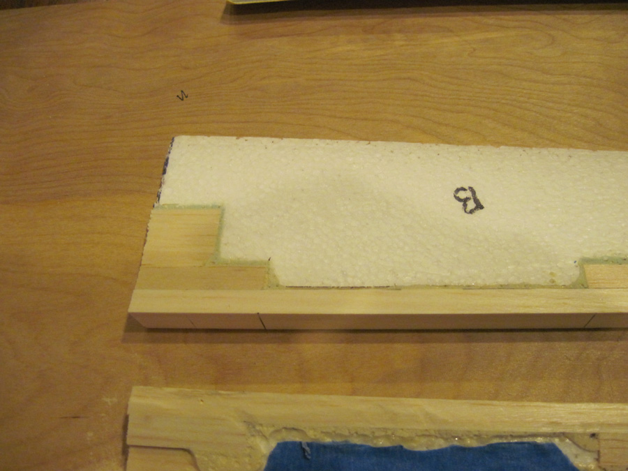

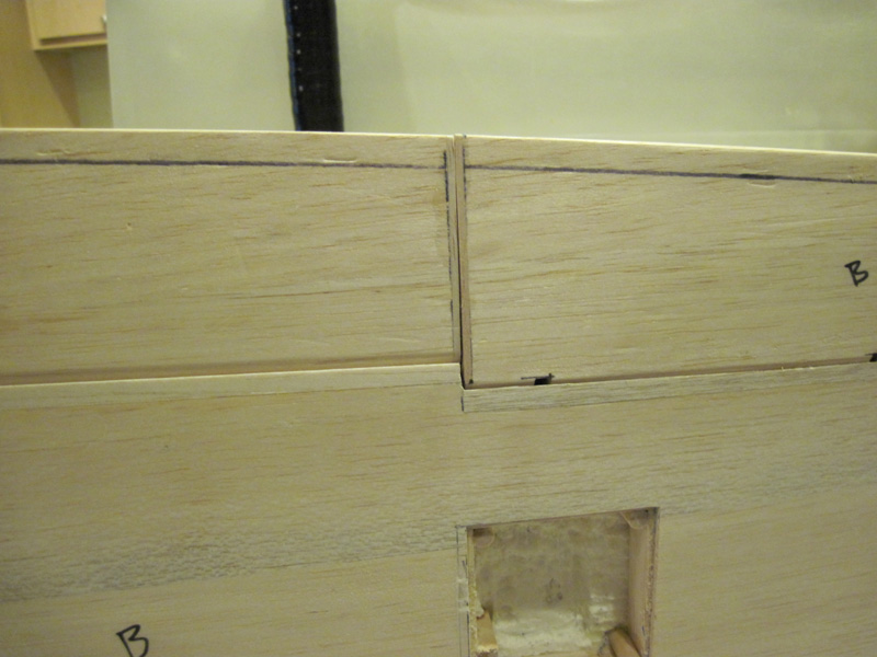

    I glued the sheathing on the rudder first to see how it all works, never done this before so I wanted to start with something I could easily replace. It turned out great!
    So on to more challenging parts, the stabilizer was next. I cut the elevators out and faced the with 3/8 balsa, installed blocks for the torque rod and hinge points. Being this was my first foam wing I have no experience. Some suggested to sheath the wing then cut the ailerons and flaps out after with a band saw, or cut them with a #11 blade.

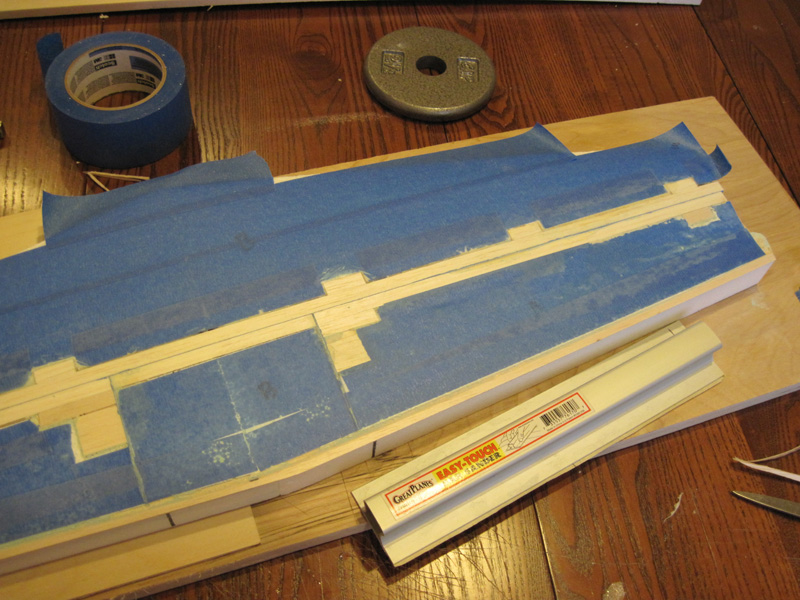

    I chose to prep the elevator and ailerons first so that the facing would be embedded, not face glued. I masked of the surfaces I did not want to get glued and placed it all in the chuck and hoped for the best.
    I glued the top first 100lb was just fine. Then I trimmed and glued the bottom on. I used gorilla glue and put wax paper between the husk and the sheathing.
    Now the moment of truth. I had marked the location to cut on the top before I glued the bottom. I cut the elevator from the center with my dewalt chop saw, and then cut the elevator free with a #11 blade. It worked great.

    Progress.
    Tail feathers.
    I went ahead and tried out the hinge line that I want to do on all the control surfaces. I used the ruder as a test and sample of the covered hinge line. I rounded the ruder by hand being it is tapered. I mark the radiuses’ top and bottom and a line down the middle and on each side to give me a reference point.
    After getting the ruder nice and rounded I glued in two triangle pieces of balsa on the receiving end of the fin. I applied some stick on 220 sand paper to the ruder and used this to shape the fin receptacle, this gives you a perfect tapered fit.
    Being the center is embedded in the radiuses you have to notch the radius for the range of motion you want. I will be adding more turning on the ruder then the recommended, like to have as much ruder as I can. All in all this worked out great and I will do the same on the rest of the hinge lines
    Attached Thumbnails Attached Thumbnails Click image for larger version.

    RE: G&L Hobbies 1/5 Super Chipmunk Build (short kit)
    Progress.
    Wing.
    I prepped the wing as I did on the stabilizer, covered all the areas that I do not want glued. The only thing I did deferent is to apply a very tittle bit of Vaseline on the facing where the ailerons meet the wing. This hopefully will make it easier to pull apart after I cut the skin.
    After gluing all the skins together and sanding the outer surface I was ready to tackle this monumental stage in this build. I figured it would take two hours per skin so I started at 3:00 with the first top skin. I placed wax paper between the husk and the skin so it would not stick together during gluing. I aligned everything prier and marked it on the husk so I would be close with the alignment. I also made temples of the top and bottom so I could lay this on top after the wing was skinned and mark the servo bays and the ailerons and flaps. I glued the top first and then the bottom. It took me until 10:00 to set the last skin. It all came out very nicely. Next I will trim and apply the LE then cut the ailerons and flaps out, keeping my fingers crossed that it goes as well as the stabilizer did.
    TB
    The DLE 55 fit but the muffler was the problem. With a wraparound Pitts muffler it would need to be cut into the cheeks of the cowl. The DLE 30 fits fine with only cooling vents cut in. I will throw a tape on the cowl next time I am working and let you know.
    I am using 1/2 robart strait struts. It will be the same set-up as retracts but fixed. The 1/4 wire should provide the give needed if i hit hard. I am working on a collapsible gear that will fold on hard landings in the rough if one had a dead stick.

    Progress.
    Hinge line wing, aileron and flaps.
    The aileron and flap cut out of the wing very nicely. I used my chop saw totrue up the ends and faced them with balsa.
    So I like to sand, it is a Zen like process. The built up hinge line changes this concept. Really glade I went with 3/32 instead of 1/16 balsa for the sheathing.
    I started by rounding off the aileron and flap. I marked the center, the radios and the outer line fir reference. I used a razor plane to get it close then I used a sanding T bar to get it close.
    I ripped down various PVC pipe in halve, 1/2, 3/4, 1, 1-1/4, and 1-1/2, and applied adhesive sand paper to theses sanding blocks. This is a good finishing touch to get a perfect radius.
    Next I glued triangular balsa to the wing hinge line. Using my dremel and a drum sander I carved it down checking it with the PVC sanding blocks. I applied sand paper to the aileron and finished sanding with the flap and aileron to get a perfect fit. It takes a lot of work to make this type of hinge line but it is well worth it. I am currently working on the elevator to complete all the control surfaces.
    I cut in all the servo bays and made the gear covers out of 1/16" ply. Started to glue in the formers and block on the fuselage. Next finish the wing, tips and cut in the spar.
    TB
    Tony,
    looks like thatthat engineis too big. You would have to cut the sides and the heads would stick out. The cowl is 7-1/2" wide and about 8" tall.
    TB
