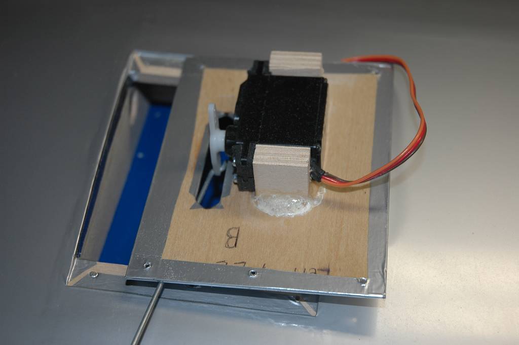

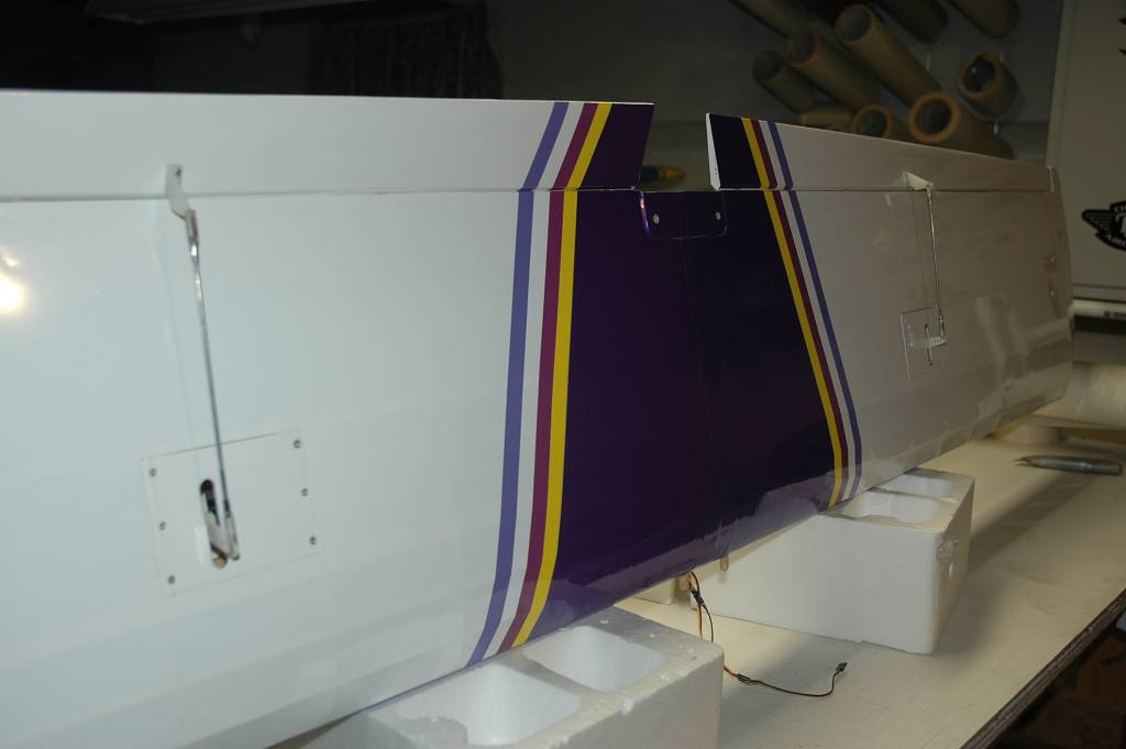

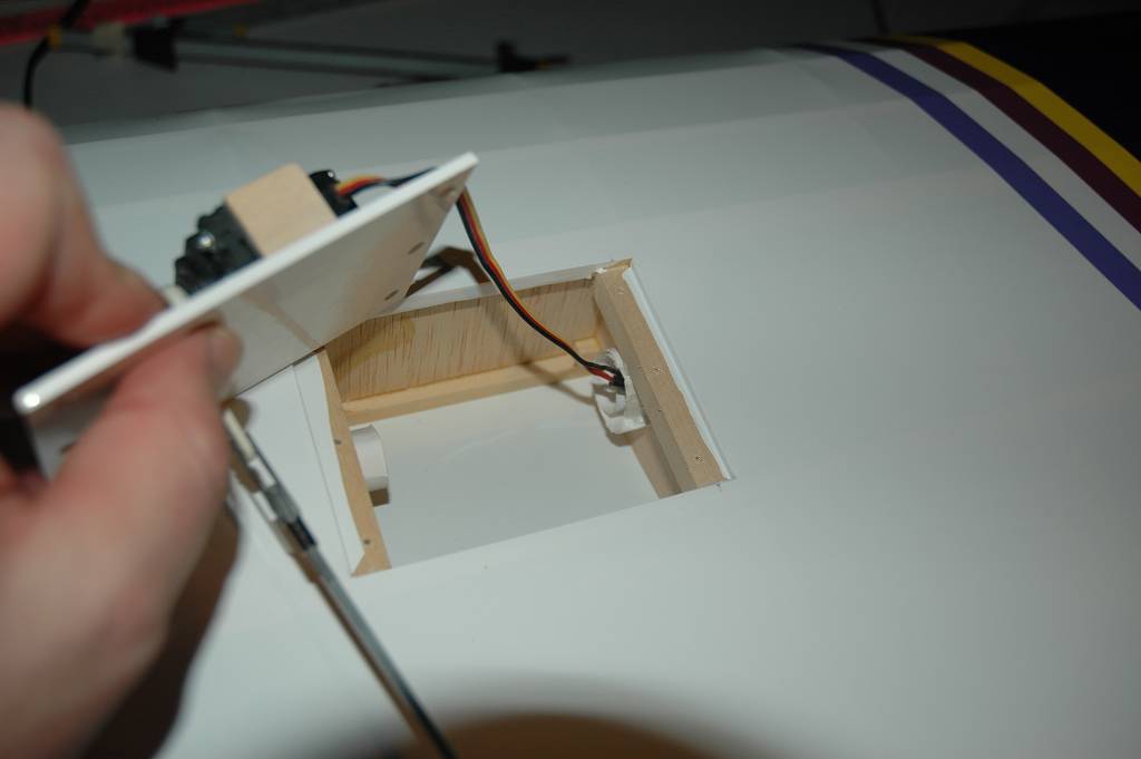

Been reading all these build threads and decided I couldn't let you have all the fun so...... I have an LT-40 sitting on the building board. I have several questions that I need everyone's advise on:
1. I would like to build this kit with dual aileron servos. How far out in the wing should they go? I would like to mount them sideways inside the wing with just the servo arm exposed through a slot. Need a lot of instruction/drawing on how to build the servo mount with recommended sizes of wood to use. Also, how much torque will these servos need for this plain......can I use some of the smaller size to cut down on weight?

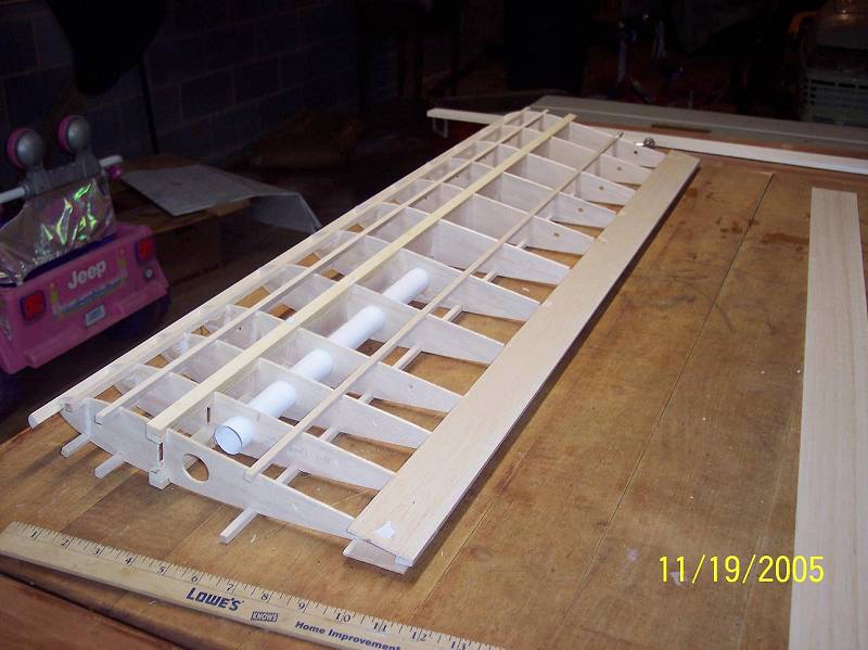

3. Back on the wings.....I have seen some of you recommend adding holes in the ribs to allow air to move to aid during covering. This kit has shear webs on the main and secondary spars...so alot of trapped air. Is it worth adding these holes, and if so, what is the best way to make them??

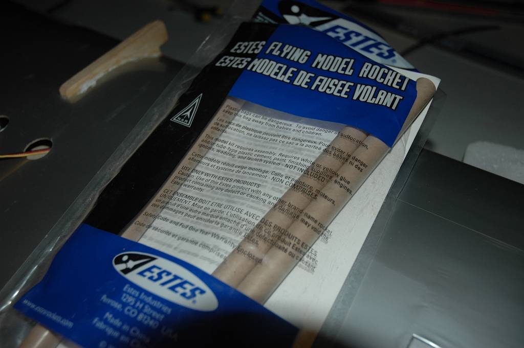

2. I love the arched composite landing gear from Dubro (see first pic below gear is on Ugly Stick). Simply use the same ply bottom the kit comes with but measure new blind nut hole locations to correspond with the Dubro gear. If you beef this area up to much you can seriously compromise the planes airframe on a hard landing. You want the ply gear plate to pop out in those situations which is easily glued back in with little effort.

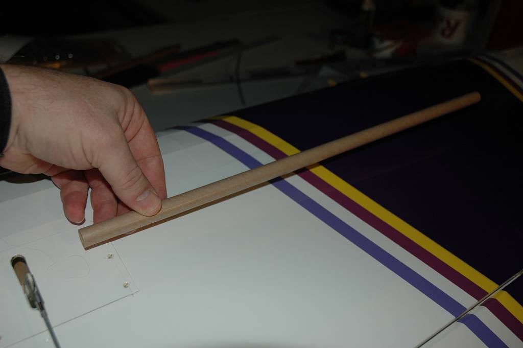

3. As far as adding holes in all your ribs goes don’t worry about it air finds its way out. However you will need to put ½” holes is the ribs out to the servo bay section for the servo leads to pass through. I roll up some computer paper into tubes and glue them into the wing to allow the leads to pass easily through each rib when the wing is covered. You can also buy 1/2" paper model rocket tubes on e-bay for this job they work great. A hole must be cut in the wing top center for (ON BOTTOM MOUNTED WINGS see pics) the leads to emerge from the wing sheeting for receiver hookup. (ON A HIGH WING THE LEAD HOLE MUST BE ON THE WING BOTTOM see pic)
4. For fire wall fuel proofing I use Rust Oleum Enamel found at Walmart in many colors it is very fuel resistant but takes a good day to dry.

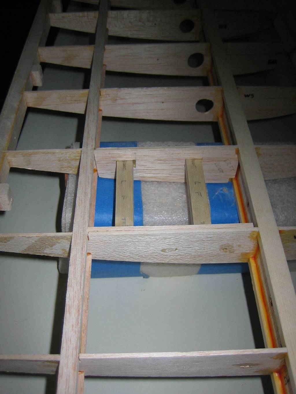

All I did was to pick the rib bay that was central to the aileron as the servo bay. This was an upgrade of a kit that was originally built with a single servo. I added two "half" ribs made from 3/32" balsa sheeting. Icreated servo mounts from a laminate of 1/8"ply (no lite ply here) and 1/4" balsa stock. The mounts are as long as needed to fit between the two ribs. Rectangular cutouts to locate the ends were cut from the rib "doublers". Some scrap balsa sticks were fit around the perimeter of the servo mount kinda like cap strips to support covering.
HTH
Oh yea - drill holes in the centers of each rib between the servo mount and the root rib for the aileron servo wire. Iused a 3/8" wood bit.
HTH
